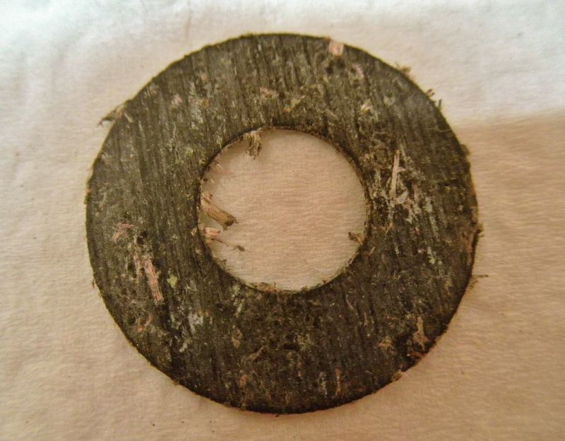

The convex tension spring is attached to the thick brass bushing.  Also, there is an ABU-style square shim (wear plate) tucked inside the cast control knob.
I have a Ryobi-made example that is the same model as yours but it too is missing the cast control knob, spacer and tension spring. I wonder if the tension spring did not provide enough tension and having the cast control knob fall off was a common problem?  If it would help, I can mic and count the male threads where the cast control knob should be.  It will be tough to find a replacement though.

I'm pretty sure the cast control knob on this one is not correct because it is flimsy plastic and threaded in the wrong place.
