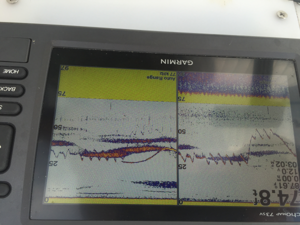

Echomap 73sv look at my jig and where I reeled up to where fish are
#16
Now that is jigging!  You don't let that sit still.
