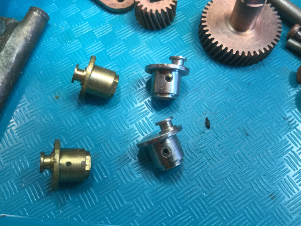

I get that Otto Henze patented the oil/grease/lubricant port(s) concept for Penn reels. But I don't get the utility of the oil port on the eccentric.... so you put oil through the port and it gets into the eccentric, then where does it go and what does it do? And how does that help anything?

There is a small hole in the side of the eccentric to lubricate the circumfrence of the eccentric. When I assemble a reel I always put a couple of drops of oil in there before installing the ecc. screw even though I greased it on installation.
Thanks, Rudy. I have 3 spare eccentrics in my parts bin - only one of the 3 has that hole. But not all Penn reels have oil ports on the eccentric, so I assume those that do not have no need for this hole. I always grease the outside circumference of the eccentric before I put it in the head plate also. It's really kind of an easy spot to get a drop of oil without the oil port.... I guess it's not the most important option on the reel.... and I guess Penn knew that because not all reels have this feature....
Sid
Rudy is right --
There is a "through hole" on the side of the eccentric -- for oil to do its work.
However, this is not always true -- since many of the Penns, particularly the average or smaller sizes -- do not have this side hole.
As a general rule, if there is an oil port in the free spool lever nut -- there will be a corresponding hole in the eccentric side.
That is providing all is original -- and has not been switched over the years.
When getting a Penn "salt ready" -- I just use a good marine lube like Yamaha liberally before inserting the eccentric and spring.  In the field -- a drop or two of oil never hurts -- but if your reel is well maintained annually -- it should not be needed.
