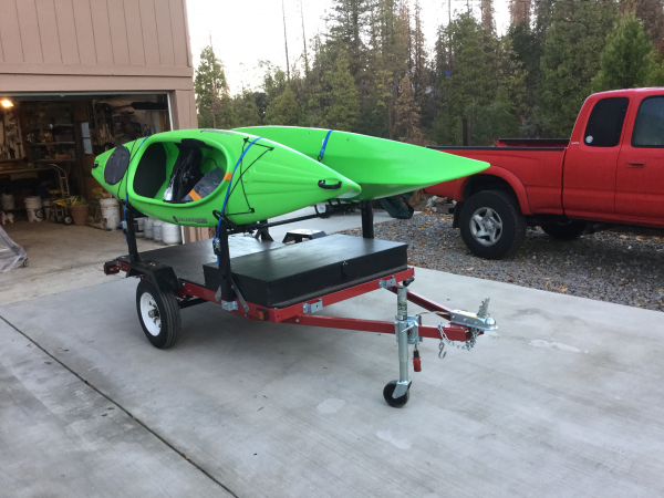

Sue and I have been trying to do a "play-day" together -- every Friday, and sometimes two days.
Kayaks seemed like a good idea for fun, excerise, and exploration.
We wanted a small trailer so that we would not have to lift a 50 pound kayak over our heads from a car rooftop.
Checking out many of the kayak specific trailers out there -- I found that they run between $1200 to $2400 -- depending of course, on how much of a Yuppie they feel they are reaching.  And most looked like some sort of a horse racing harness rig affair.
We are really not Yuppies -- but are not complete Okies either -- guess we might be called Yoakies.
So I go to Harbor Freight -- get their Heavy Duty Haul Master with a 1780 payload, 12" 5 lugs, 2" ball, weighs 360 pounds.  Assembly was easy -- took 5 hours by myself for the trailer part.
Added accessories, gear box, "J" racks, straps, tie-downs, water proofed some 3/4" ply, added a rolling wheel/jack, locking cables, etc...

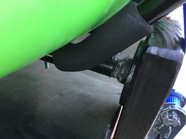

"J" racks were $34 for (2) pair -- shipped free -- from Amazon.  Very strong, plus I reinforced the attachment points.
Now we have extra room for bikes, camping gear, or whatever.
Everything came up to $503 without the aluminum box that I already had.

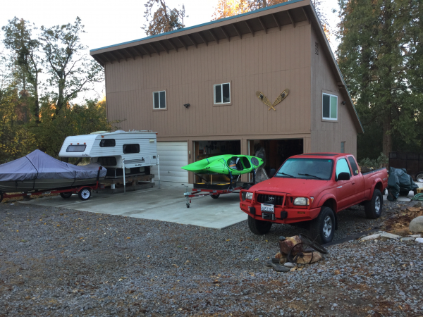

Nicest thing, we can pull it with the truck and camper for overnighters with a base camp -- or just use the Outback for a day trip.
Plus, when returning home tired after a day on the water -- just unhook and roll it inside the garage.

That's beautiful! Great job Fred.
Steve
Nice work Fred! I am feeling confident on behalf of the AT forum that we want your shop, toys included!!!
STRIPER LOU
Nicely done Fred and a heck of a savings!
..............Lou
A fine job for a yoakie.  Nice to get enjoyment out of life.  If you head to the bay area on one of your jaunts let me know.  Dominick
   Way ta go Fred...have a great time...and take a lot of pics! 8)

I use those same cheap amazon/ebay cradles on my van. They work great.
I have only minor words of warning: once the paint gets chipped, they rust something fierce. I'm on my 2nd set in 2 or 3 years now, but largely because I never take them off the van and get out into the salt from time to time. Likewise, the included hardware rusts fairly quickly, so I swapped out for stainless this go-around, seems to be holding up better. If you're not getting them salty, and you're storing them in your garage, they'll probably last a long time. Oh, the foam pads can stain the kayaks if you store them in the cradles, and the plastic can deform if you really honk the straps down and it gets hot (this tends to correct itself after a little while of not being in the cradles).
