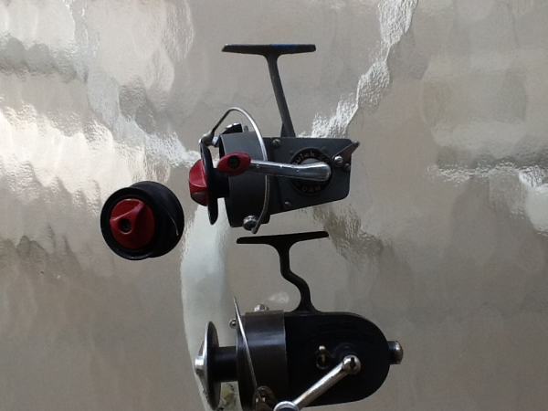

My 331 arrived and bought back some old memories of my 220 from the eighties.
First job is to wind some tape on the spool to build a convex section in the centre to counter the concave line wrap. This works.
Second job will be to hone and lap the stamped metal drag washers and replace the non metal ones with carbontex.
I have read on occasion that you can`t have a drag with an even number of non metal washers. Well DAM have, and it works.
That is all there is to do to make this a thoroughly enjoyable reel. The reel does wobble slightly when wound, but you have to accept some behaviours from a vintage reel.
I was delighted to get a Finessa with the tapered rod handle, which I think looks better than the U section chromed ones that my 2 previous DAM reels had.
Just my personal preference.
Back to the bench.
cheers
Basto
Those are just beautiful reels.
Those are tough reels, Greg --
The cranks are a little longer on these compared to the 330 -- same with the 220 and 221.
And DAM used the nicer aluminum tapered cranks.

Hi Fred
Yes it is a good one. I was lucky. Just realised you can`t see the handle in the pic I posted. I changed it to the other side of the reel. I feel a bit kaky handed winding with my left hand.
All my spinners are right hand wind.

One thing that can be done with this reel -- that few people know about -- is to get a metal spool from an older 280 or 285 Finessa in place of the plastic one -- it is a straight across snap-on switch over.
May not be needed, depending on your application --
