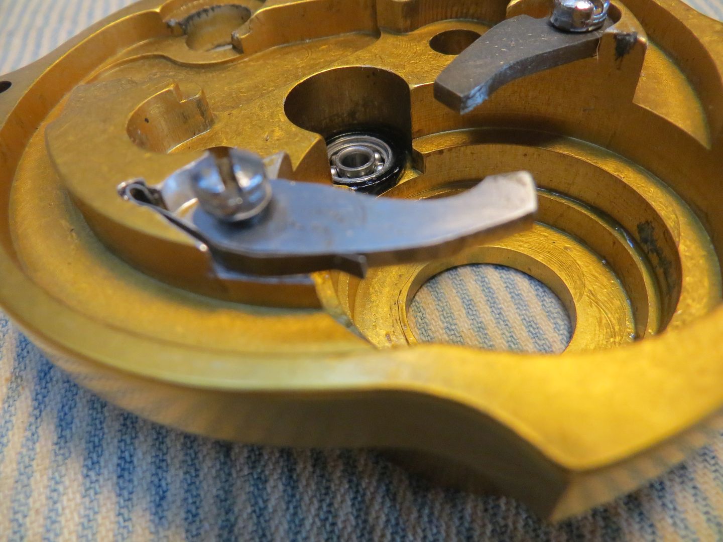

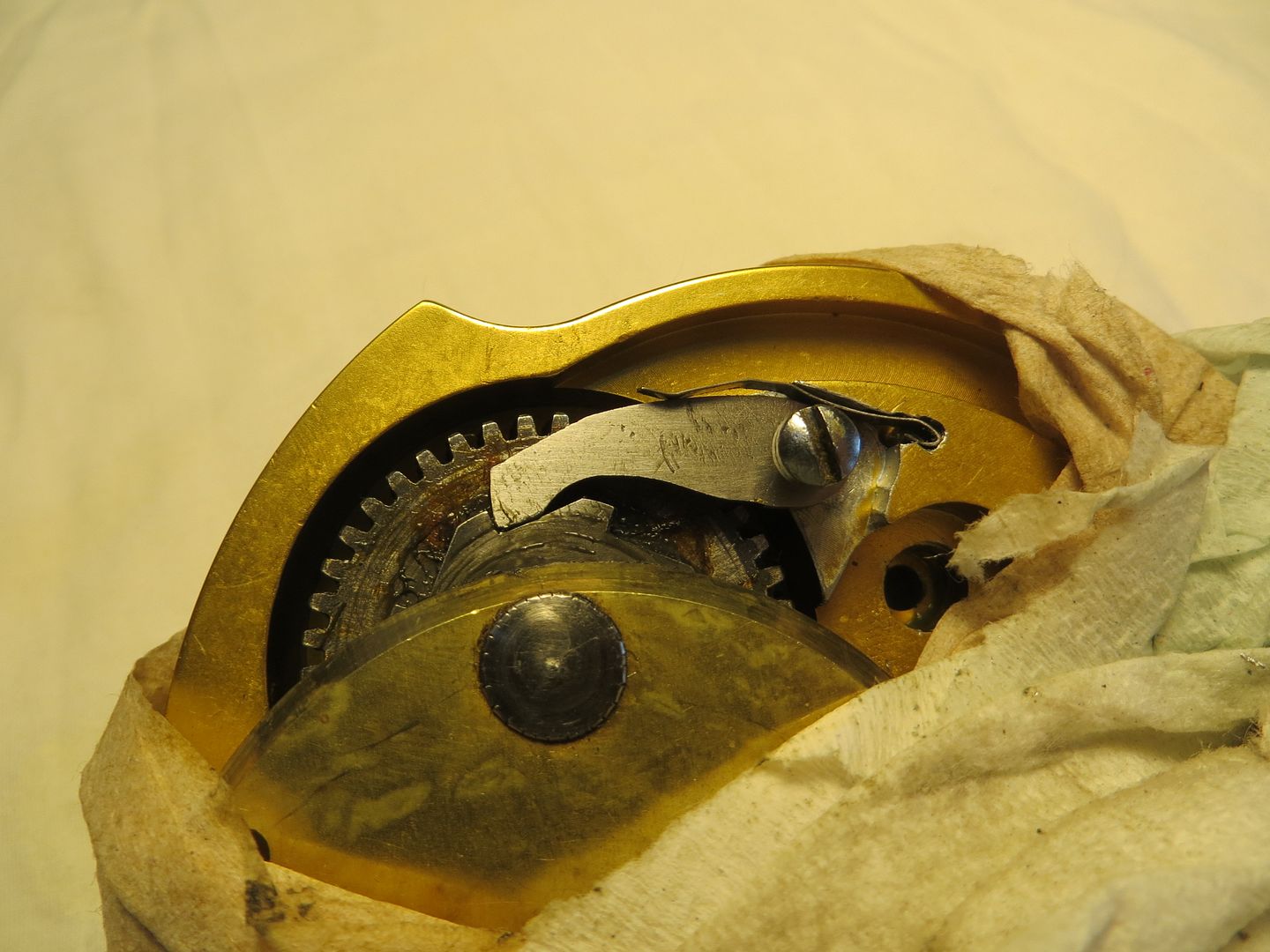

Hey guys,  save my lazy self some research today and tell me if the ProGear 255  eccentric jack is a special part?
Turns out mine is bent up and a little fussy going in and out of gear.  I tried flattening it with a plastic mallet but it still seems stubborn.
It doesn't look like the jigmaster eccentric so I was wondering if I could just swap the components?  The original has the left leg of the jack cut at an angle across the bottom.
EDIT:  Nevermind, I dug thru my stash and came up with a brass 11-200 and that seemed to work.  I also changed to a steel main gear and pinion from a Penn JM.  So even though I'm a bit disappointed that I had to swap to brass, I now have a steel drive gear set.
