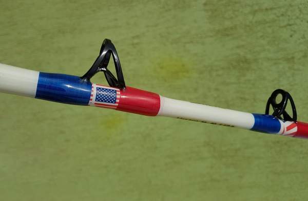

so, oddly some american friends that live here asked me to rebuild their fishing rods with Mexican flag colors, now one asked me if I can make something similar but with the USA flag colors, dang !! USA colors are easy to work on a rod but it simple colors can be seem as French flag colors, so it has to have some stars and bars, Im not into weave wraping desings to make the stars and bars but remember a trick from another rod builder on BD with some stickers that you can find on any craft store, so, based on his work I made my own version, it was an old Sabre stroker 80lb rod.
love the finished product, tons of pics to check many angles and colors with different backgrouds.

Muy guapa primo! Nice, clean lines. I really like the applique work you did with the stickers for the underwraps. Did you do a layer of white thread first?
-Mike

Quote from: Fishy247 on March 09, 2018, 05:40:46 PM
-Mike
do you mean a layer of white thread as underwraps?
no, what I did is to put a underwrap of the same thread color of the overwrap, after the 1 part of the underwrap blue color I put the sticker section that is visible under the guide, then continue with the underwrap with same red color I would use for overwrap, no white thread on the underwrap if you see something like that might be the effect of the epoxic, the only white thread I used was on the decorative wrap after the foregrip
