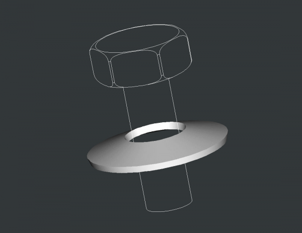

You might need a new Belleville on top of the stack. Its cone shape should be facing down, with the Cover on top and then the tension spring and star.

I have been removing just the main gear to get the washers out and as far as the grease I barely put any on them more of a film. The Belleville is at the top with the cone part facing down. The tension spring is the one that fits in the groove on the drag star correct. Could it be worn out to the point of causing my issue.
Flip the last washer (Belleville)and you should get close to 40 lb with the star buttoned all the way.

I just went and flipped the Belleville washer (cone down) and it did help a little but I'm still only getting about 26lbs of drag now. Also the drag star is not bottoming out on the side plate but I did notice the tension spring is smashed down all the way to where he star is flat on the cover that goes over the drag washers. Not sure if it's supposed to be when it's tightened all the way up or not.

No, the cone shape should always be facing up. Sorry, I thought you had it in the other way.

Ok just to clarify is this cone down or cone up. The threads look good and the drag star is definitely tightening down. It's gonna be a few days before I can work on ge reel but I appreciate y'all help and I'll let you know what I figure out next.
#27
In my eyes, that is cone down.

That washer just got set there when I took it apart. It has been in the right place. And to clarify you stated the cone should be down and Sal I believe said it should be facing up so which way is it. With it down like you stated I got more drag than with it facing up. As far as the drag threads if they were wore down wouldn't the drag star slip instead of getting tight.
