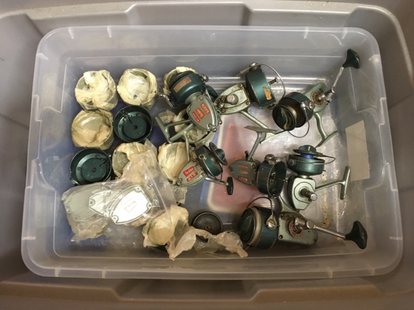

Pretty decent old reels.
Here is a box of a few Heddons, plus some NOS rotors and sideplates.
Likely have another 7 or 8 stashed in crates out in storage.

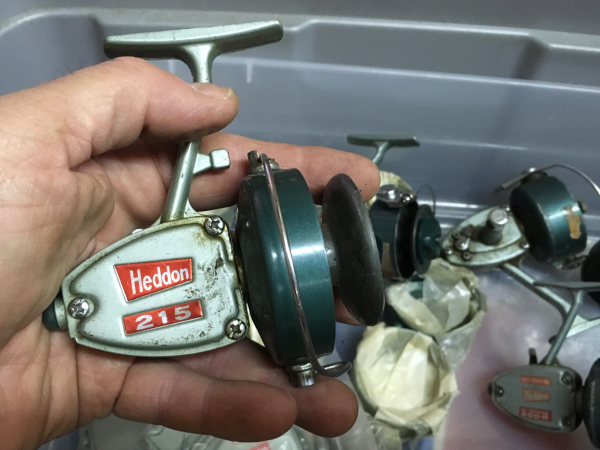

Is this little 215 the smallest?  Or is there a smaller one?
If I could make sense of the numbering system for these — it might offer some clues.  Will check the old shop manuals to see if there are any on these Heddons.

That Heddon 215 appears to be similar in size to the 236 Sheridan sent me. Not quite ultrallight but on the light side.

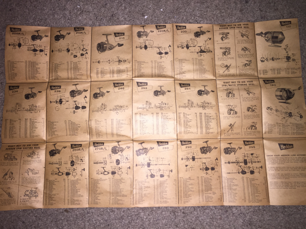

I have a nib Heddon with the catalog. It has all the spinners they made that year with a schematic for each. Unfortunately it's on one giant sheet and each one is very small. If someone needs the schematic for one model pm me and I send a photo of it

No it has a 270 then 280. The largest one is a 295.  Everything is  printed very small so it's hard to read, there's a list of spare spools for sale that come prefilled with line so I could get a pretty good idea of relative size by the numbers. The 234 has the least line capacity of 2lb at 200 yds. The smallest number is a 205 that holds 250yds of 6lb. The numbers aren't really sequencial to the size of the reel at least judging by capacity.
It lists 15 different model spinners, plus closed faced,fly, and baitcasting reels. 1 insert to cover all their reels, sure save a bunch on printing costs!
   Cool schematic folder Sheridan! Who says Heddon wasn't an innovator? The whole round world uses micro print now...they led the way! I notice a wide variety of drag stacks, some multi disc, some single. Can't get a good enough look at the gears to really tell, but appears to be Mitchell styling there. I love learning about these overlooked reels. Little kids on Facebook know how to rebuild a Penn Spinfisher. This uncharted territory is very interesting. 8)
