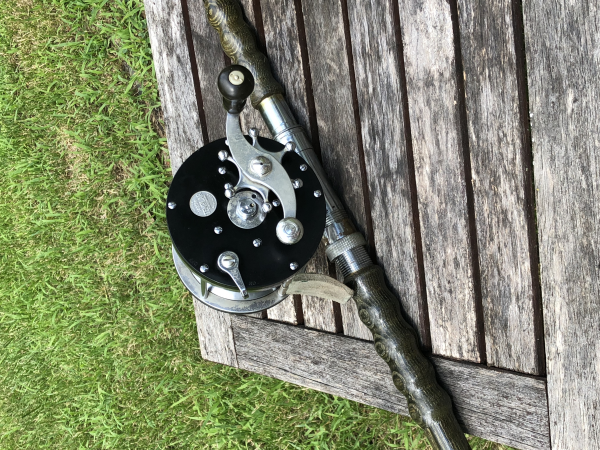

I finally have the chance to get back to the Florida Panhandle for a lot of fishing. I love using the vintage reels and bamboo rods. One thing I hope to do is catch a shark with a Pflueger Templar. I selected one from my collection that is in good working order and came equipped with a factory power handle. This reel came with leather drag washers and while they seemed to work well, I went ahead and replaced them with NOS fiber washers that were included in the box. After a complete tear down, clean and grease, I used Cal's on the fiber washers before installing. This set up gave me a significant increase in the drag pressure. The Templar came equipped with a leather thumb drag to use in conjunction with the star drag. This sits atop a vintage H/I Blue Water split bamboo boat rod. The rod had two broken guides that needed replacing.  When testing guide placement under load, I decided to add an additional guide to keep the line well above the rod. This rod is labeled "Impregnated Tonkin Cane" like the famous Orvis fly rods. I'm going to be targeting 3'-5' sharks in the surf. I'll probably make a video for my YouTube channel showing the action. Below is a pic of this rig. Other vintage gear will include the Penn 16/0 reel and rod I caught a 14' Tiger Shark on last year as well as a Pflueger Capital 1885 surf reel. More to follow...
I love the way the grips are integrated with that rod, beautiful workmanship!........................Joe

Joe, it does look nice. However, when a wooden forgrip gets wet it becomes impossible to control the rod. I am going to wind the grip with grip tape and that should help. Once I get down there I'll post some more pics. Shark Hunter I will give you a full report on conditions in case you're coming down soon.
Mike: If you can find some shrink wrap to match the contour of the grip and cooler as close as possible it would be great. If not then find a cooler that sets off the rod and makes it pop.

Nice rig Mike.  I think the Templars look better (love the star) and are made a little better than Penns..... if it were not for that cursed clutch spring.  I would have had to throw mine away were it not for help from Chad (cbar45) in this thread:

Mike, does the 1420-1/2 have the same drag washer layout as the 1419-3/4, one on each side of the main gear? Lookin' good, good luck fishing!
The Great Maudu
Sid, it has the same arrangement. I would like to try a set of carbon fiber washers. Know where I might find some?
