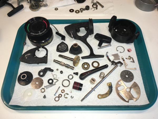

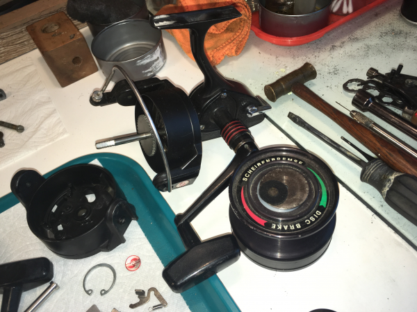

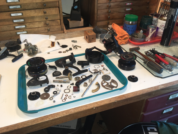

Complete disassemble, cleaning, service and Salt ready on a pair of DQ 5001's coming off the bench.
According to some experts, this is the best large DQ Spinner — ever...
I agree.

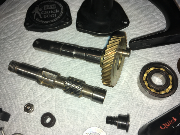

The materials and simple but clever engineering on these, is in a class of its own.
After this reel, the next DQ reels used plastic spools and other inferior parts to save $$$.

They are not mine, Alex —
I am servicing and restoring them for the guy who owns them.

I can't believe how heavy that reel is,
What is the purpose of the washer under the spool, does it provide additional drag too?

Yes, with the oversize drags on top and under the spool, the resistance is both inline and also evenly applied pressure.  This reel puts out 40 pounds of drag, stock.

Alan H. stated a couple of things about the previous models that were not accurate — but that makes no difference in how robust and absolutely bulletproof these '01's are.
Grab a cup of coffee, and read completely Alan H's review.  It is impressive and sad at the same time.
Sad in the fact that this style of quality is not offered anymore.  Impressive in the crucially over-engineered and tough details that make this reel so capable.

If you are going to fish the reel, which I highly encourage — I would find one that I liked, completely go through it to make it Salt Ready and capable — then buy an extra for parts.
I do not have parts for these — but since they are so strong — they seldom fail, except when abused or accidentally damaged — maybe just a bail spring, that is about it generally.
