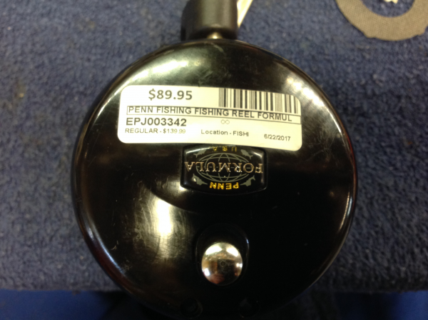

« Reply #13 on: November 18, 2017, 03:36:59 PM »
Here is a `Penn Formula almost new.
Keith
