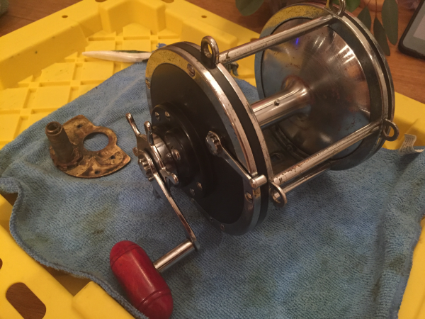

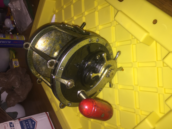

I picked up an older 12/0, handle seemed pretty wobbly so tore it down & am now debating wether or not it's worth making it right or just sell to someone w some spare parts laying around?
Biggest issues- the pinion gear is stuck to the spool shaft, haven't tried too hard to separate yet.
The 'post' that the main gear sleeve slides over isn't attached securely to the bridge plate which is why the handle is wobbly.
Non-handle side bearing is also stuck to the shaft, again haven't tried too hard to separate.
PiƱon gears show decent amount of wear.
Would also replace both bearings while in there but not sure how available these are, this reel doesn't have the screw down bearing cover/spool tension thing on the clicker side.
Any good ways (& not too much $$$) to fix these?

It's apart, had to unscrew the 4 bridge screws to get the spool off.

 A long soak in acetone/tranny fluid mix freed up the gear and bearing too.
New bridge and drag stack from Mystic arrived this week got it all back together seems to spin pretty good got to put a load on it next.
This reel was about as crusty as they get Lime Away cleaned it up nicely.
