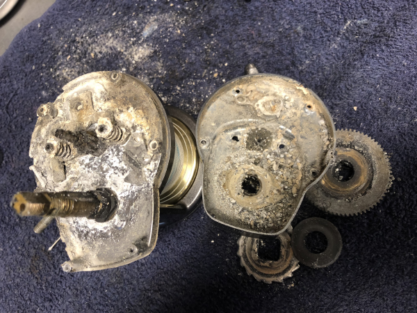

How these reels get this way I dont know. Almost all of them corrode inside but this one takes the cake. It did clean up and with a couple of new parts its back in action.

I see this sort of thing on quite a few Toriums and Tekotas that come into the shop. The problem, of course, would be eliminated if there had been a thin film of grease on all internal parts -- including the internal end cap and frame. It can easily become a long term problem because the reel is made of cast (not machined) aluminum and is not anodized.

Holy mackeral, that looks hopeless! You must be a miracle worker.  ;D
I hope you sent the customer a photo and charged him double.  Dominick
Did it look bad on the outside too? Any clue that it was that bad inside?
Hmmm, glad I donated mine. Are there any other knowen reels with cast aluminium, that can end up like that?
All brands have some cast aluminum reels. If they aren't 100% waterproof then they can wind up like that if they are cast or forged.  Neglect will do it every time.       Rudy
That looks like it had a dunking or two and several years of saltwater use without any servicing.  I've got several tekotas.  None will ever look like that.

If you give them the Tani treatment they last fine, all they need is a decent coating of grease on all the surfaces. Mine are still perfect and they have done a lot of swimming. I dunk mine in a bucket of weak soapie water if they get soaked in the salt. With the reel in the picture it clearly was soaked and left as is.
This was the worst ive ever seen and I've seen hundreds of these reels. They are very popular.
I have a bunch of pictures similar to this one but not as bad. If you dont pre service these reels they will corrode.
A good cleaning and a run through the Ultrasonic Cleaner got 99% of the corrosion removed. The frame was sprayed with TSI 301 and scrubbed in with a greasy toothbrush. No worries of corrosion again. The bearings were still good sans the bearing under the drag star. They always rust. I replace them with a rubber sealed bearing packed with grease.

Quote from: akfish on November 12, 2018, 08:17:34 PMIt can easily become a long term problem because the reel is made of cast (not machined) aluminum and is not anodized.
Wow, these reels are not anodized? Wouldn't matter if it was forged or machined; no anodizing = trouble.
Ok,
So, I have read people praise forged frames over cast for years. I'm not certain how a cast frame corrodes more than a forged frame? I'm not doubting its the case, I just don't understand it.
