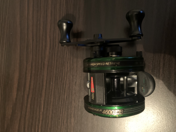

I have seen a few ABU frames like his.
Sometimes they are even violently skewed from their original square alignment.
This happens when they are subject to severe stresses like "I think I just backed over something"?
Someone with a lot of time, the right tools and true dedication might be able to restore a loose or warped frame but as you have found, it's just much easier to replace it.
I would try something like silver soldering to restore rigidity but I do not possess the machine skills that others here might.
The following pics may provide some insight on how to approach this.
If you can find them I'd replace the frames, if not you have parts reels.
