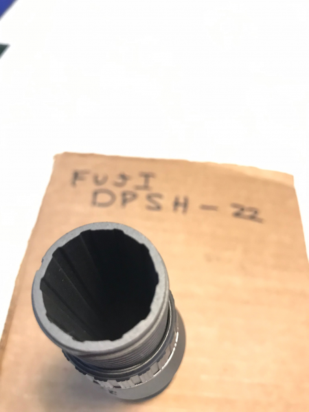

« Reply #9 on: February 07, 2019, 02:34:03 PM »
Here you go compadre.
