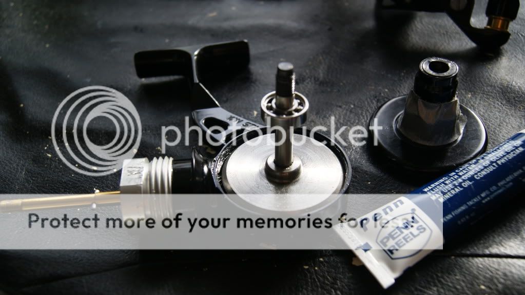

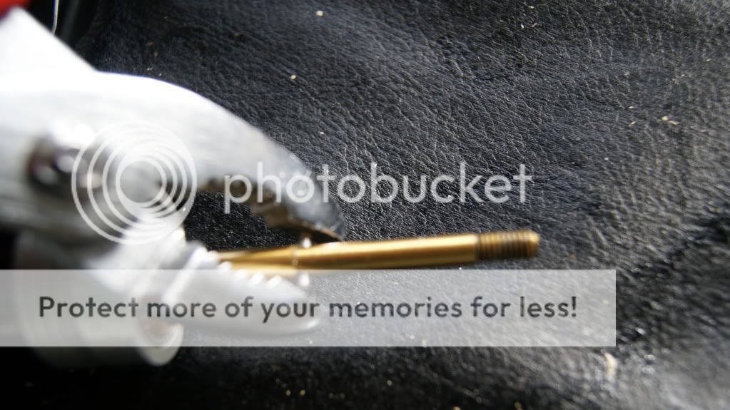

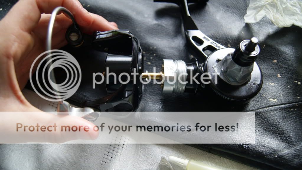

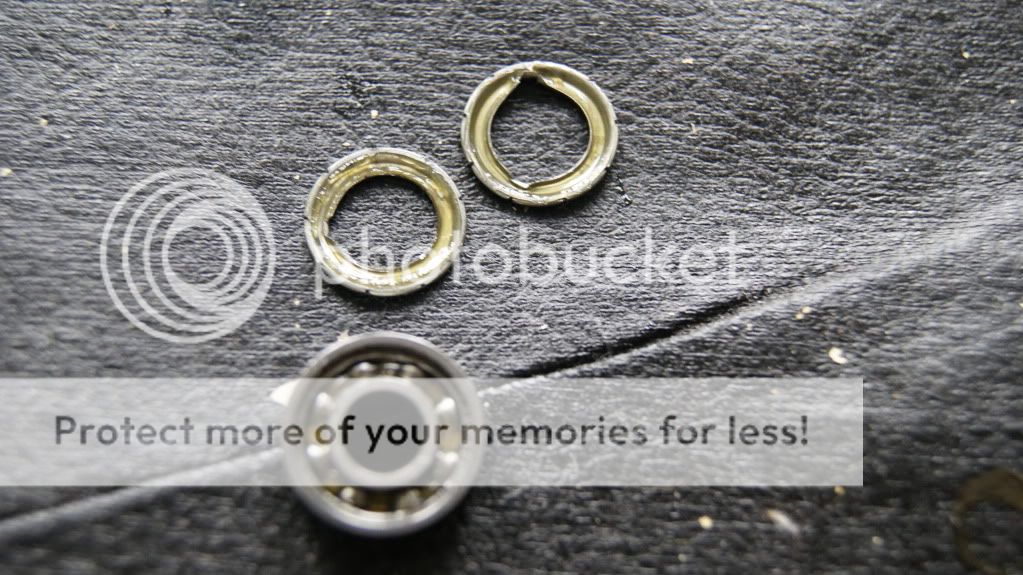

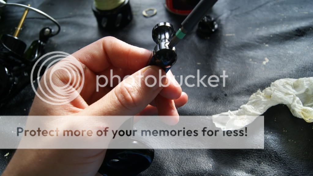

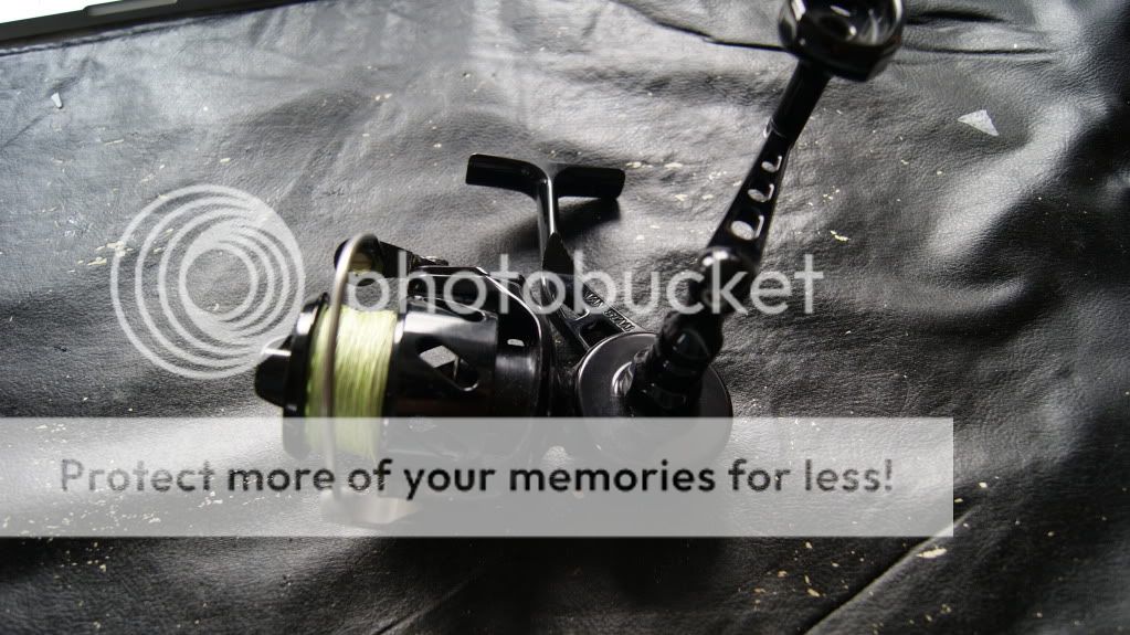

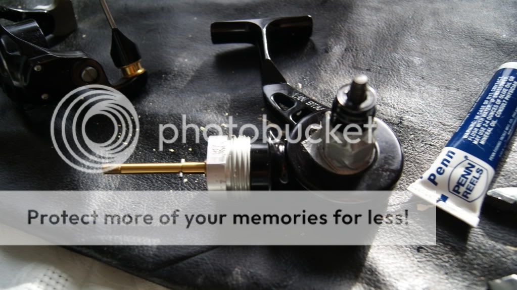

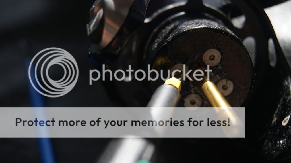

So I know there are a lot of guys out there that uses the van staal reels, and that includes me. the VS vsb100 is a spinning reel with the size equal to a daiwa 4000 size reel. I first heard of van staal for some year ago while the local tackle shop is has the agentur for the product here in Norway. The van staals have a retro look and are pretty tough when it comes to handle cranking. The reason was (was told in a tackle shop in Florida) that they use the same grease that tanks have LOL! The reel is often used while submerged in water. The reels is probably the easiest I have taken apart before, and became much smoother after the regreasing.
here it goes.
the reel weighs in just under 17oz
off goes the drag screw and the spool.

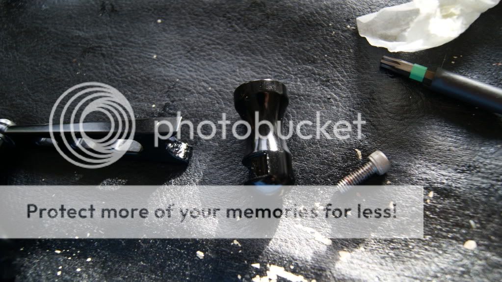

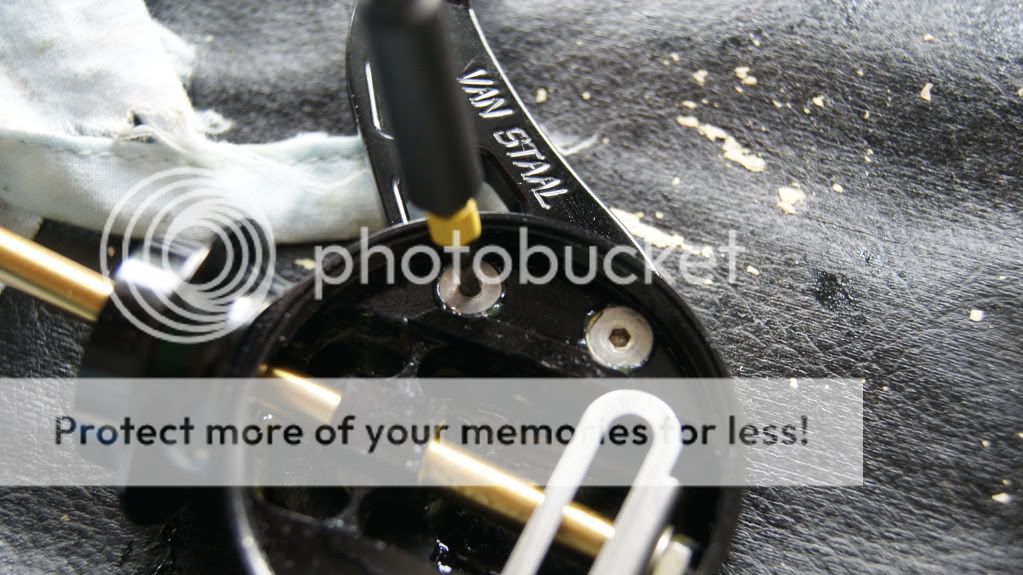

off goes the handle

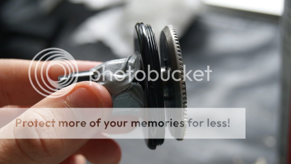

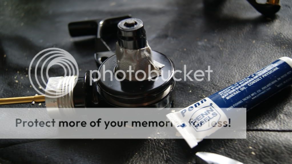

van staal deliveres a self service kit and there is a tool that is used for opening the left side frame (hard plastic) I didn't have that so I taped the area I was using the wrench. this prevents scratches.

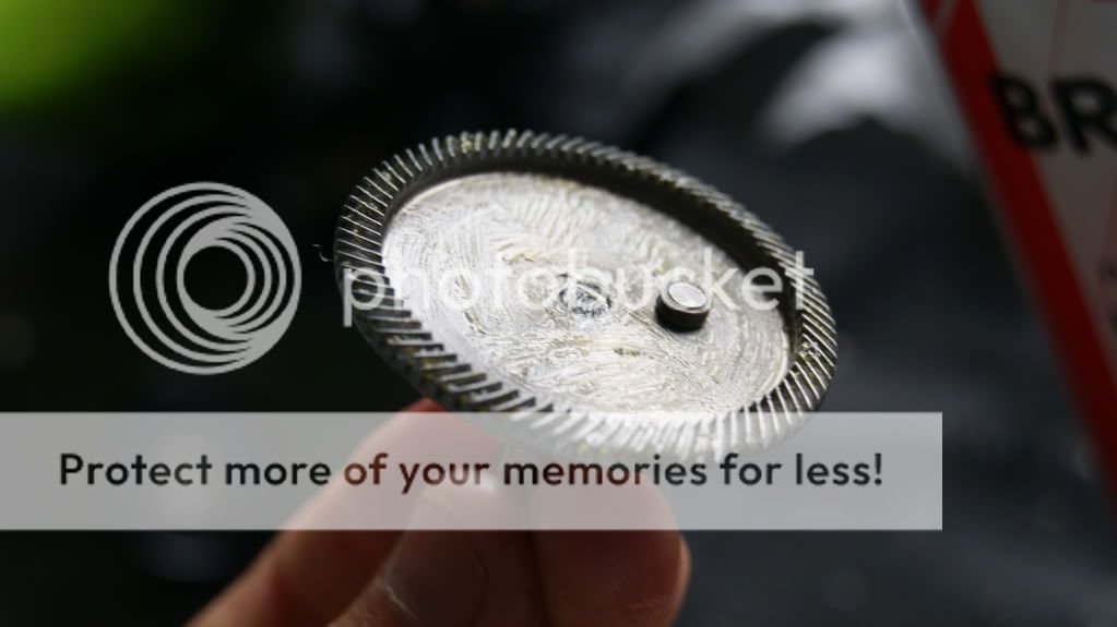

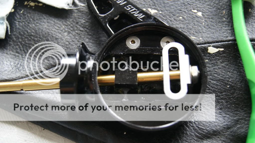

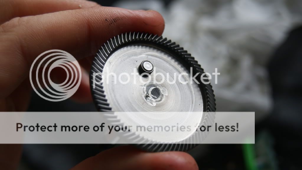

off goes the frame and the main gear in one operation. (very nice metalwork here)

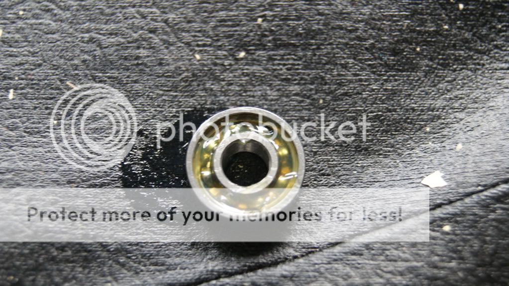

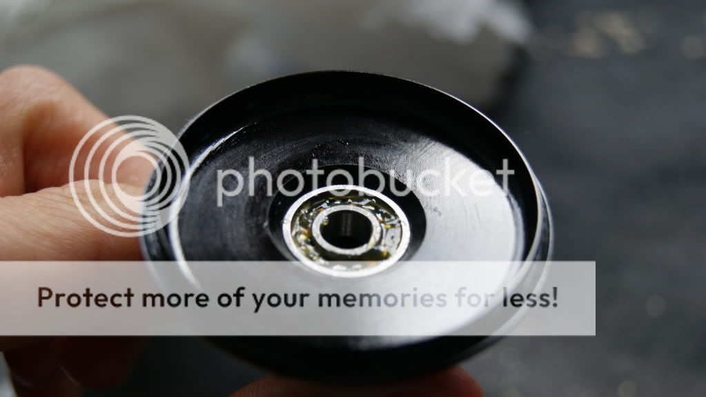

out goes the bearing
clean and relube
then slap it back in
clean and relube
slap back into the housing.

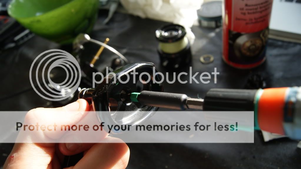

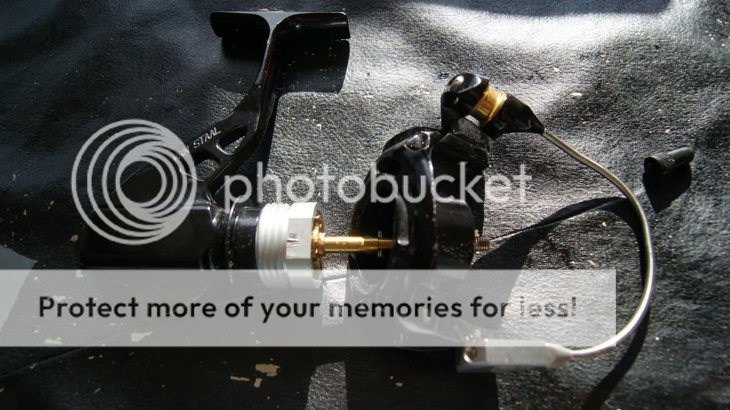

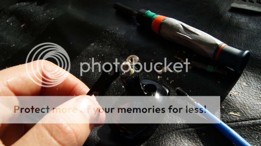

four umbraco screws will remove the rotor
all main components detached

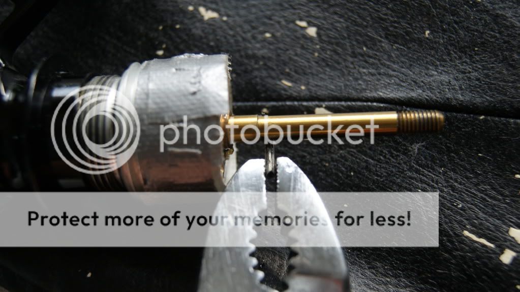

tape this one too, so it will stay nice and not full of scratches

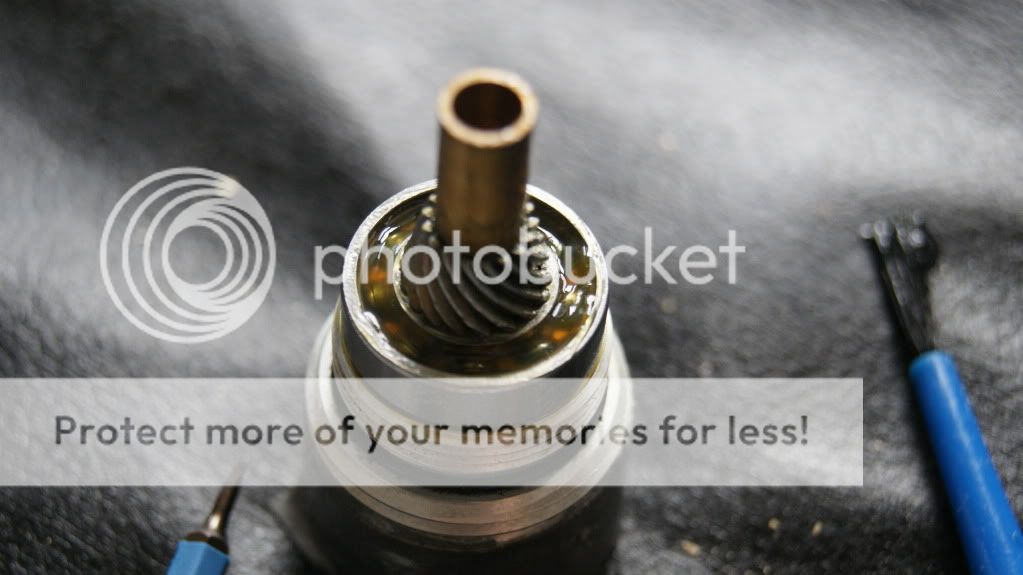

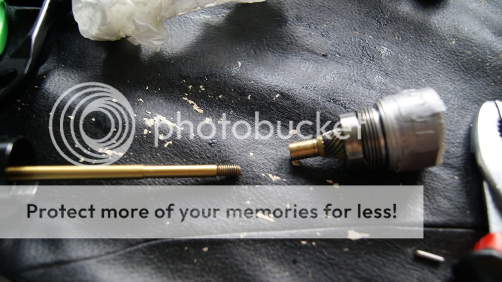

this one goes out clockwise

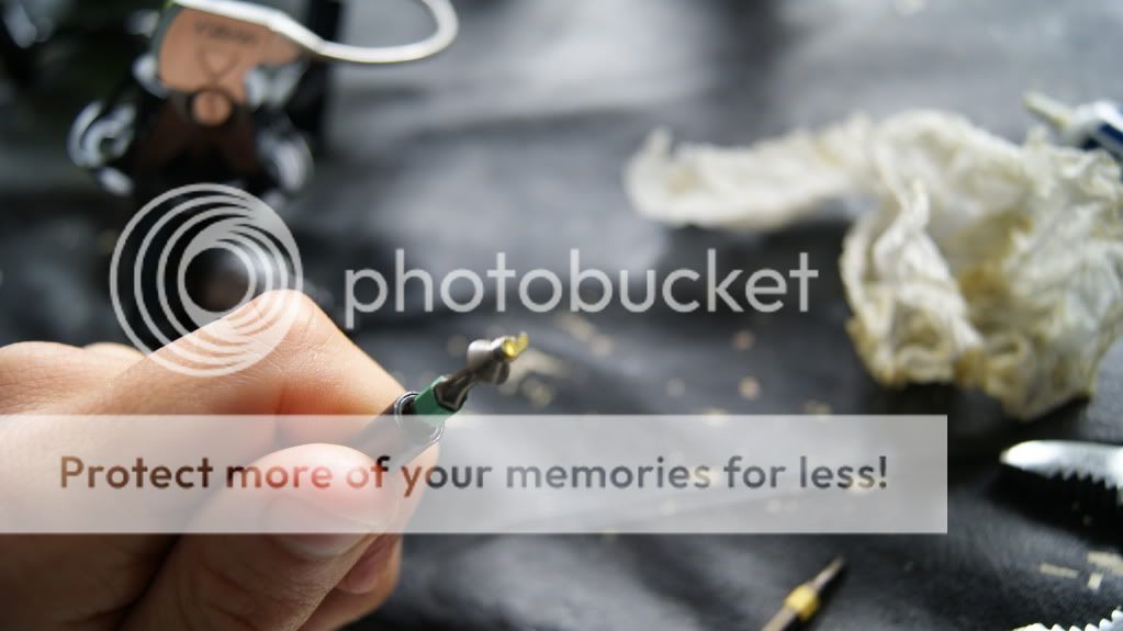

pull out the retainer pin

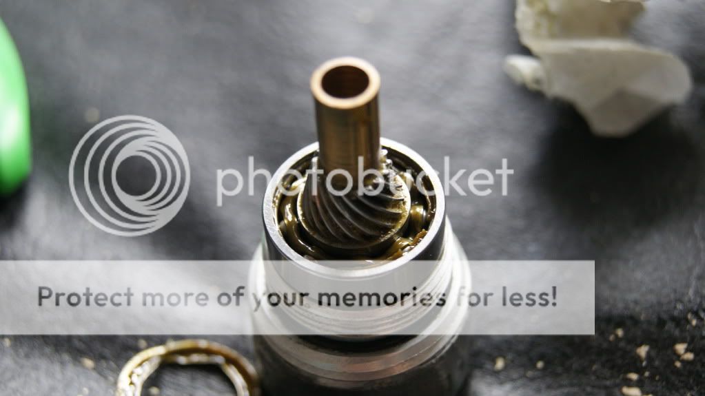

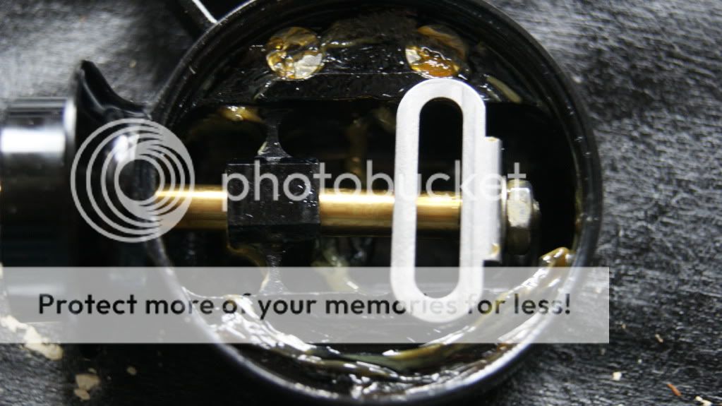

I do not know what this part is called and I could not disassemble it. However there was a bearing the that I could clean out and regrease.
on to the house, remove old grease
Off goes the reel foot
the spaces here are filled with silicone. I just slapped some grease on it and put it back
screw it back on and add a thin coat of grease inside the house
back on with that thing. (roller clutch???)
back on with the retainer pin
back on with the main gear and housing
back on with the rotor
add a pearl of grease on the screws.

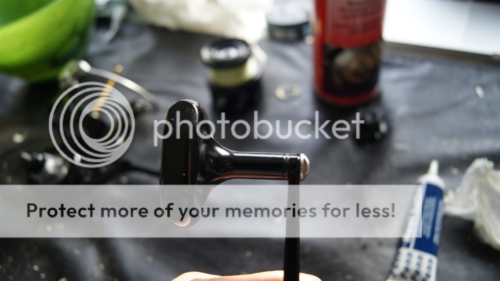

on to the handle (just add some grease so it won't seize up)
and then you are all done
