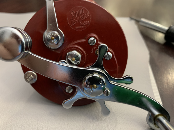

Hi.  This is my first post to the site.  I have used the info from all of you to rebuild the drag stack on a Penn 320 GTI, to service a couple of 4/0's and a Jigmaster.  Sorry, but I did not make photos of the 320 to show all of you.  That won't happen again!  The info on this site is great and it is clear enough I have yet to be stumped ... until today.
I just received a Jigmaster in the mail.  Looks to be new or almost new.  Here is the problem:  when I back off the thumb screw for the quick take apart, it is nearly impossible to rotate the side plate to remove it. Though I was finally able to muscle it loose, I have not been able to rotate the side sufficiently to line up the thumb screw to able to properly reassemble the reel.
What I have tries so far:
1. i examined the ring around the right side plate and can not find any obvious issue.  I did not see anything like debris or warpage.
3. I tried greasing the slots or tracks into which the pins are inserted prior to rotating the face back on.  Greasing did not help.
5. I tightened the screws inside the ring to make sure they are flush.  I was careful not to overtighten the screws.  All appears to be flush, but it did not help.
Any thoughts?.  I like this reel and plan to use it for head boats on the Gulf of Mexico.

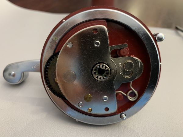

Fred - I did not notice the spool tensioner issue.  I backed it off and place the reel in free spool.  When I attempted to reinstall the side plate, it was as before ... practically immovable.  The pin slip into the proper slot ok, but the side plate will not rotate.  I don't see any obvious signs of binding ... no scratching from my repeated attempts to get the side plate to rotate.   I reexamined the ring into which the side plate fits and everything appears to be properly round.

I tried assembly w/o the spool.  It did not really show me anything.  I also removed the ring from the posts and stands, then fit it to the reel.  Again, nothing manifested itself.
I also tried the file on the pins and ring with no effect.
I'm buying another used Jigmaster reel locally  this week.  I will try cross fitting right side plate assemblies to see if that tells me anything.
Southwestern parts has a new ring in stock.  I will likely drive back over there this week and pick one up, maybe after I fit check all this on the 2nd Jigmaster I am buying this week.
New photos of the reel "assembled" with the Take Apart issue. New drag washers installed and reel has been lubed.  Looks good so far and spins like a top.

I want to close the loop on this project.  I went to Southwestern Parts and Service this AM to look at a NIB Handle Side Ring.  When I compared the NIB ring and the ring installed on my reel (aka old ring), it appeared the inner portion of the old ring was separating slightly (VERY SLIGHTLY) from the outer portion of the ring. This seemed to me to be enough interference to create the binding i was experiencing.  The comment about tweaking came to mind and I wonder if this is how the tweaking manifested itself in this reel.
I bought the NIB ring, took it home and installed it on my reel.  It now works like a charm.  I have installed it on the rod and it looks great.  Can't wait to use it (I hope!!) in a few weeks.
I have attached a picture of the old ring which shows the slight separation.  I have also attached a picture of the reel mounted on the Ugly Stik Elite rod.
