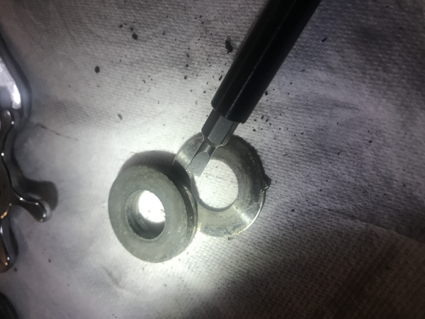

Back at again!!!! I was thinking of positioning the dog spring so that it would push the dog more strongly
back into lock and this is what I came up with!!! I haven't tested it yet but it seems to engage stronger and the
dogs click loud enough to know that they're both working. I also filed little nipples on the dogs for the springs to rest on so they won't walk off.  It's a drop in also, no side plate alterations needed.
What do you guys think????
Peter
mhc
That looks like it will work fine Peter. I first thought the springs might slide off the dogs but it sounds like they stayed in place when you tested it - nice work.
By the way I still haven't tried those pins you sent, I haven't forgotten them I just haven't needed to double dog a bridge yet - the last couple I've used had already been done.
Petah
Mike,
        I'll revise the post. I put little nipples on the dogs for the springs to rest on.
Peter
