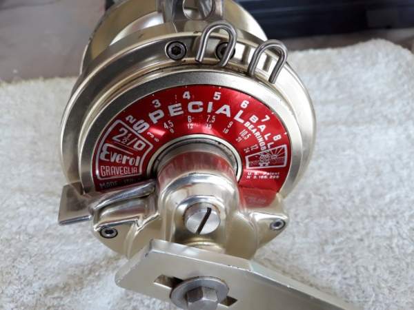

I unexpectedly picked up an Everol 2 1/2 Special recently and figured I'd give it a 'once-over'.
As it's a red-plate version, I understand that makes it an early 70's vintage, just like me.  ;)

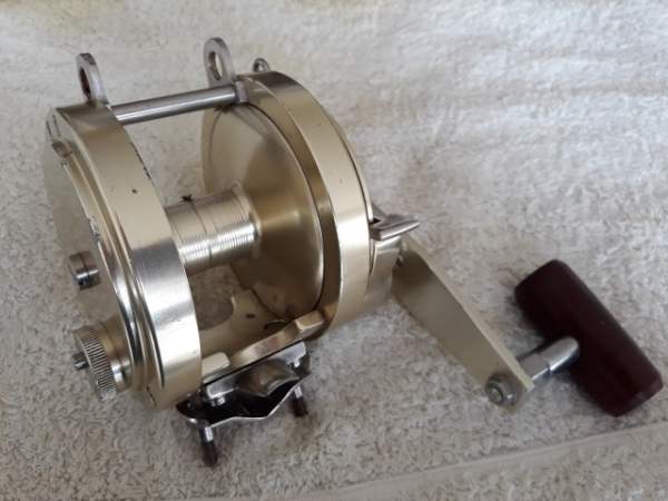

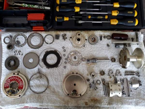

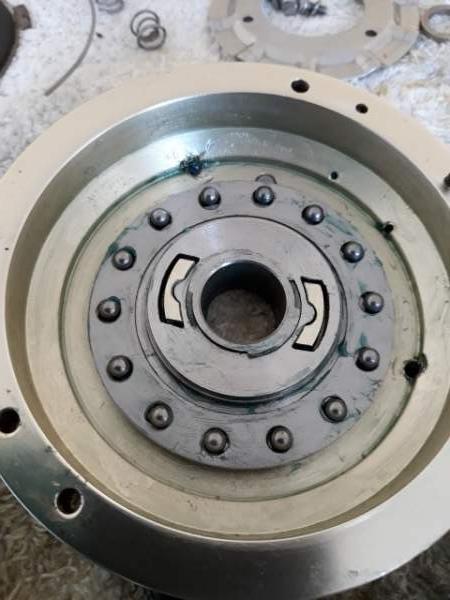

So here it is 'parted out' and ready for a good couple of hours' cleaning.
I always go a bit overboard with this part of the process, but find a pedantic eye for detail pays dividends later in the rebuild...

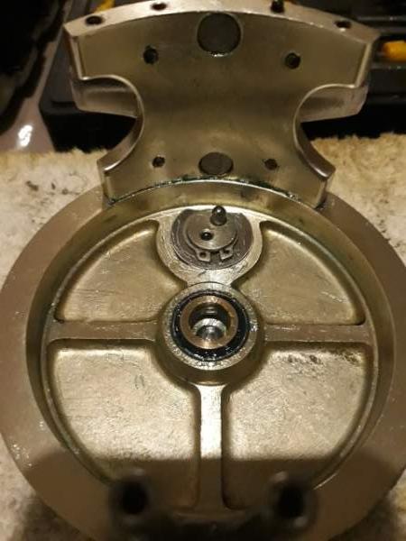

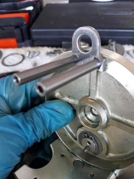

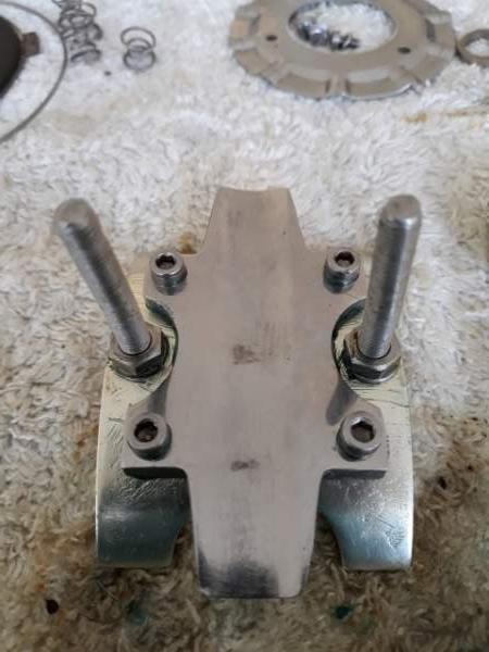

With Everols, I always rebuild the reel foot completely first and put aside. You'll see why later.

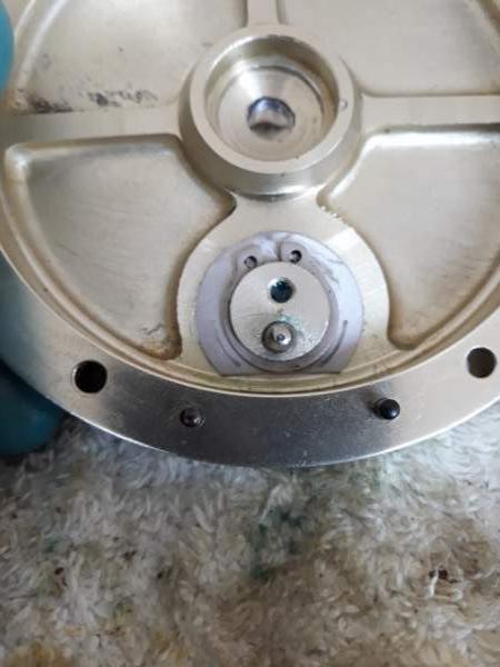

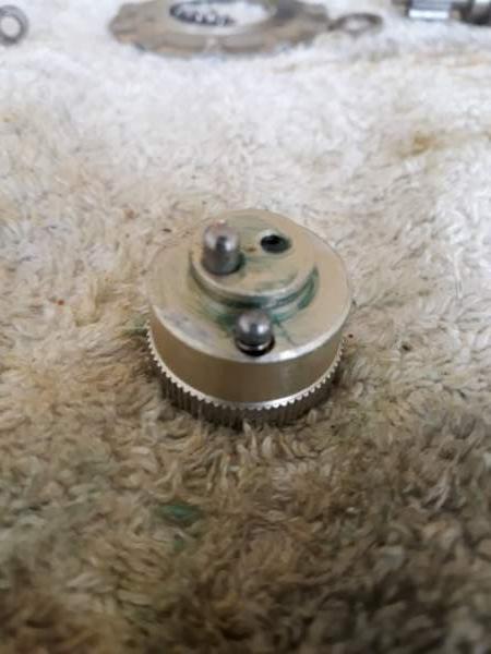

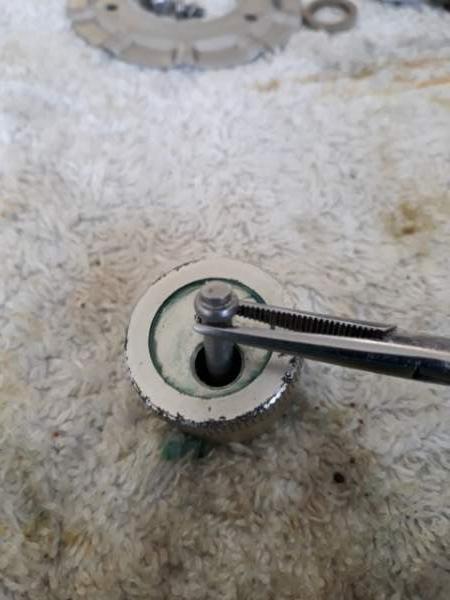

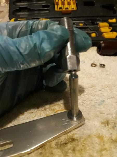

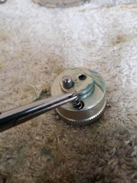

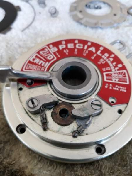

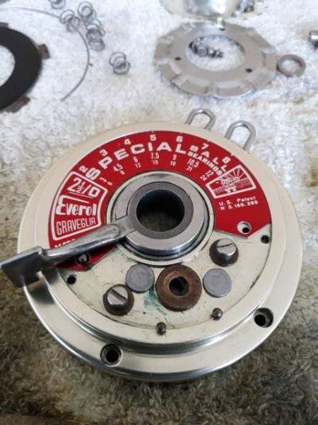

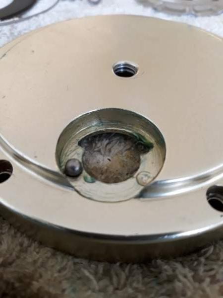

The clicker assembly on Everols is sublime, I reckon.
This is where the ball bearing sits in the assembly, but it's tricky to place it back in the side-plate perched atop the spring like this...
So just place the ball in the groove like so and place the assembly on top of it...
Fit the cir-clip and this part is done.

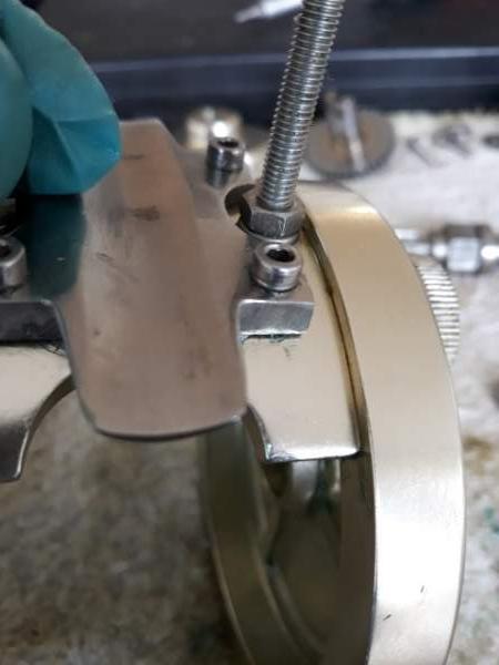

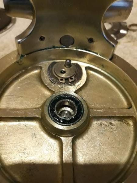

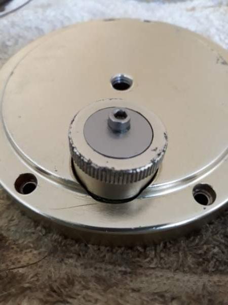

Now you can see why I pre-assemble the reel seat - the side plates 'shoulder' up above the edge of the foot and are really easy to scratch/damage while tightening down the foot/rod clamp etc.

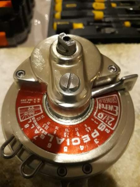

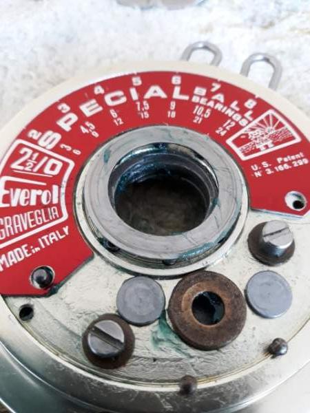

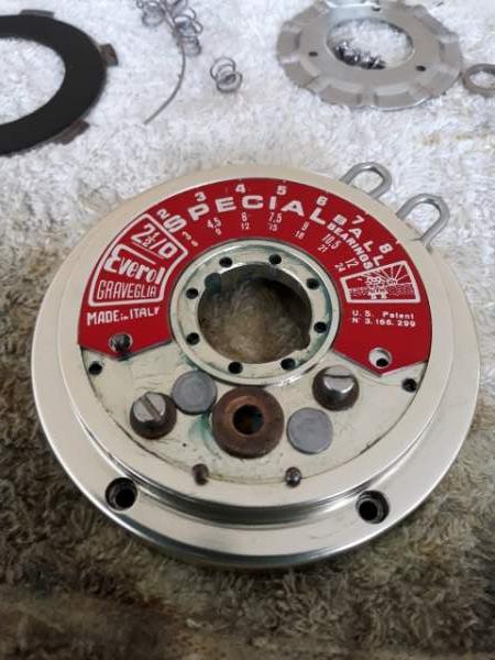

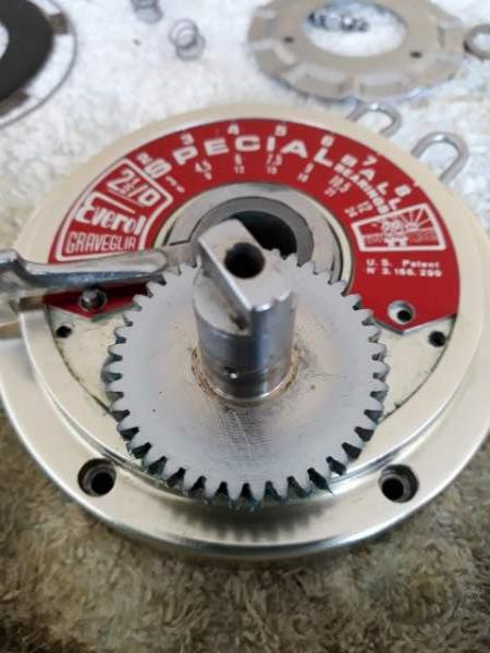

This is the right side-plate bearing race and one of my favourite design elements of Everols.

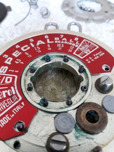

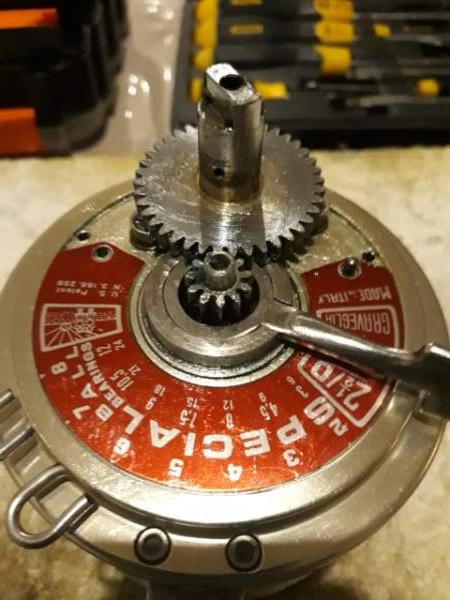

The next few shots show the various steps in the bearing, cam and lever assembly.
Initially, I greased the bearing as I've done in other larger Everols.
Once complete, however, I found the grease created a little resistance within the bearing - perhaps because it's a smaller, lighter reel overall and, thus, has less momentum in the rotating parts.
Anyway, I stripped it again, cleaned out the grease and re-lubed with ReelX, which worked perfectly...

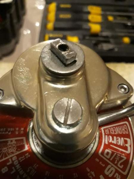

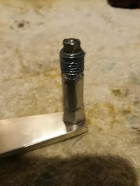

The lever and cam assembly attach to the right side-plate bearing thread (on the other side of the plate) and, starting from a six o'clock position, rotate counter-clockwise to the freespool position...
Fit the cir-clip and you're done with this part...

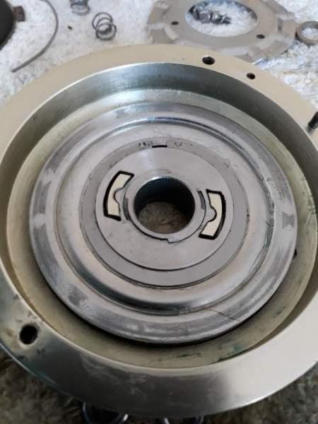

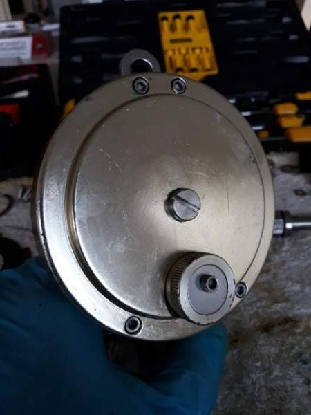

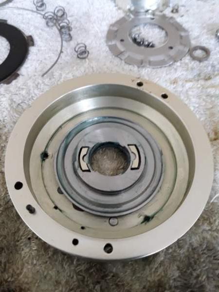

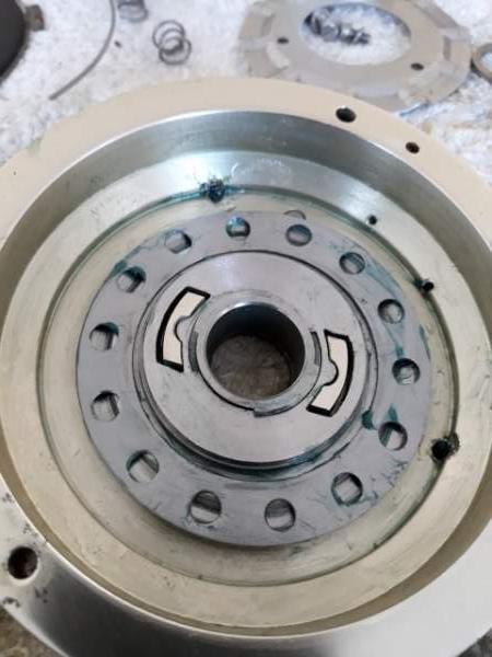

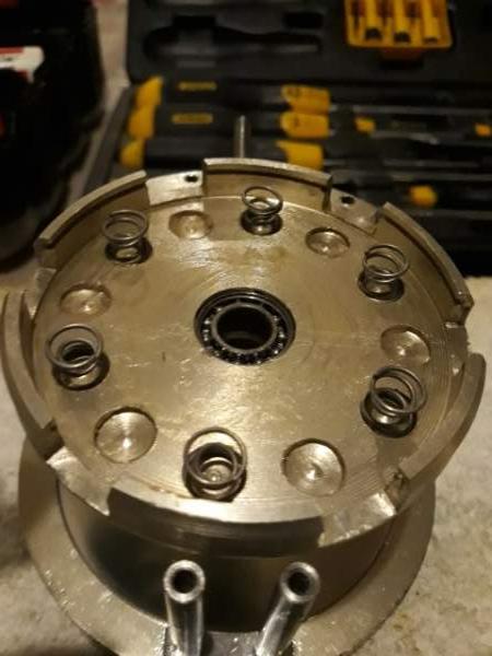

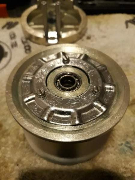

The side-plate bearings are all packed with grease...
While spool bearings are cleaned and treated with TSI301.

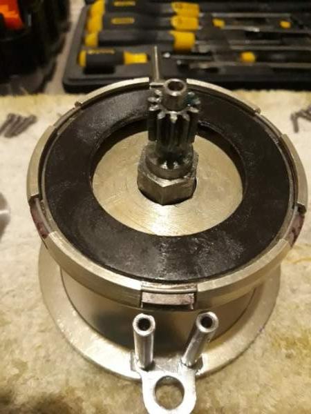

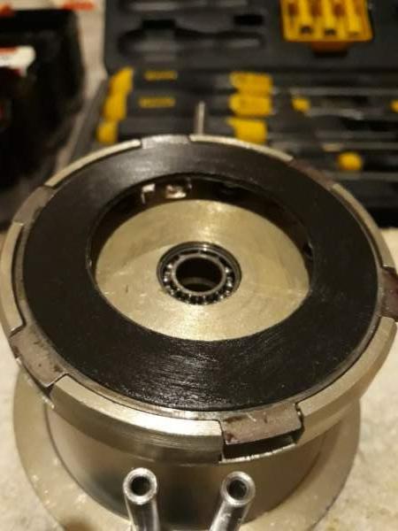

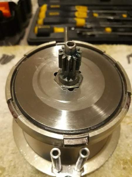

Note the wire spring clip which preloads the drag plate against the inside of the spool.

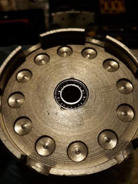

The outer drag plate had been 'flexed' out of true over the years so I considered fitting it the other way up to flatten it out again - you can see the drag wear pattern in the below pic, as it's upside-down.
However, once assembled, the very slight convexity of the plate made it jump off the driveshaft when in freespool.
So I went back to the original orientation and it all worked perfectly again...

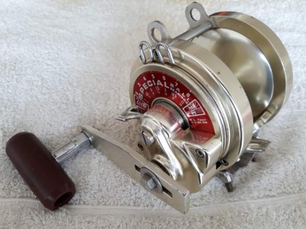

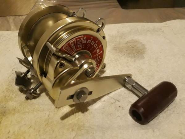

Et voila, you're done...

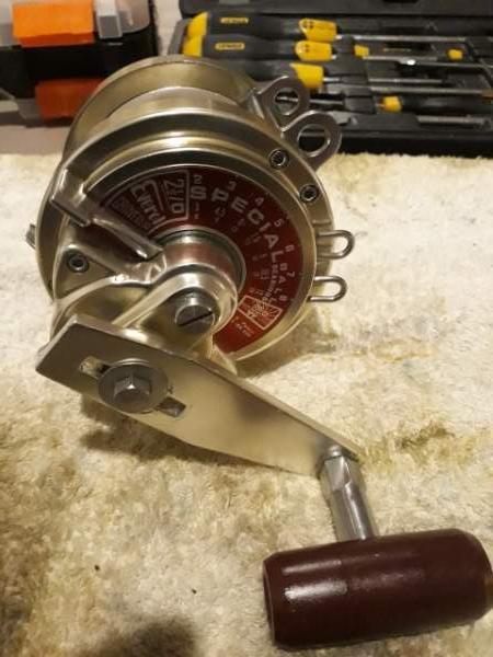

Like many Tani-ites, I have a real thing for Everols.
They're absolute tanks, but somehow graceful at the same time - and always an absolute pleasure to work on.
I'm not planning on keeping this one, so if anyone's interested in owning a piece of pure Italian artistry, send me a PM.
Righto, hope it was of some interest.
All the best, Justin
PS 2min 20sec of freespool - not bad!

The drag is 'pre-calibrated', so there's no need for adjustment.
As a result, it's consistent, predictable and solid.
It runs 12lb at full spool and 24lbs at half spool at '8' on the dial, but the lever goes another inch to sunset, which probably doubles those drag numbers.
With the drag set at '8' on an empty spool, I can barely force a turn...
I've heard stories of blue marlin taken on 2 1/2s, but can't attest to their veracity  ;) ;D
