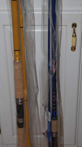

FedEx also delivered two rods today from Cabela's, a 9' MH Whuppin Stick and an Eagle Claw heavy action 10 footer. It was time to start buying some rods, got plenty of reels already, but not enough, of course ::)

how do the Whuppin'Sticks compare to Ugly's & yellow EC glass?
guessing the blanks are decent glass, but how do the components look?
thanks, for any info.
Yes, I imagine all 900 series are steel-on-steel worm since Mike's is the smallest, and mine is the largest.
The Whuppin Sticks are pretty much the same as an Ugly Stik other than the color.  But most Uglies this size have the foam handle, this Whuppin has cork.  The Whuppin is about 10 bucks cheaper, but I can't tell a dime's worth of difference.
This big Eagle Claw is practically an oversize version of the little Eagle Claw Featherlight yellow ones.  I have one Featherlight in the garage I've had for at least 35 years, never really had any problems with it.  I fish mostly from the bank, sometimes around rip-rap below dams and steam plants, so I'd be reluctant to use something expensive there.  The old Ugly Catfish 7 and 8 footers have served me well, along with a 12' Offshore Angler I bought at Bass Pro for about 30 bucks probably 10 years ago.
