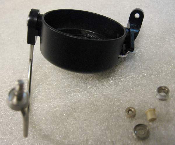

My first step, before my fingers get all greasy, is to assemble the rotor and bail mechanism. The bail springs are wound opposite and this photo shows them relative to their correct side. They must be installed on the correct side or they will be bent, sprung and difficult, if not impossible, to re-bend or adjust.
No need to fight or struggle with bail spring installation. Install the spring and bail arm on the roller guide side. I use ArmorAll for lubricating bail arms and springs because it stays slick and does not collect dirt or get gummed up.
I lightly grease the bail trip screw hole. I also add some on the nylon trip bar and install the bail stopper (trip lever) and spring. Once installed, you can pull the bail stopper back to allow the bail arm to rest correctly on it.
Next we thread the bail plate all the way onto the bail and then back it off 1/2 to one full turn. Check the bail to make sure it lines up perfectly with the hole in the bail arm. Bend or adjust it if needed so that there is no pressure sideways or up and down. Other than gummed up bail springs, misalignment is the single biggest reason why bails don't work properly.
Once the bail is adjusted for perfect fit rotate the bail plate so that it lays parallel with the bail.
Install the spring and bail plate/bail adding a drop or two of ArmorAll, or lube of your choice. Once installed rotate the bail in the appropriate direction to get tension on the spring and then turn the bail 90 degrees to line up with the hole in the bail arm. Have the line roller, teflon bushing, protecting washer and bail nut ready for installation. If the bail is adjusted properly lube the teflon bushing, roller guide and protecting washer with ArmorAll and install them. Check to see that the bail snaps back with authority and if not adjust accordingly. Set the rotor aside for later installation.

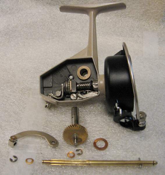

First, install the anti-reverse button using the e-clip. Add a little grease on the screw and install the anti-reverse hook (lever) & spring. Lube the screw/lever/spring connection. I use oil there.
Next, assemble the drag stack & fulcrum mechanism. Notice these came with fiber drag discs. The washers are lying in the order they go together, from the right to left: click washer/gear, SS washer, carbon washer, SS keyed washer, carbon washer, SS washer, SS spring washer. All washers install on the long side of the click washer. The flat side of the washers rest against the side of the body. The recess is for washer clearance. Lightly grease and oil between all washers.
Turn the brake screw into the brake cashing all the way, grease the flange and slip it into the hole. Now install the brake arm. Don't install the insert support yet. Make sure all the flat sides on the SS washers line up with each other. Push the brake arm back as far as possible and install the drag stack in one piece with the short end into the worm gear/pinion bushing making sure all three SS washer flat sides are down against body.
Push the top of the brake arm forward and install the insert support. Make sure there is sufficient grease there in all locations. Tighten the brake cashing just enough so there is slight pressure on the drag stack keeping all washers in their correct position.
Now we're ready to install the pinion/worm gear, bearing and rotor. Install the o-ring on the pinion gear in the groove just behind the linear anti-reverse teeth. The o-ring reduces anti-reverse click noise. Grease the rear pinion bushing and the pinion/worm gear inside and out and slide it into place through the front of the body.
Grease the bearing cavity and bearing and slide it into place. Secure the bearing with the split ring retainer. Grease the front edge of the housing and bail trip stud.
Install the rotor cup using the locking washer and hex nut.
Now it's time to install the main gear, main shaft and oscillation arm connecting link. Grease, lube and install the main gear, not forgetting to install the larger spring washer between the gear and housing bushing.
Grease, lube and install the main shaft. Now is a good time to spin the main shaft while making sure the drag stack is aligned and functioning correctly. Also, don't forget to install the spring washer between the main gear and connecting link (oscillation arm), and the spring washer at the rear of the main shaft in front of the connecting link attachment holder. Grease, lube and install the connecting link (oscillation arm) onto the main gear and main shaft using e-clips at both locations. Check and lube/oil any areas or connections that may have been omitted and make sure there is adequate grease on the main and pinion gear teeth. I also like to add a drop or two of oil to the main shaft in the pinion gear and both ends of the connecting link at the e-clip studs.
It's time to install the brake knob & retention spring, side-plate, handle dust cover & felt washer, crank handle and spool. The brake knob screw is reverse thread, so be aware of that issue. A quick test makes sure everything everything is working properly.
