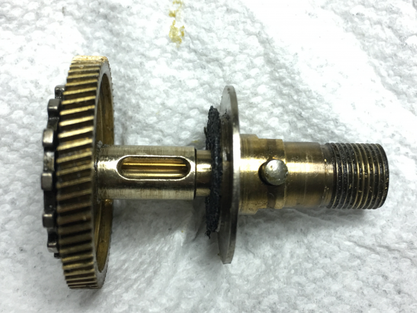

Lunker Larry
Got one! Sure don't envy you guys working on salt water reels.
Nasty. Any lube is better than none, I think.
I've seen them much worse and they always come back.
Quote from: Lunker Larry on May 28, 2019, 04:32:02 PM
Yay!!
put lots of penetrating oil, wd-40, liquid wrench, etc on the handle and shaft that are still stuck together, leave it for a day and later tap the handle witha wooden hammer or heavy kitchen spoon, use the star to push the handle as Alan suggested.
