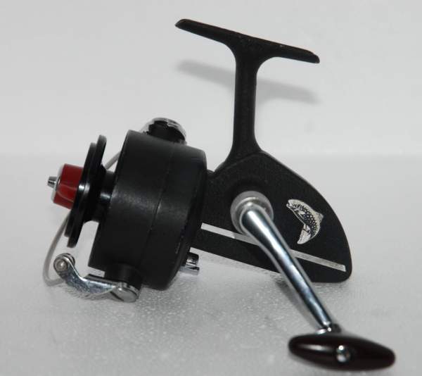

Went to an estate sale and picked up some old beater stuff, but found this diamond in the rough....I know little about D.A.M. Reels, but from what I gather this is a 270?   No emblems or marking other than the West Berlin cover plate and Quick Super. The body is painted dark green crinkle and the spool still has some black paint....looking forward to fishing it, but will need a complete service....Bill
Correct, Bill —
DQ 270 Super.
Around 60 years old.
It will service and clean up to be fully capable and fishable, even if no parts are desired.
Generally, a 270 will need 17 to 21 parts to bring it back to new condition.
There are some tricks on these that are not intuitive — and could result in ruined parts if not aware of them.
Needs a full disassembly, cleaning of all parts, burnishing and polishing of all parts, recleaning, replacement of any parts wanted, modern lubes, tune, and adjust.
There were (4) versions of these over a period of 9 years — so even though some part numbers may match in theory — there are differences that will not allow them to work properly — unless matched to the proper parts version.
The crank shaft comes out from the outside — but a tiny roll pin under the gear must be punched out — the gear removed from the shaft — before removal is possible.
There is also a steel pin through the ball handle that must be removed — this is harder.  Inspect with a magnifying glass to see which end of the pin is slightly larger — and has splines hopefully showing.  Using a punch, hammer, and a block of wood with a hole and groove cut into it — punch out the pin from the smaller end of the pin.  After 60 years, these are seldom easy — but it has to come out to get cleaned up.
Of course, it also needs a new stand.
These reels are so tough — that any of these things can be worked around — depending on how you wish them to end up — modified or original.
I can help you with any parts on these, Bill — depending on what you want to do.
A couple of these were restored in between builds last week — that were both much worse than yours — and they turned out perfect.
If done right — your kids will be using it long after you and I have moved on...
Toughest of the Quick reels.
