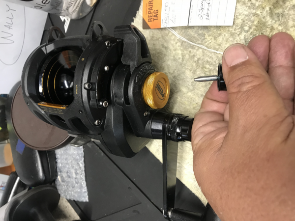

For really big fish, the large, stainless pinion is very hard to shred, for the fish you catch I'm not sure it matters. Based on what I know of your fishing, you are happy to buy quality. If you want a slow presentation and power from low gear ratio in a small capacity reel it is really hard to beat a Surfmaster 100. You can find one for almost nothing and then put a Tiburon frame, small thread stainless gear sleeve with oversized star, 5 stack drag and nice power handle on it. 300 yards of 65# braid will fill the spool to the top.
It will be a world class reel for less than a fathom and will be exactly what you need.

Mrbrklyn, your more than capable of doing this right on your dining room table as long as you have a flathead screwdriver, an alantani wrench, some good penn grease or yamaha grease and a very small amount of a good synthetic oil. Go for it and if you need help there is plenty of knowledge right at your fingertips here in this site. Its all about the fun and what were about here!

 Not going to cast like our Torques but not many reels do in this class of reels & have the refined over all smoothness.
I could be wrong but I think youd be very happy with what Ron is suggesting. these old style Tib framed reels took a while to grow on me.
