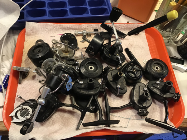

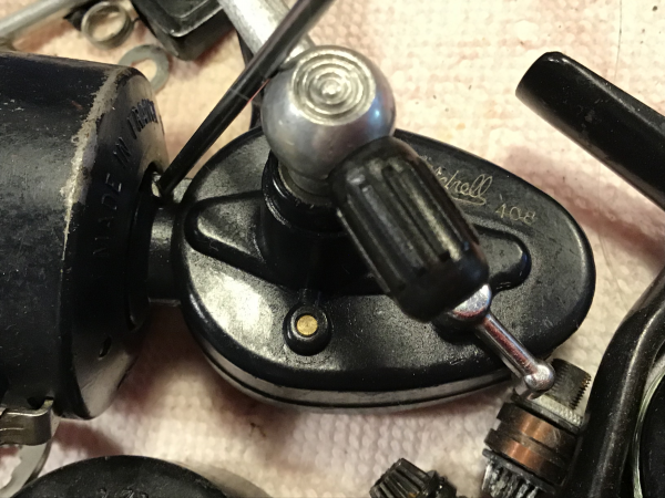

I've got the rotor/pinion removed from the body.  My issue is removing the rotor from the threaded portion of the pinion assembly itself.  I've actually applied Kroil and stood the assemblies up to allow it to creep into the threads for several days.  I would thought they would turn on the threads readily, but so-far, nothing.  I've had a few 308/408/908 models apart for service.  This is the first time I've tried to remove the pinion assembly.

In that case, just reassemble the reel so that the gears will hold the pinion — as you unscrew the rotor, COUNTERCLOCKWISE.
It is just stuck from being used over the years and never removed.  Or it could be jammed due to being cross-threaded.  But that is unlikely, since you would have noticed an off-center "wobble" as the rotor spun.
Hopefully you will not ruin the pinion teeth — but if you do, I have new pinions — but they run $50 for a main and pinion — since they are scarce and nearly unobtainable.

Should I install the pinion set screw to do this?  The shape of the gears tends to make the pinion want to climb out of the housing.  Harder to find than the pinion is the main gear.  I was going to change both components because I assume they wear as a set.
I've got a new looking 408, but when I opened it up, the teeth on the main gear were turned to mush.  I can only assume that the grease used was not compatible with the yellow metal.  I bought a parts reel that had a good main gear and I think the pinion is salvageable as well.

Yes, install the set screw, main gear, side plate, and handle tightly.
You should be able to hold the handle to back off the rotor — got to be careful to not slip the teeth on the pinion or main — just hold everything firmly and unscrew it.
A couple of times, I have needed to use a strap wrench on a rotor for extra leverage with no damage.
If the handle unscrews while you are doing this operation — you can also remove the side plate and all components inside the case — then using a "C" clamp with two small blocks of wood on both ends of the main — this will hold the main and pinion as you unscrew the rotor.

If it is that hard to separate — then I would use a soldering gun or small butane torch to heat the threads where they attach to the rotor — then immediately hit it with Freeze Spray.
This is an aluminum rotor and a steel pinion — the dissimilar metals are fused together.
I would also consider using a couple of strap wrenches for leverage — one around the rotor — and a smaller one around the pinion.

I only have an electric soldering iron, so I heated a big nut with a torch and let it heat the aluminum up.  The reel that looked like it came from a bottom of a lake came right apart.  As for the other, I'm still working.  I managed to strip the threads off the handle trying to get the rotor off.  Speaks well of the strength of these Gleason gears.
Forgive me, but I think I'm going to drill it.
Anyone know what tap to use to clean the treads on the drive gear?  It almost looks like an acme.
