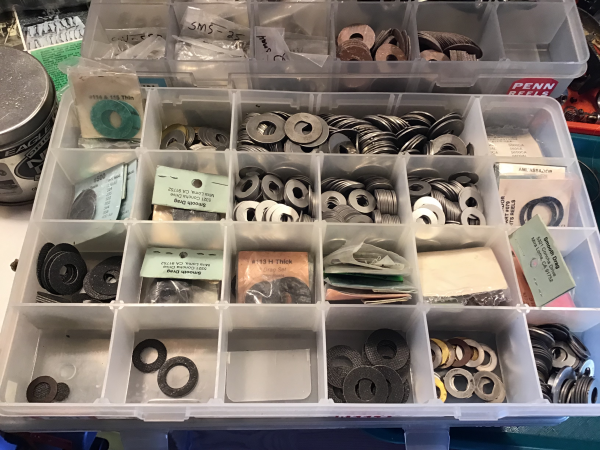

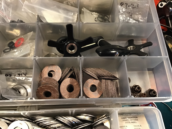

20 or more years ago — I used plenty of those thin, hard, light green washers from Smooth Drag.
I have another dozen green sets in my Offshore service and repair “go-bag” — but I should switch them out for CF’s.  Bryan, Smooth-Drag, Mystic, Penn, and Alan — have plenty of these for your reels.
The brown marbled ones are Newell discs — very similar.
They were an upgrade from stock Penn drags.
However, like Alan said — after a couple of demanding trips where they got hot — soon they would not be smooth anymore — just sticky.
Daiwa started using and selling pre-greased drags that operated better — but most would only fit Daiwa reels.  But I noticed that even though they were a felt type drag washer impregnated with grease — they were lasting much longer for the rock cod guys than the light greenies.
When I learned about greasing CF’s & HT-100’s with Cal’s grease from Alan — it worked so well, I never put in another hard washer, unless it was a restore for display, or a reel that would not be used hard.
And the greased CF’s will nearly last forever — always operate smoothly from startup to lockdown — and give you complete and instant control over your drag system as you work a large fish.
And even in a little “9”, 209, LB, Jigmaster, Squidder, or large Senator — folks rave about how smooth and effective the drag systems are after getting their reels back.
Thanks, Alan!
