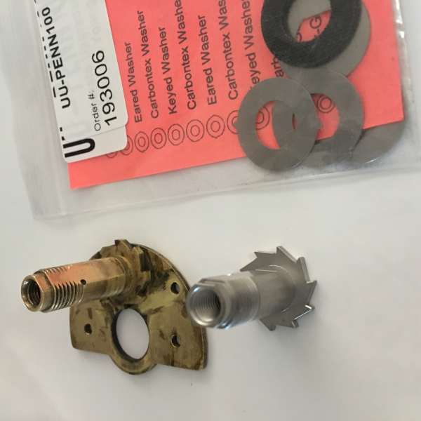

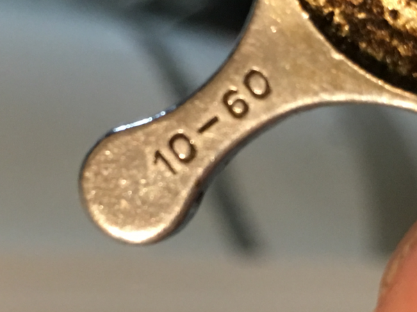

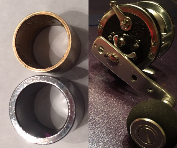

since i have this style 10-60 star drag, I got this 98-60CC sleeve and ultimate drag kit from mystic parts.
ah, another trip down the rabbit hole!!!!!   ;D

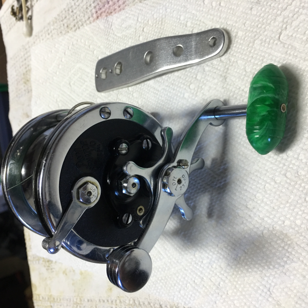

   If you have a #10-66 drag star they look beastly on the little 1/0...along with a #24-56 power handle. 8)

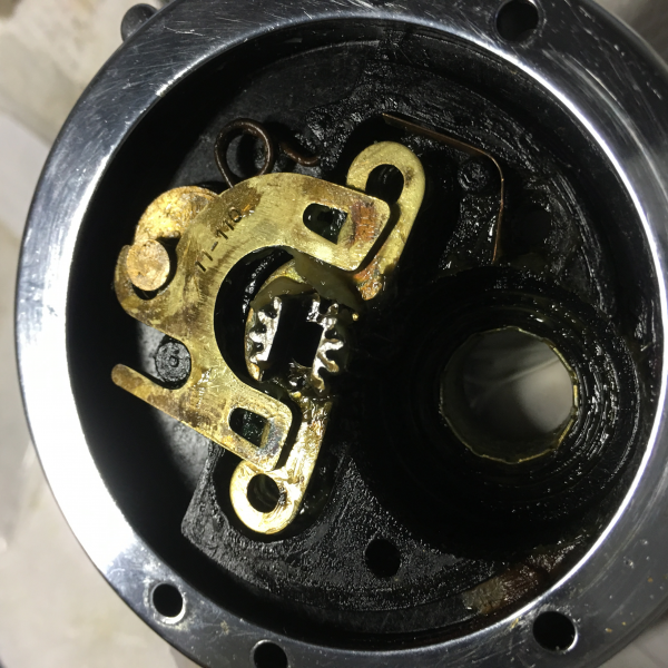

getting that dog in place is the trickiest part. i was debating about that 24-56 power handle or a prochallenger eva knob.   Alan, you should never meet my wife again.  ;D

and it's back together.  I got this aluminum handle arm from mystic parts (gotta meet that free shipping limit) which i was thinking to pair with the EVA knob for balance.
Nice 1/0! Yes...the Pro Challenger EVA knob looks great on that handle arm.

Great work! I was gonna say teh same about the 10-66, but Mike got you on. The 1/0 is a pretty beefy reel for that lil star.

i think i should have put the dog spring the other way.  the dog clicks when I crank, but the sound (and pressure?) is softer than i remember.  it's still engaging the sleeve to prevent backwards motion, but it's very quiet.
Quote from: jon_elc on October 28, 2019, 08:26:36 PM
   That's not uncommon. In order to get a real strong click, straighten the spring and insert it behind the dog. Then wrap it around the post and into it's slot. It has more tension that way.

A gentle pressure on the dog could be a good thing, as long as it still works. I've seen a few dogs with too much wear, possibly due to excess spring pressure.
