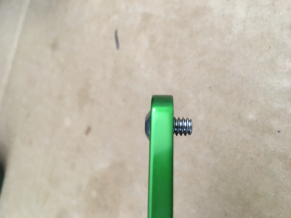

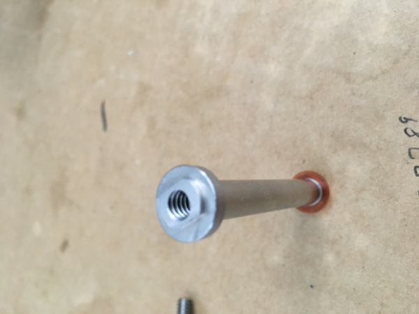

Toehi
Parts came in a few days ago but my 5 month old has demanded all my after work tinkering time. Finally got around to getting some pics.  The screw provided works, but if I can find a pan head replacement at Ace I might go with that. Next step is to figure out if I want to mod the blades to take the keyway of the handle shaft or just grind off the piece.
JRD
You would probably be worlds ahead just grinding the shaft flat so you don't compromise the anodizing.  You could also call Al at accurate and see if he has a few old style shafts laying around.  Good luck with the build.
