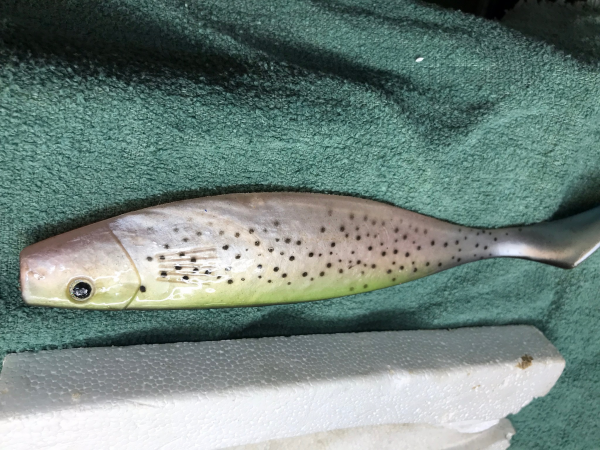

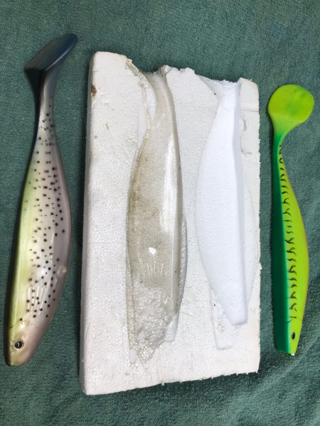

Shown below is something that might interest someone?    These imitation baites were stored on a shelf ina fairly dark environment for a few years.  The styrofoam seems to be degraded and made a perfect bed for the two lures.
The lures seem to not be degraded.  I,m sure someone can explain what is going on here.   Thanks for your reply.🧐
 This is called "worm burn", and is very common to tackle boxes with plastic lined drawers and rubber lures. Umco tackle boxes are famous for worm burn. It's obviously some kind of chemical reaction, but that's as far as my high school education gets me.
-Ted
Plano started making the first molded plastic tackle box in 1952.  Before that, tackle boxes were painted metal and always rusted, especially around salt water.  Your plugs and everything else in the box would get rust stains all over them.  Crème plastic worms were introduced at about the same time.  It took a few years before people realized that their new plastic tackle box was not compatible with their new plastic worms.  The plasticizers that keeps the worm soft and flexible leach out and start dissolving the tackle box tray.  It wasn't until 1974 that Plano came out with a "worm-proof" tackle box and they have been advertising their stuff as worm-proof ever since.  Better living through chemistry.

Plasticiser migration - it's been a problem for years and not just fishing tackle.
During the 60s and 70s the electronics market was mega (Yeah I know when wasn't it).
But a particular problem surfaced.
Mix a hard/firm plastic with a 'soft' plastic and 'BIG PROBLEM' - The soft plasticisers migrate to the harder plastic.
Exemplified by soft pvc cable touching , for e.g, a hard cased capacitor (an electronic component).
The result over time - component failure. This was a big issue.
Plastics, like people, don't always play nicely.
Overly simplified but I hope you got the point.

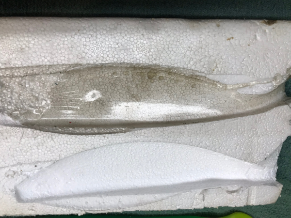

The thing that is interesting to me, though, and has yet to be addressed, is that while the bead board has denigrated into a nearly perfect form the rubber lures appear to have no decay at all.  ???  ::)
not decay -- chemical reaction
nothing leaching out of Styrofoam to effect lures, but:
Quote from: oc1 on December 10, 2019, 06:43:33 PM
...plasticizers that keeps the worm [lure] soft and flexible leach out and start dissolving the tackle box tray...
side-note: had a can of DEET bug spray go off in a closed box -- turned some hard plastics mushy
Quote from: Midway Tommy on December 10, 2019, 09:26:07 PM
I think they shrink and get a little stiffer.  But, it takes a lot of plasticizer to keep a worm squishy and pliable so you might now miss a little when it crawls away.
The imprint in the foam is so nice that you have to wonder if there is an opportunity for mold making here somewhere.  You just need to speed it up and dissolve a denser foam or plastic.
