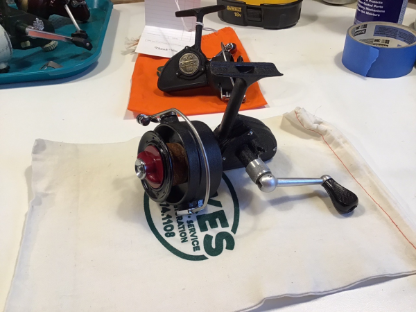

Found this one online from Kentucky for $20 plus shipping.  Nice condition on the outside, very little paint loss but a bit of rash on the handle.  Reeling was stiff, the anti-reverse didn't work, bail function was slow, and I heard some scraping inside.  Didn't sound serious, and I had a hunch with a good cleanout inside it would work like new again.  I had another one of these 550N on a 12' surf rod, but gave it to my brother-in-law in Marietta, GA last summer so he'd have some heavy tackle on his trip to Florida. He was telling about some of the swift water tailraces down there in Georgia, this would be a good rig for big cats and stripers. I advised him to keep the switch pin oiled because the N models are prone to have bail release failures if used in salt water or neglected.Also got a partial 550N disassembled in a plastic bag for spare parts.
I know there have been several tutorials for both the N and non-N Finessa series, but sadly, most of the photos have either disappeared or rendered unfocused by the Photobucket tyranny.  :'(
A look at the bottom of spool.

This one now is maybe the cleanest D-A-M Quick in my collection.  It weighs 19.5 ounces, might be a little lighter than the Super 270 linecounter I made a post about a few weeks ago.  A reel this size seems like overkill for fresh water fishing, but 60 pound striped bass and 90+ pound blue and flathead catfish aren't unheard of here in East Tennessee.  Not even mentioned the introduction of lake sturgeon by TWRA, I know of one 102 pounder that was trapped in some shallow water on an arm of the Emory River and relocated by game biologists. So these setups of a 9' to 12' MH surf rod with 30 lb mono are ideal for fishing below dam tailraces such as Ft. Loudoun and Melton Hill or warm water steam plant discharges during the winter.
