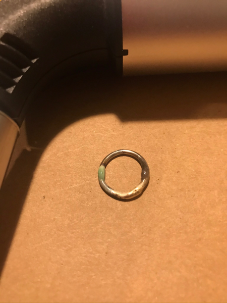

Here's some more information I have on what is working for me.  Using stainless 308 tig rod (weldrod) and the black flux by staysilv and a more powerful butane torch more testing has been completed.
  The silver bearing solder wire is approximately 46% silver and quite stiff.
The little butane torch is very powerful, and adjustable flaming, butt he low setting is enough heat for this wire and cantor the wire red quite easily.
This torch can be purchased on Amazon w. Free shipping.  It's the 💣 bomb for small yet powerful.
The stainless rings and a few brass rings were soldered and tested. The sst. Rings I couldn't break by pulling by hand using a spring scale in between.  100# plus is ok with me as I generally use 80# spectra.
The brass rings broke at about 60-80# as shown.  I now think the brass rings may need a different flux, or silver wire as previous testing seemed to prove a higher test was achievable.
   The new torch has the heat capacity at least, so more is planned.

Good looking soldering, the flux and silver solder you now have should work on brass but I would recommend using only SS rings.
ROSCO butt rings are a tougher SS than the TIG rod.  Here is the test I finally did this morning, 175# and no deformation. I guess I don't have to worry about my rings.  BTW I randomly picked a ring out of a bunch of them.  Excuse the fuzzy photo of the ring, my wife left my camera on the seat of her car last week and did not lock it, I guess someone else needed it more than I did.
I will test some smaller rings when I finish the current job and have time.

I tested a smaller ring and it deformed, the soldered joint held.
100#
150#

They can't be too clean David and do the solder shortly after cleaning before a new layer of oxidation forms.  I like using one of those really small drum sander dermel bits because they remove the surface and don't just smear it around.  Plumbers emery cloth or rat-tail file works too.
When you finish there shouldn't be a bead of solder.  Just a slight bulge with the solder tapering off over 1/8 to 3/32" on both sides of the joint.  Solder follows heat so waving the torch back and forth will usually pull the solder out away from the joint to make that tapered bulge.  Lots of flux too.
