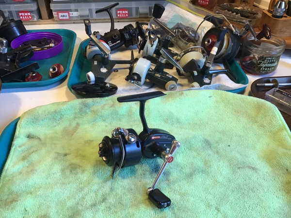

Here is a tiny Mitchell 408 high speed that fits in the palm of your hand.
Notice the quality gears compared to the 400/300 models and types.
This reel is about half the size of a 300 size Mitchell -- and of a much, much higher quality.
The differences --
Less gears to go bad, bearing instead of a bushing, bronze gearing instead of pot metal, and it also has a "planamatic" spool oscillation system for even line lay.
