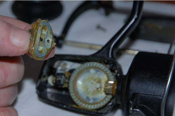

Removing body cover screw.
Inside is a look at another very simply engineered reel with a minimum of parts.
Removing the oscilating slider pin.
Removing the axle.
Removing the oscillating slider.
Rotor nut is 14mm with regular right hand threads.
A look at the pinion.
Drive gear has been removed and there's actually a brass sleeve or oilite bushing under there.
A look at the ball bearing.  My snap ring pliers have four different attachments, but none will fit here.  Since it has a sealed bearing, I did my best wiping it off, giving it a shot of oil and let it be.  Didn't want to spend much time on this reel.  Maybe I can find a pair of mechanical drawing dividers that will take it out.
I cleaned bail spring, arm lever, line guide, etc. but left the anti-reverse and bail trip assembly intact.
Here's the drag assembly--one four way eared washer, one nylon washer, and one keyed washer.  I have no idea if this is correct, because the schematic didn't show a breakdown.
Got it back together, it reels very freely and smooth for such a minimum amount of parts. Almost as smooth as the smaller 7250HRLA which has many more parts. These are medium size reels, spool diameter is the same as a Mitchell 300.  Weighs 12-1/4 oz, but would be a little lighter with the correct handle.

might have hidden value
check if the spool and/or rotor is compatible w/ one of 8000's (or other better models)
or, sometimes the individual parts are incompatible, but the entire "top assembly"
(rotor/spool/knob) can be moved to a different model as a unit
Silvers
The "wrong" handle seems to be from a Shakespeare Ballbearing reel, the knob-style is well knowing for those Shakespeare reels which was build at Ohmori in Japan.
