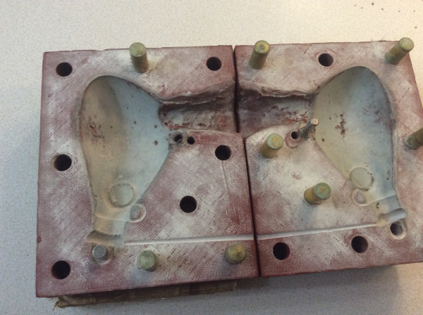

Thanks ya,all about alloys and temperatures.   I do have a point n shoot thermometer and new really thought of using it for this application.   Butt I will.    I just poured some more too before I got this information.     I did enlarge the sprue some from when I got it and it's pouring good.   The dowels fallout some,   Butt I've poured at least 25 PCs and it's still going good.
  I've learned to pull the clamps off quite soon, and crack the mold open as soon as possible to eliminate as much heat to the mold as possible and this seems to help.

Curious as to how much you needed to open up the sprue.  I would like to incorporate this into the next iteration.
I would like to get a mold or two into your hands, just need to figure out the best way to do it.   Also would you prefer a finished mold or a mold master (mold for the mold), so you can pour your own molds?   PM me and we can figure it all out.   Might be easier to talk live.

Here a change Dave thought would help,  increase the sprue size.
It's not difficult to trim the waste when cooled and pours very good now.
12 oz.  very nice design.   Great clean smooth finish.  Fishes good for me.  Thanks Dave.
Most of the degradation is from the heat I,m pretty sure.  The pins for the eyes have became loose and of course pull out of the sockets when spreading the mold.  I try to slightly split open the mold as soon as possible preventing the increase of heat.
There is a split also as I was sucking air at first when pouring,  a backing of wood helped under the hand screw clamps.   This split has not gotten worse for 20 pours so spreading the pressure out did help in not sucking air.
