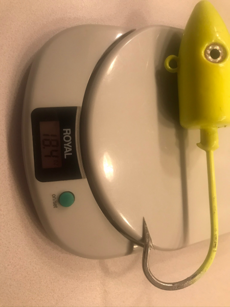

  Here's the before pik.  Box stock.  Easy to make for joe public,  popular with the charters here.
What's the mod Gary.  I have several of these and you're right, they get hit but don't stick?
Offset the tip?  Paint it green like an apple instead of yellow like a banana?

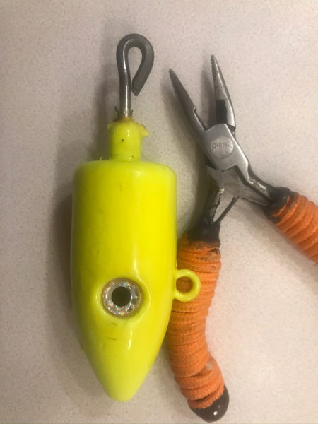

Using the same jig, the j hook can be heated and bent to form an eye as shown below.
 Then a single hook or a tandem can be attached using a loop and or a split ring.
     Now the hooks articulate and lesson the lead heads ability to drive the hooks out of the mouth with the shaking a halibut is famous for.  Plus you can change hooks as desired and skirts also.   A good tip.

Allowing the hooks to swing on a line seems to help prevent the fish from throwing it.
As the lead heads are quite available you can possibly get another/more if you make mistakes.
    I've learned to clip off most of the j part with a bolt cutter.  Then heat the hook shank from the lead back an inch in a half.  The colors need to be cherry red to bend slowly butt,  first heat the hook and then let it cool.  Worse brushing will remove the scale and then you can see the steel better
   Now reheat the shank and bend it to what you want,  remember go slow with the bending and keep the heat on.  From the length after the eye is 3/4 formed with a bolt cutter again.   File the end to remove burrs and 45 degree the end where it will mate to the shank.   Reheatand slowly complete the eye 👁.
    Some jig hooks are heat treated and seem to be brittle,  so use red heat color and go slow and pray.
It's worth doing as these fish waay better..   and you don't have to pour lead🐙🎣👍

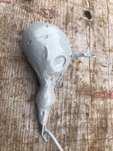

this my construction. Used with good results in Indonesia

Wolli, how do you get the second eye ring in your pour? Stop pouring before you reach the sprue opening, with the wire in the opening?  Gary would have to use much bigger weights, but that's a great idea for around my fishing grounds.
