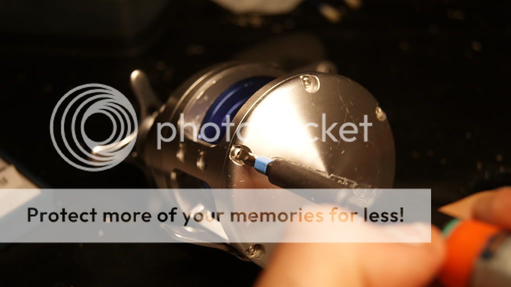

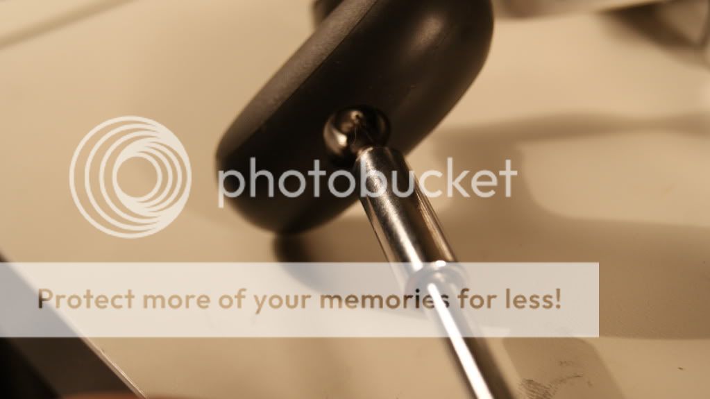

remove all 6 screws to disasemble the left plate

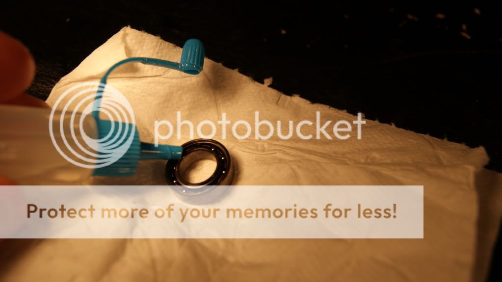

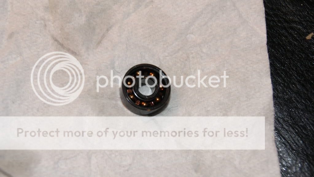

out goes the bearing (some of the bearings were already open in this reel) Still going to clean them
after cleaning with breakcleaner I added some shimano oil.

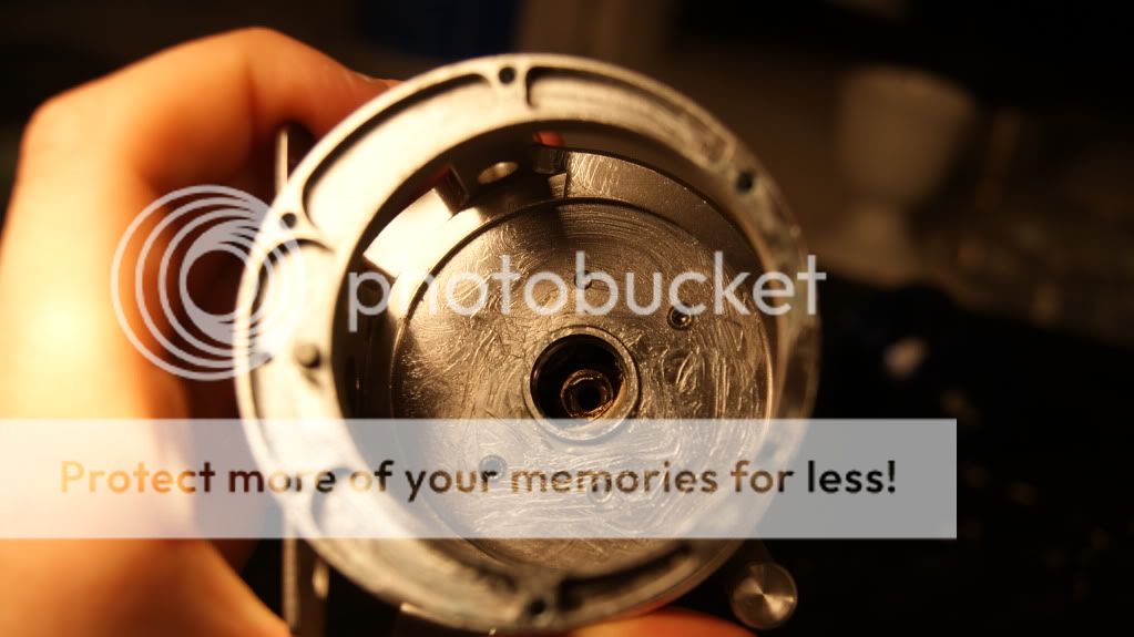

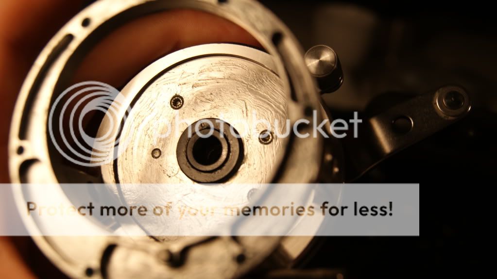

now let that rest and lest start cleaning the left side plate thourougly! (I use white spirit)
paint the inside of the left side frame with a thin film with yamaha grease and place the bearing into the housing followed by the filt and then the BB-seal

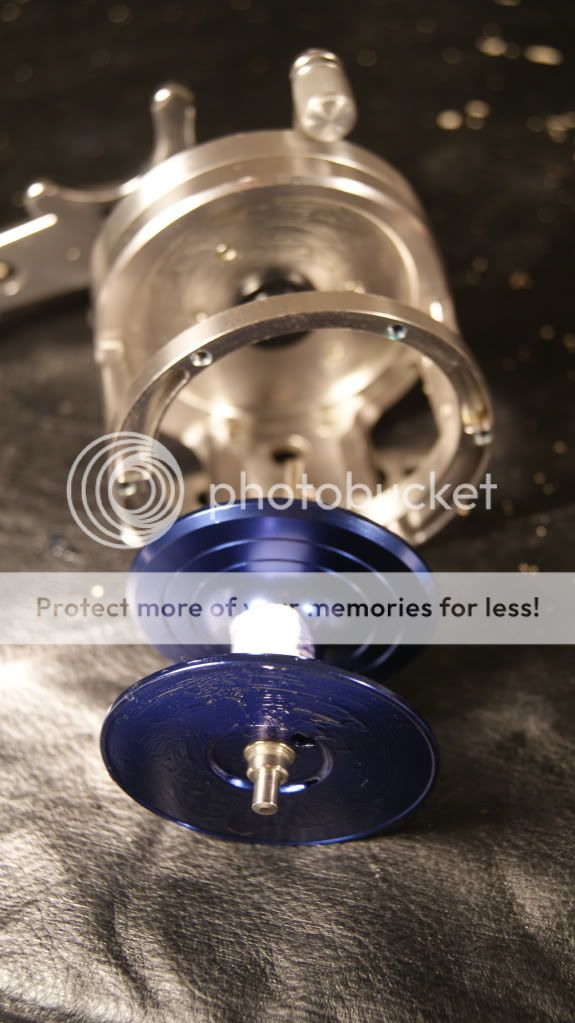

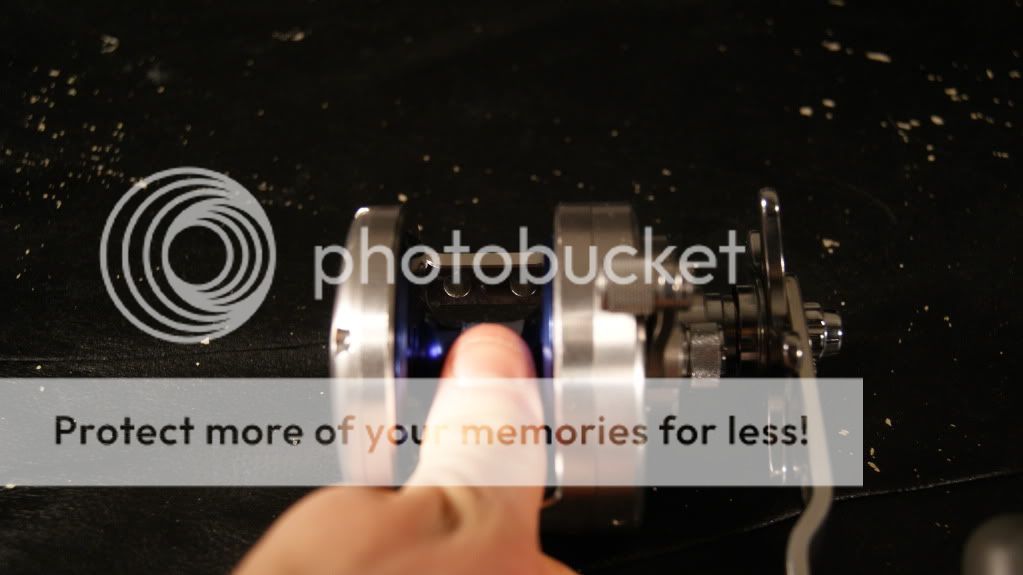

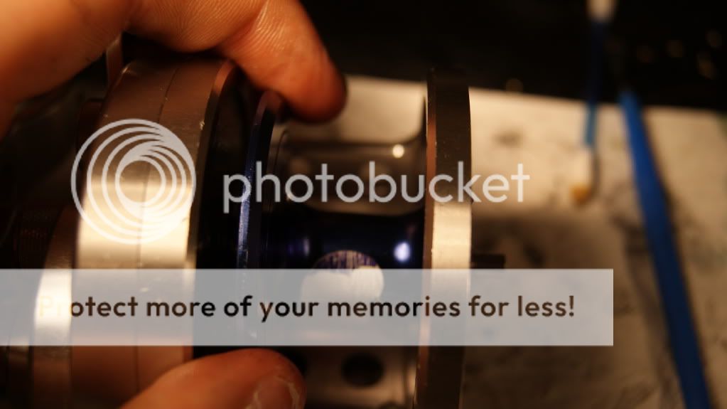

Left side frame is now done, let it rest, while continuing removing the spool (It slides out easily)
now do as you did with the left side frame, paint the spool with a thin film with yamaha grease

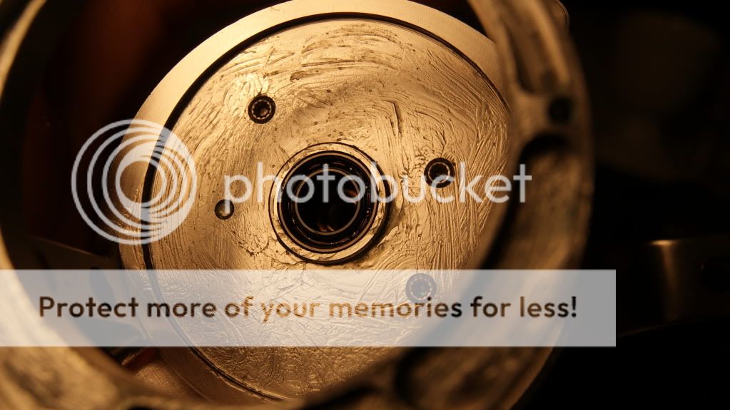

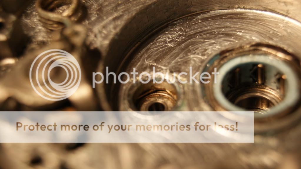

Now, the spool is done, let it rest and continue to the bearing inside the right side housing. Remove the BB-seal and remove the bearing (this was also opened from before) Normally the reel would have pressed in shields on the spool bearings, so it goes out anyway.
Now clean and add new oil to the bearing and let it rest.

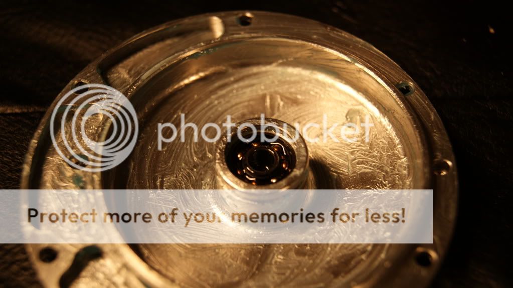

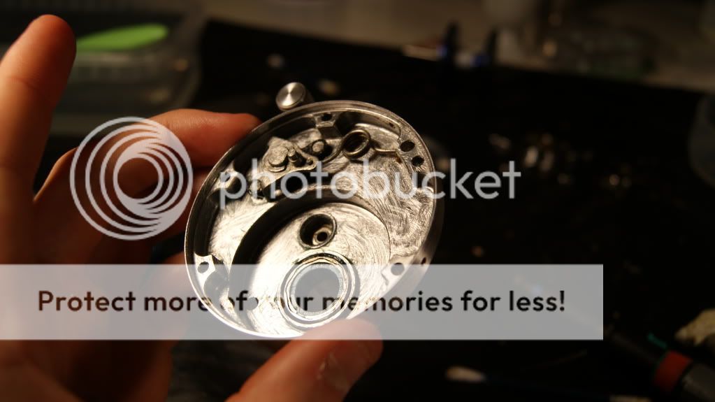

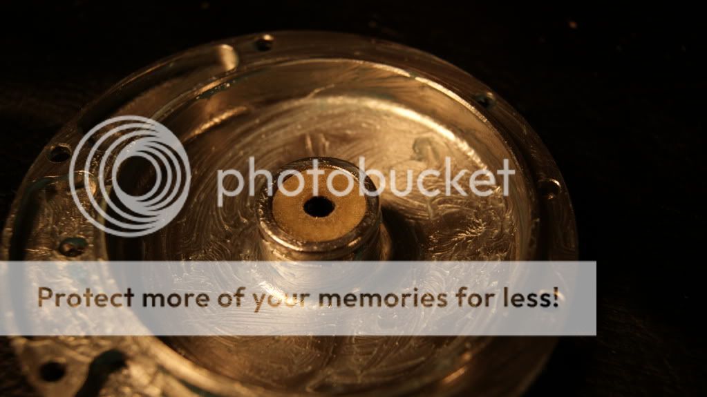

While the bearing rests go on to the inside house and the frames. Remove all old oil, grease, salt etc, and add a thin film of yamaha grease
Now put the bearing back inside and then the BB-seal

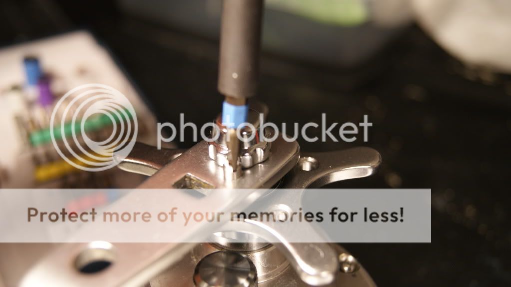

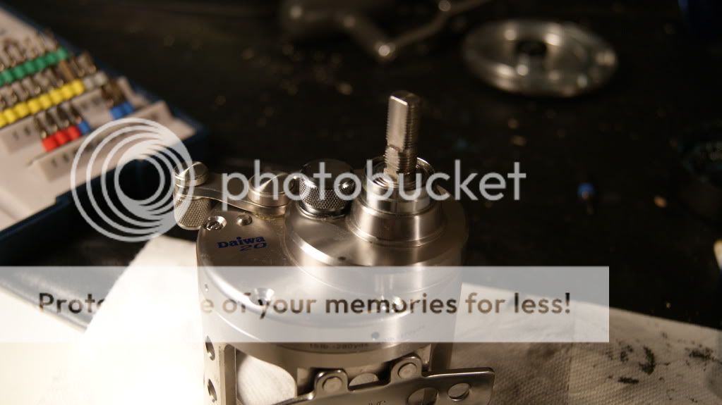

remove the safety screw for the handle nut

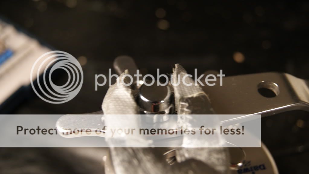

remove handle nut (couldn't find a fitting key so I taped a wrench)

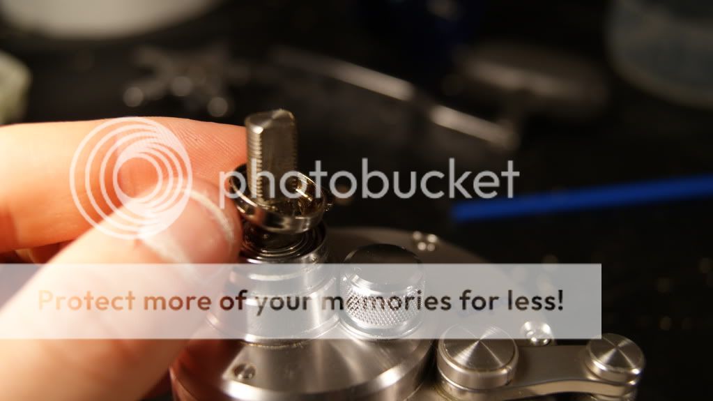

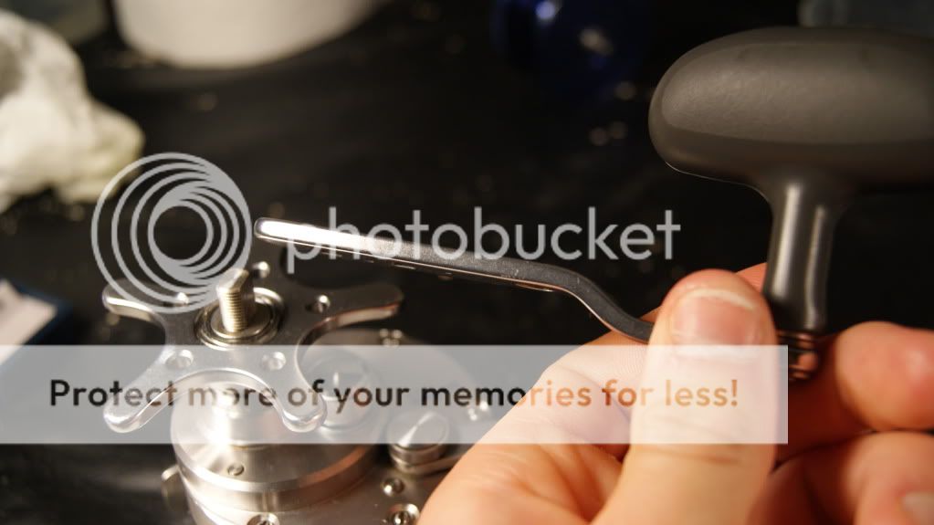

off goes the handle

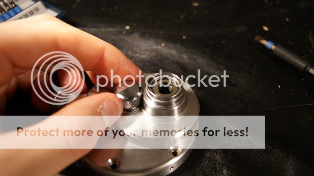

then unscrew the star drag (anti clockwise)
now remove drag clicker

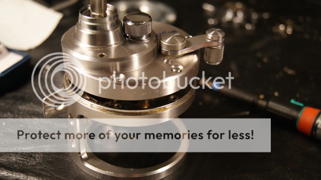

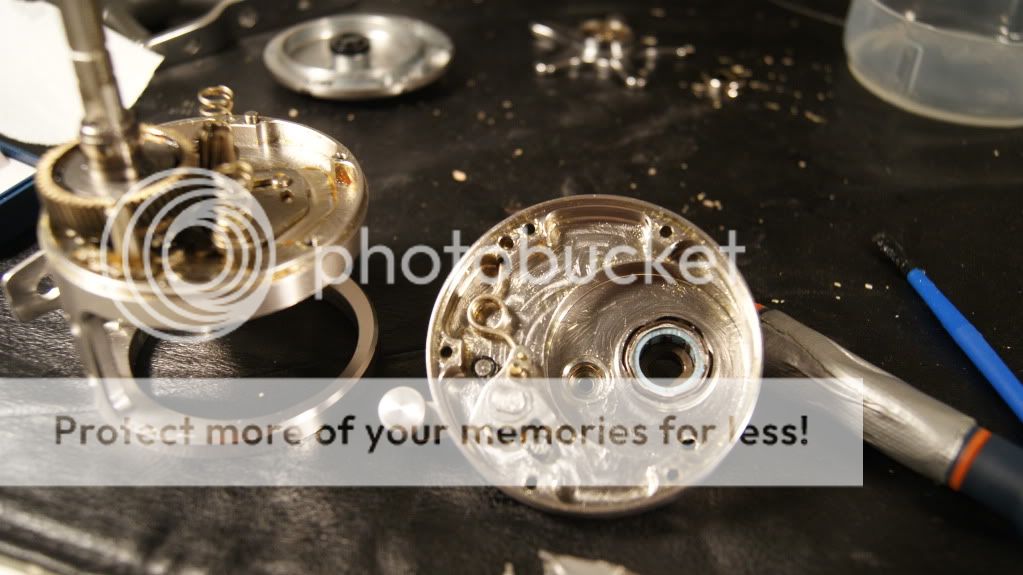

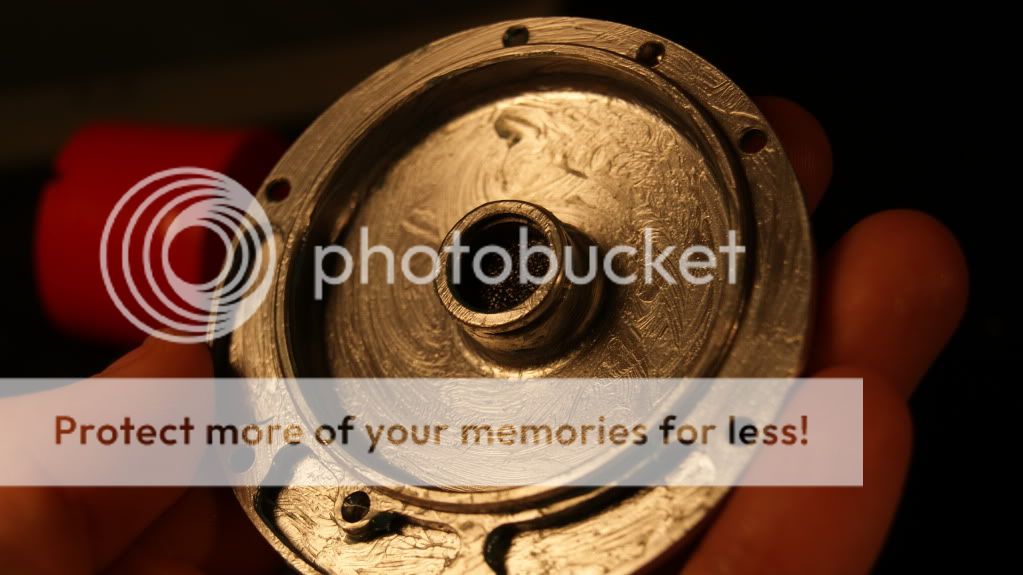

now lets disasemble the right side frame by removing all 5 screws.
The right side frame pops up once the screws are removed
lets clean off old grease, oils and salt and add film of yamaha grease (be careful here since the handle bearing may fall out on the other side)

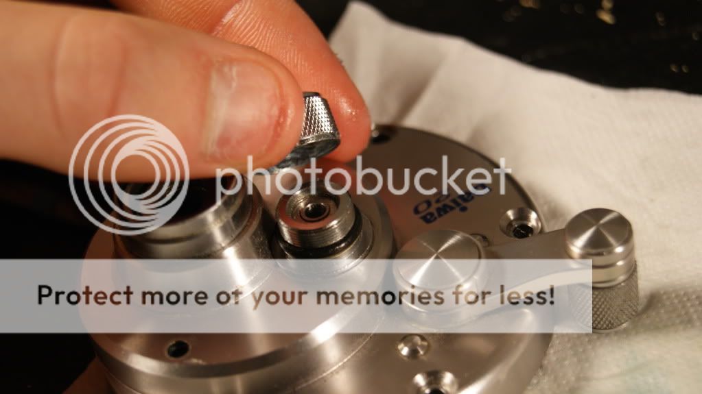

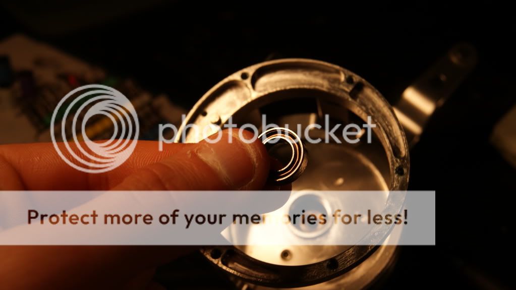

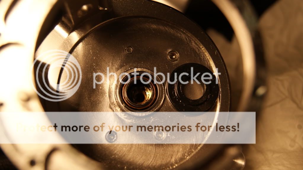

once that's done, move on to the casting recistance adjustement knob. Unscrew it
Now there is a bearing there but you have to access it on the other side, and there is also a small retainer there.

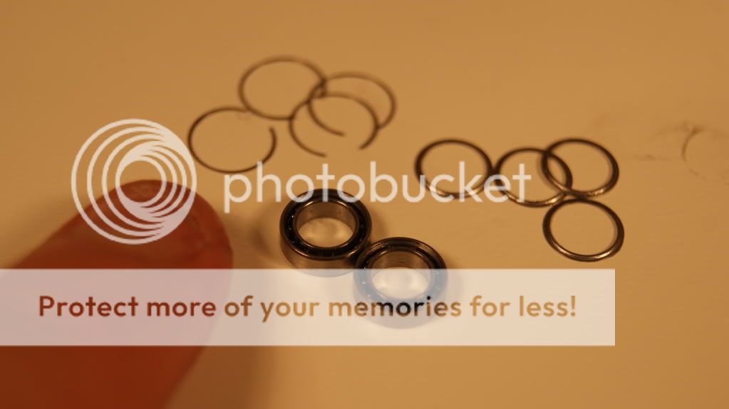

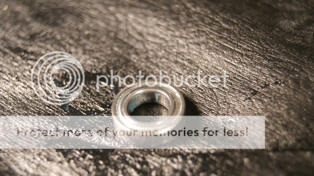

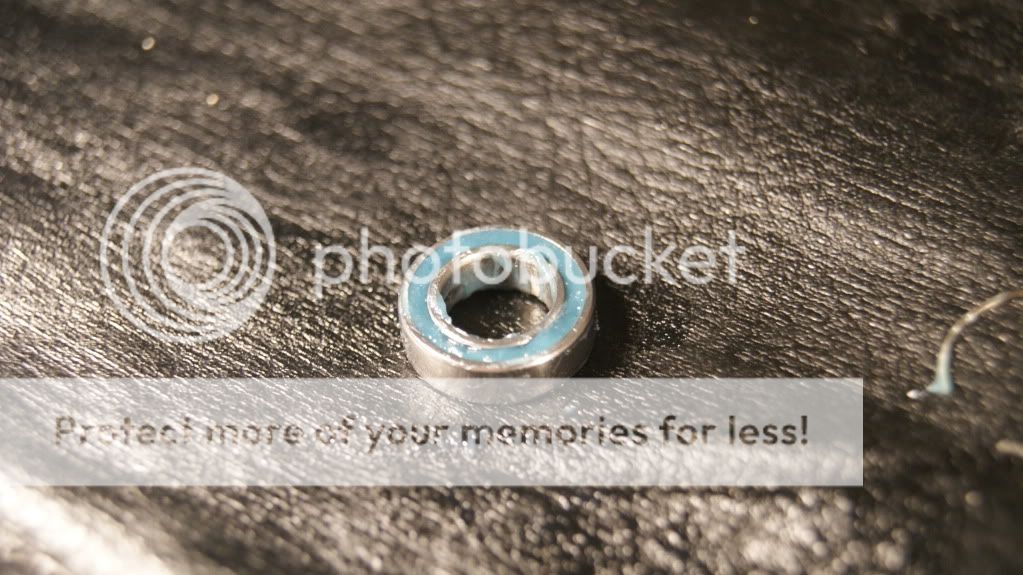

out comes the bearing. Now this is shielded so we need to clean and open it, then pack it with grease

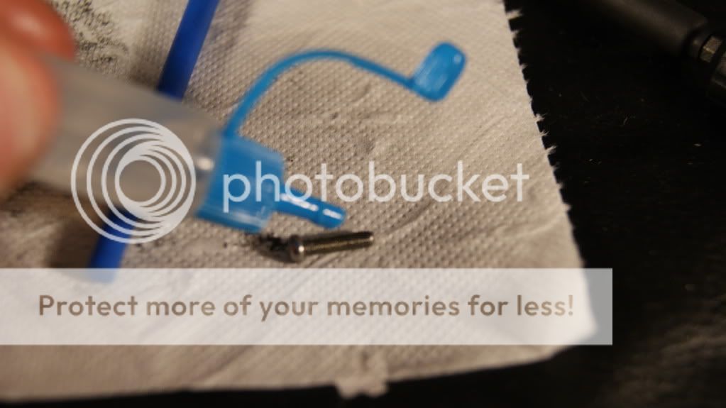

I use a small fly to remove shields with retainers
Now that you have opened the bearings they need to be packed fully with grease. I use yamaha multi purpose marine grease put I mixed in some shimano oil for a lighter concistency (the reel will be used in very cold weather)
add the shield back on and the bearing is done and ready to be put back in to it's housing (remember the retainer)

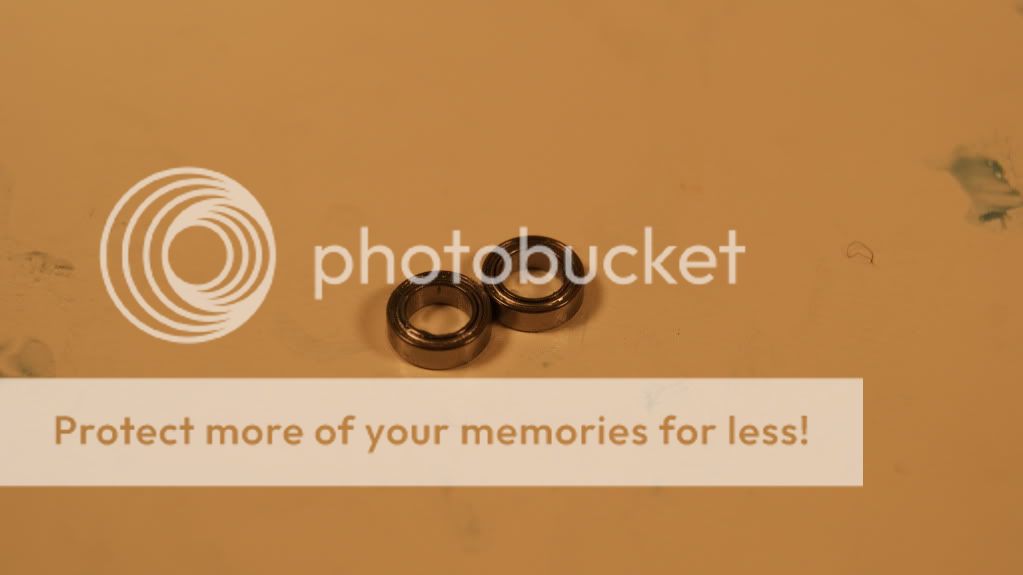

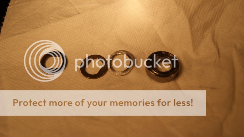

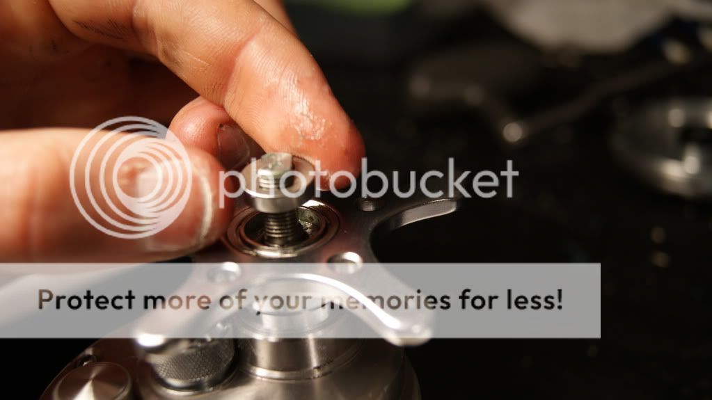

Now let's continue to the handle bearing, remove the two bellevilles and the bearing protection washer (Funny how you find words for thing's you don't know what's called :D)
remove the shields and pack it fully, then put the shields back on.
put the bearing back into it's house, and the right side frame is done!

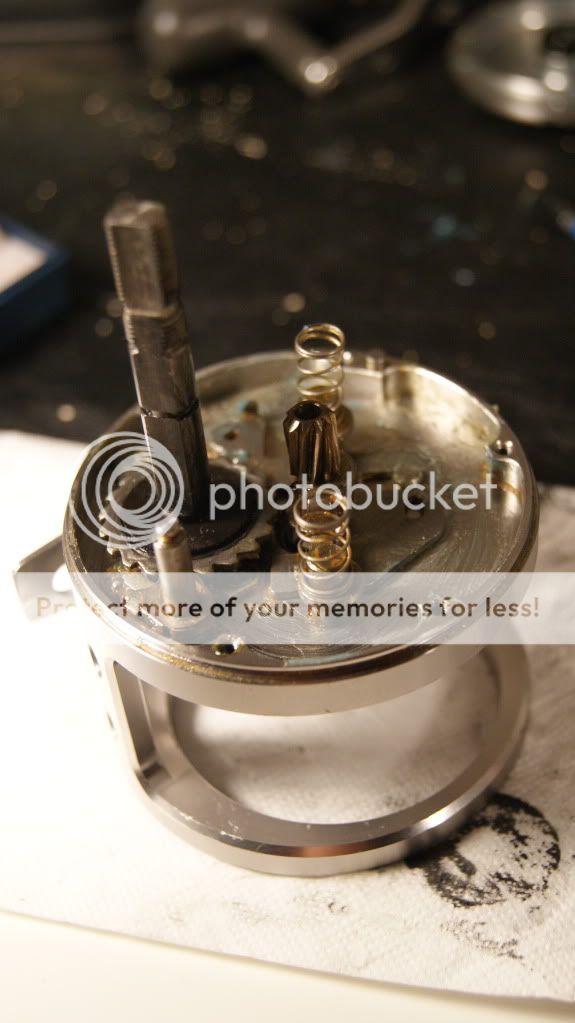

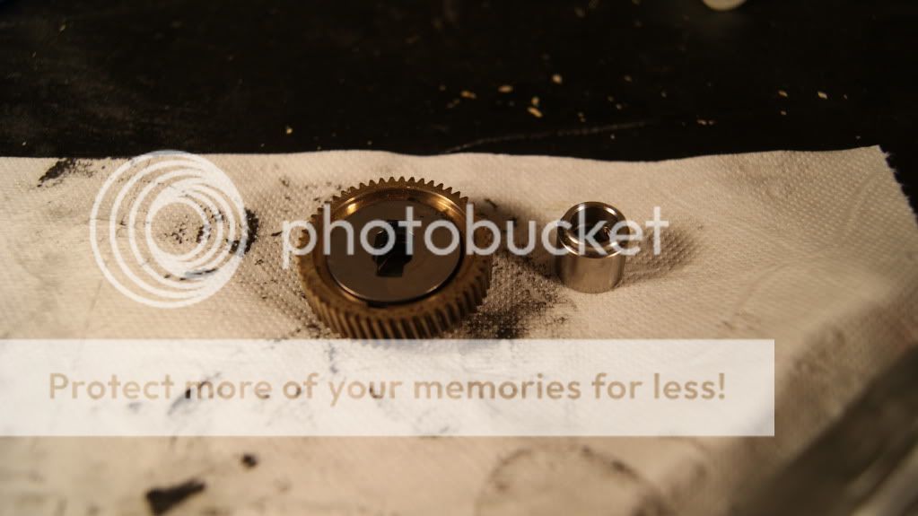

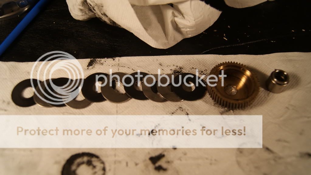

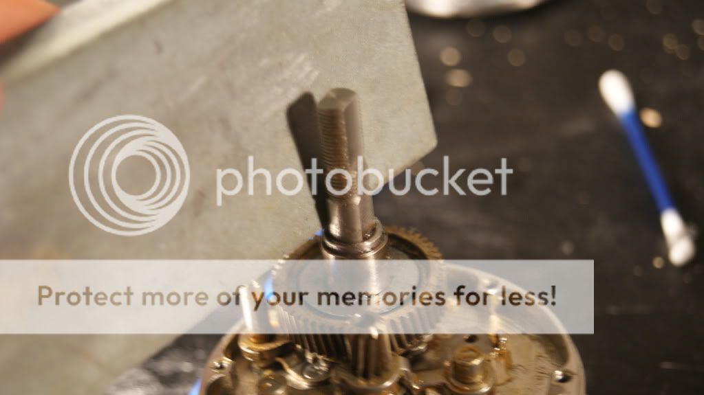

Now onto the drag and gears. I saw Alans tutorial and had the same experience, the fitting here is extremely tight, Just grind carefull to get some more space.(careful)
Out goes the main gear and drag stack with it

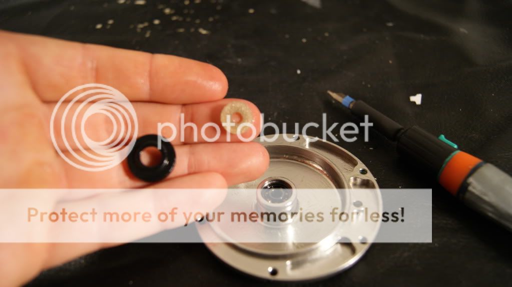

Now remove all metal washers and unfourtunately teflon washers (I believe) and clean them. Mine were extremely greasy and nasty. I am leaving them dry until I can get some carbontex.
now clean the surfaces, pinion gear etc, and add new grease
Now put the main gear gear back (should be easy if you have grinded a bit)

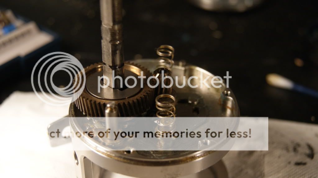

Now allign the rigth side frame to the main frame: allign springs, pinion gear, main gear and screws.
Now we have seen the worst case scenario when the frame cracked on the saltiga when using grease. Let's use some light oil. This time it is the shimano oil
screw it back (easy does it)

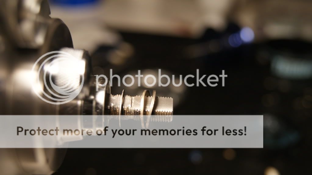

Now I realligned the Bellevilles since the drag was pretty steep. To my desperation, the bellevilles are totally deformed....:( Need new ones!. I placed them as much   )(   as possible...

place spool back into housing

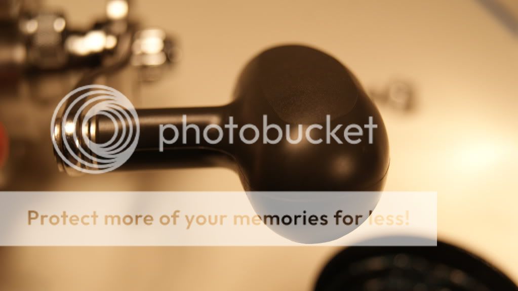

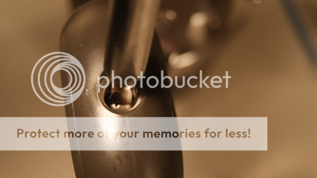

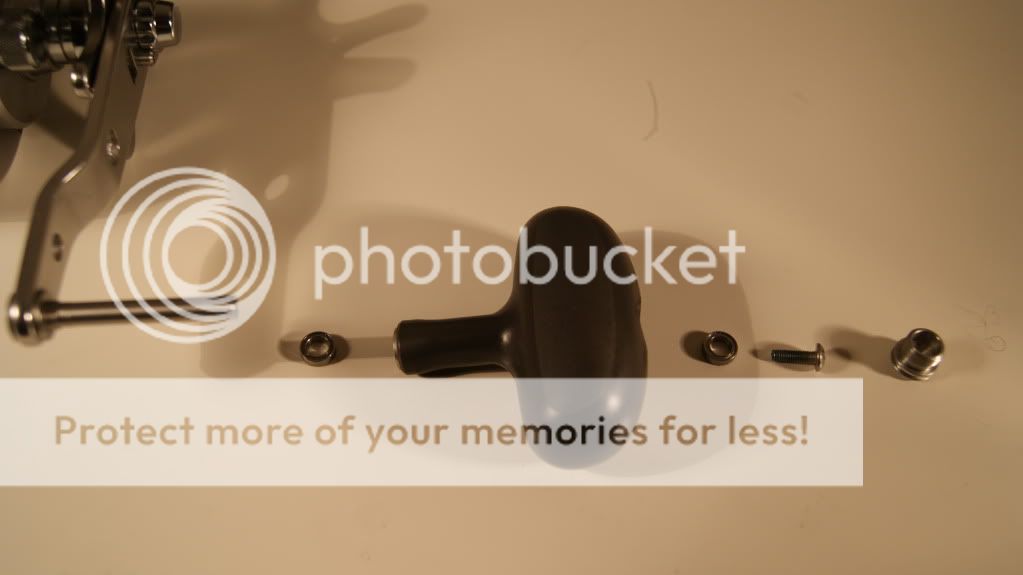

We have to do the handle knob and the bearings inside.

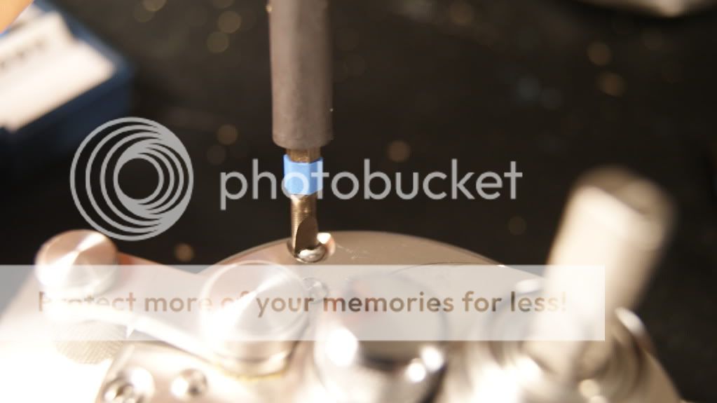

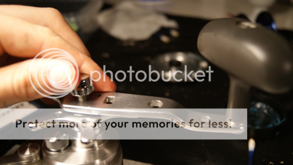

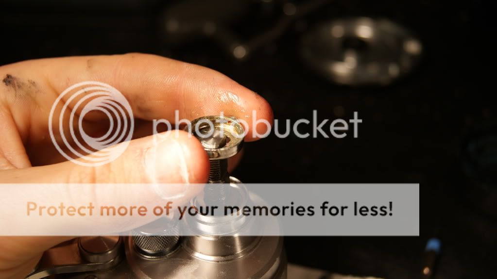

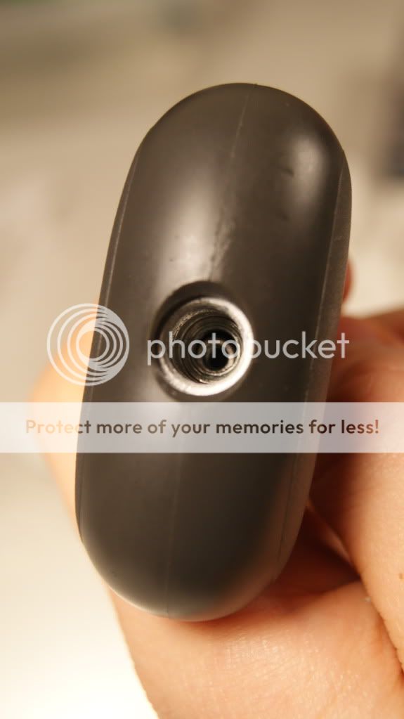

Remove the screw
Remove the screw inside the handle knob.

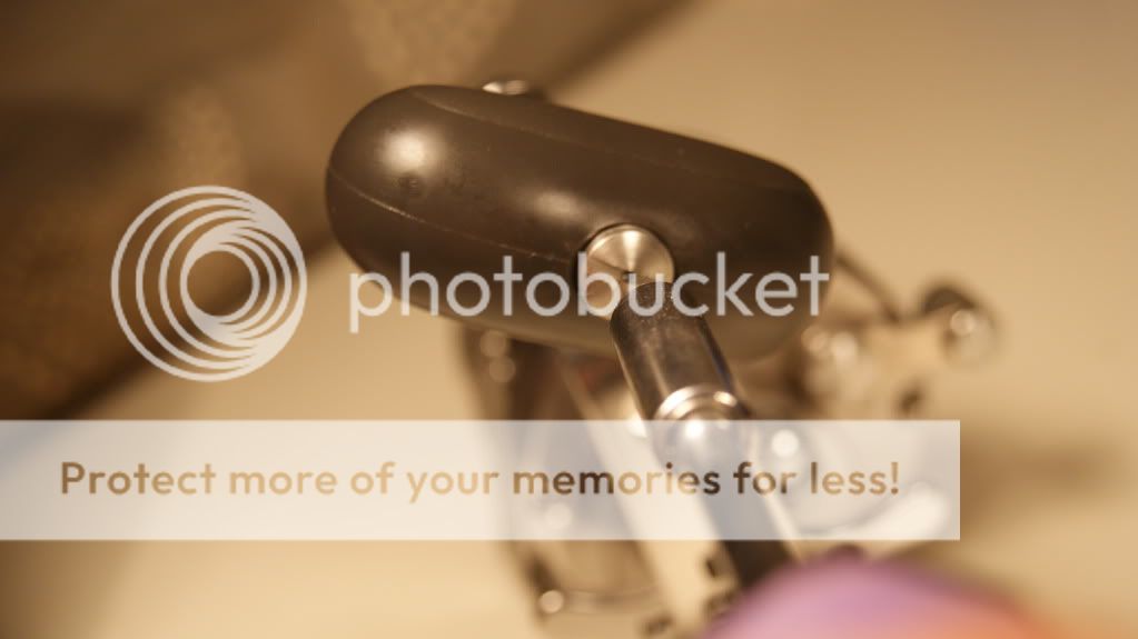

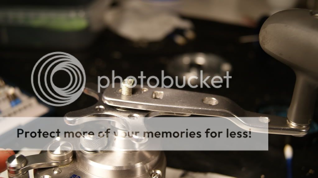

Here you can see the alignment

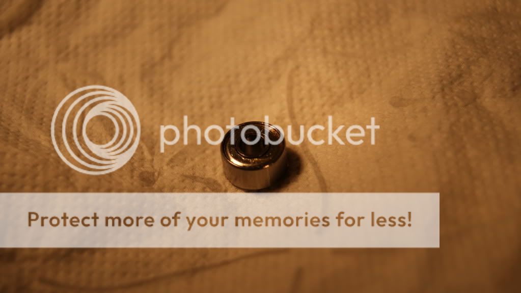

remove the shields and pack the bearings. Then put the shields back on

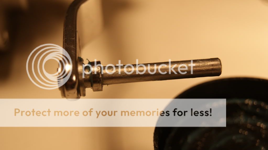

grease the handle shaft and add the first bearing (goes all the way back)
add the handle
put the second bearing back, you have to fiddle a bit to fit it to the handle shaft.
Once that's done its just to screw back on tight

     Also, check the orientation of your bellevilles )( because Alan's tutorial of the 30T shows them (). I positioned mine like Alan did because that's how they came out of the reel, and this reel was never opened.
