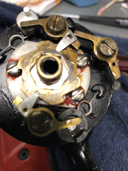

I still have a lot of polishing to do but I couldn't help myself. I wanted to see what it'll look like. This is gonna be worth it.

This has been done to the Penn 750 and 850SS reels for years now. This way you have 2 silent dogs on all the time. It also eliminates accidental turning both dogs off by the rear lever. To make the reel go backwards you have to turn both levers off.
I should have 2 of the clicking dogs in SS. Maybe the ratchet too. They used to be able for purchase here on the forum with the 16 tooth SS ratchet. It made the reel so loud most did not use it. It's nothing new.

I've thought about it. My concern is that there's likely a reason Penn went with only 6 teeth on the stock ratchet. And that reason is that brass may not be strong enough for smaller teeth with any kind of longevity. So the answer may be that if I make it out of brass I'd need to make several and be ready to swap them out.
The other concern for manually cutting my own ratchet is that if I do a double sprung setup the dog and the teeth will rub constantly during rotation. If I use a steel ratchet and brass dogs, the business edge of the dogs will be worn down fairly quickly. So I would need to cut steel dogs as well.

jurelometer
Quote from: JasonGotaPenn on September 10, 2020, 02:17:20 PM
While it is important not to dismiss the possibility that something that looks goofy in a design was done for a good reason,  it is also a mistake to give too much deference to the original designer.  The more complicated the design, the more likely that screwups will occur.   But it  happens all the time on something as simple as a fishing reel.  For example,  Penn screwed up the dog and pawl design on the BajaSpecial/US Senator line in a very apparent way.
Alternating dogs will split up the wear.   Remember that the big Penn conventionals have a brass dog and pawl system that is on the wrong side of the gears (gear ratio increases the load on the dog), and the pawl is on a shaft that is not well supported, so alignment is an issue.  Dogs wearing out is not a major issue with these reels.
Not using too strong a spring tension will help decrease wear, as will rounding the pawl tooth tips.
I could be wrong, but I don't think that brass is going to be that bad.  But if you are going to get them cut with a waterjet,  might as well go stainless.  316 would be the best choice, but 302 is frequently used.
Also, there are a couple reasons why silent dogs would probably work better with bigger pawl teeth.   But I don't want to get off track here.

JasonGotaProblem

very true. Having a very limited amount of metalworking knowledge i have a tendency to assume that there's a valid reason someone who knows more than me did things the way they did. Not always true.
Quote
Yeah but it would double the noise and the load on the individual dogs and lessen the strengthening wffect of going to double sprung dogs. It would decrease handle play though which would be nice. Could be easily achieved by going to an odd # of teeth.

You mean on these SS models or the big conventionals? I've generally heard that the dogs are the weakest point on these reels and do wear out. It's likely I'm misunderstanding what you're saying.
Quote
If I cut my own from steel I'll be rounding the tips a bit for this reason. 316 steel washers exist in the right size to minimize the cutting I'd have to do. Turns out brass washers are available in that size too, but a bit less common. I may go that route out of sheer laziness if it's that much easier to cut, AND i dont need to worry about corrosion. Maybe I'll split the difference and go to a 12 tooth brass edition.
Absolutely all of these options involve making my own springs. As such I will likely try to go as light as i can while still making them work. I suspect a strong spring will be felt in the force needed to turn the handle. Likely not a huge difference but I'm assuming it will be felt.

If i get them waterjet cut I'm going titanium. The difference in material price between that and steel is less of a factor than the minimum order sizes I'm running into (more on that later, I may try to rally the troops and put a larger order together but lets not get ahead of ourselves).

jurelometer
Quote
Conventional star drags with gear sleeves have a problem keeping the handle shaft straight.  This  causes gear shredding (the predominant case) and can cause dog failure ( I believe relatively rare for most Senator models, but the reel repair experts can correct me).  At any rate,  stronger dog/pawl materials don't help much, if you have angled the pawl above/below the dog. Sticking more dogs in doesn't help much either.  The gear sleeve is the weak link on these reels.  For the reels with well supported dog shafts (i.e. screw through, not peened in posts), the dogs hold well.   None of these design issues are very relevant to you spinner other than dog post support.
I have fished completely beat down 113H reels used for commercial rod and reel fishing, where the handle is loose, the gears are grinding, you have to slap the sideplate to get it to go into gear.  Just about everything on the reel worn out, but the dogs are just clicking away, same as day one from the factory.
As I mentioned before, having dogs work in unison may not be the strongest option.  Has to do with elasticity (or lack thereof) in the dog system, and the acceleration gained from additional backplay.  Acres of threads on this topic.
Not much on a big reel like this.  Lighter springs means that you might not  have to hand out earplugs :)
Haven't worked with titanium.  If it is annealed, it is in the soft side, mebbe too soft for your purpose.
BTW most brass is less saltwater corrosion resistant than most 300 series stainless steel.
