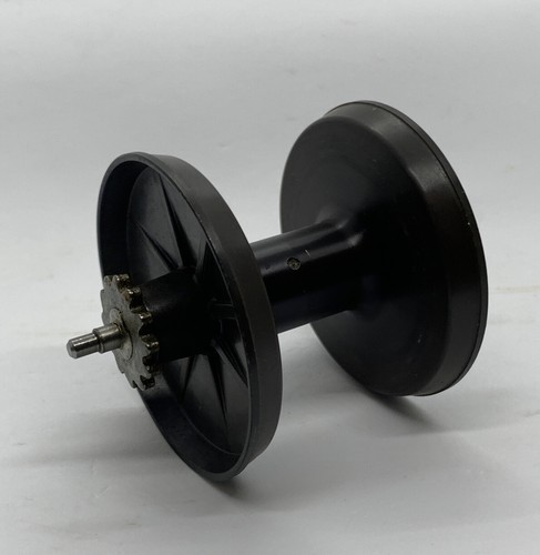

So yesterday I picked up a minty Squidder that's pristine inside and out.  Fulla nostalgia.  It's got a metal spool that soon will be replaced with both plastic and aluminum versions (thanx Randy!).  The drag washers are already replaced with better ones and I'd probably want to load it with 20# mono and a 40# top shot.  But, if one wanted to get some measure of "more distance" out of it, without a major makeover, what would be best to do, if anything besides proper bearing oil?  Go to braid?  (I don't like that dangerous stuff, just my old ways).  New bearings?  Lighter mono?  (I fish for whatever's running, fluke, skate, bass, sand sharks, blues, sea robins, whatever :)  and use aerodynamic "Sputnik" sinkers that I cast up and build for "8 and bait" sometimes along with an IMP).  Mag it?  Or maybe just leave it be.  Hmmm.

Clean out the bearings and lube with tsi321. Polish the spool shafts and inside the pinion gear it reduce friction. Make sure the reel frame is square.
Magnets will slow the spool down, less birdnests but less distance.

You should get more distance because it's thinner much like you would using thinner mono. The potential is there for massive bird nests with braid so personally I have a mental block and don't swing for the fences so much. Very important to keep the line wet so you don't burn your thumb
There's no way I'd ever get more distance out of a squidder without magnets.  Without Ron's good thumb the only way to control it is the cast control knob.  Proportional braking (magnets or centrifugal) is always better than straight friction braking.
The problem I had magging a 146 with aluminum spool was finding enough space.  The squidder is naturally so "hot" that it needs a lot of braking.  That means a lot of magnets.

whether i actually use 'em or not, i'll set up the squidder for static mags, i don't see it being all that difficult, and i've magged 5 or 6 other reels already.
kj magnetics has the perfect thin sizes in the stronger n52 neodymium flavor, too.
