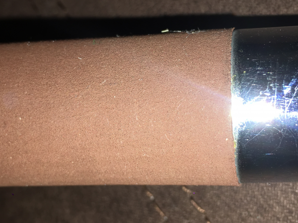

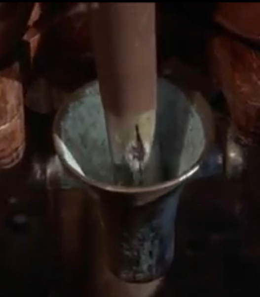

Once you see the rubberized butt that I am talking about and you know what to look for, you can tell its the same butt is in the film. Its easily mistaken for wood, but its not wood

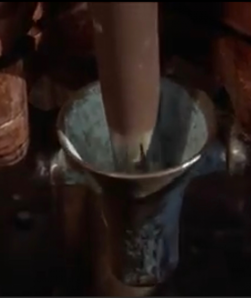

Here are some screenshots of the film. Once I get home I will take a picture of one of my rods so you can see what it looks like in person. Like i said, it can easily be mistaken for wood but its not. You can tell has no wood grain whatsoever in it

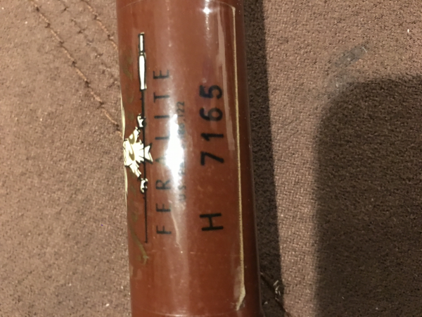

The big game rods cataloged up to around 1968 had cork grips and blonde wood butts. Attached here is a page from the 1968 catalog showing the cork grips and a small picture of the butts. Also attached is a picture of my H serial model 670 dating to 1967-68

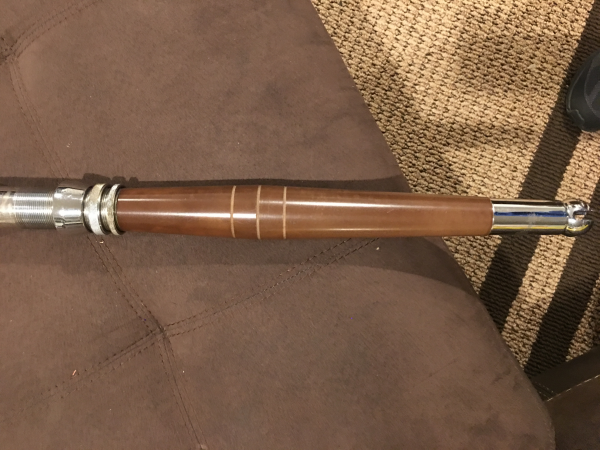

Around late 1969/early 1970 Fenwick announced the "new unbreakable fiberglass rod butts". Attached here is the announcement as shown in the 1971-73 catalogs, the layout seen in the 1973 catalog, and a picture of my J serial 1969-70 model 670 with fiberglass butt

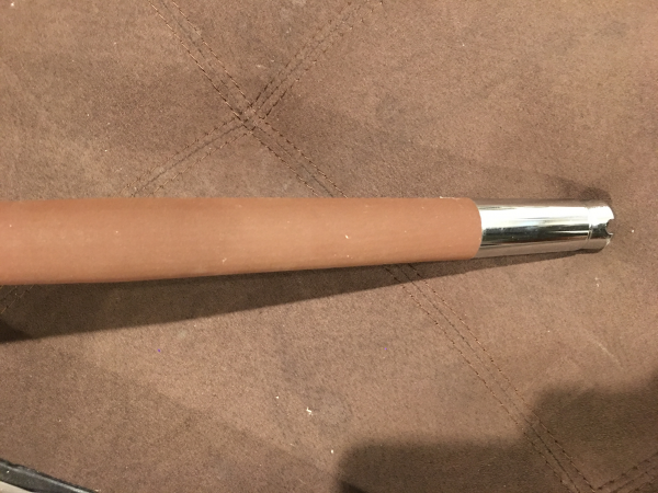

1974-75 brings us to the "Jaws" rod years. Fenwick announces new "hypalon covered stainless steel handle"
Attached is the layout in the 1975 catalog and a picture of the hypalon covered butt of my M serial 1974-75 model 670. This is what the Jaws rod butt is.

If you look at the pictures you have submitted from the movie itself and even back up a couple of frames in the movie at that scene it shows the rod butt has with extensive damage of which looks to be consistent to either wood or fibreglass but absolutely not stainless steel as the 74-75 Fenwick had.
You cannot see wood grain on the rod butt as its painted in that ugly mission brown they loved back in the day.
The stainless steel butt rod was made 74-75 as you confirmed, but jaws was being made in 1974. Its unlikely a rod model made in 74 has entered the market purchased by a charter boat and used to achieve the level of damage and patina as is depicted in the movie all before being lent to a filming crew. More likely an earlier model was used.
The hypalon coated stainless steel butt looks Tan and nothing like that dirty mission brown colour.
Your information on the Fenwick rods is spot on but I am unconvinced the Jaws rod butt was covered stainless steel, there are just too many inconsistencies, the rod in the movie doesn't look wood grained as its painted and faded, it is damaged consistent to wood as seen in the movie frames with significant patina as it was a working rod lent out not a movie prop.
