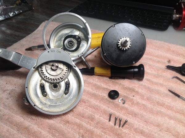

I tore mine down, starting a couple of days ago, suspecting water intrusion after a couple of kayak trips, and took some pictures. Oh well, the "Mean Green" tutorial doesn't have the triple dogs which are interesting. There is indeed more disassembly detail in the M.G. tutorial, so that one can be accessed if needed. Also, I took the time to get all these photos and also I have the time to post it all, so...

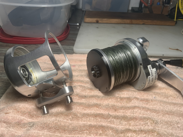

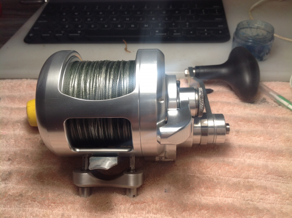

The reel
Note the plastic gear cover with the drain hole in picture 1, lower left side.
The Boss Xtream's{BX2} were the first of this series[year 2000]and featured an ARB and no AR dogs until, of course, the ARB's started to malfunction. The fix was the DPX2 with three alternating dogs, in addition to the ARB. This model has it all for me with the cast control and the clicker, in addition to the two AR systems. There are two models built with no ARB, the DPX2 30D & 30ND. I don't like an ARB in any reel used in saltwater because of maintenance issues/possible failures, and would get the 30D if I could go back and do it again. Mine should be ok as long as there is no binding issues, but slippage is acceptable on an ARB reel as long as there are back-up dogs. This series however did not last long because they came up with an improvement: the DX2—Dauntless version with a synchronized two-dog back-up to the ARB.

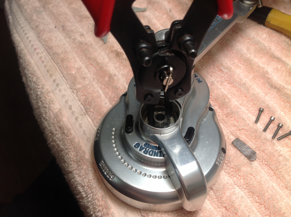

2 things to start disassembly; 1] take out the 4- [T-7 size], tiny, oddly placed, stainless steel side-plate screws{more discussion["bitching"]on this latter}
2] Pop off the black plastic cover on top of the drag lever cam{sitting up over the pinion housing in the pic.} and pull the E-clip from the spool end and separate the two. WAIT THOUGH!, so you don't deform the clip like I did, there are two things to do, to get at the E clip; A} turn the drag range program dial counter-clockwise[tightens the dial exposing more spool shaft, cause of the reverse threads] and then B} push in on the TAIL-PLATE SIDE of the spool shaft, which will give you even more E-clip exposure as the spool shaft moves towards the head-plate side.

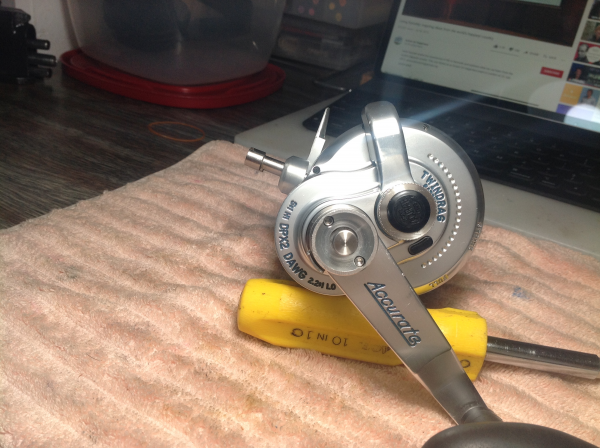

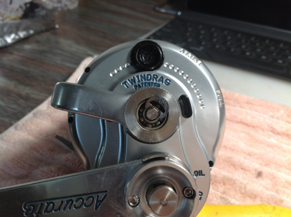

In the 3rd pic. You can see water droplets on the drag cover. Latter-on you can see water under the drag covers and even under the drag washers. My hunch was right!
The gear you see on the spool shaft is the 2-speed pinion. And there's that carppy plastic cover on the back side of the head-plate, 1/2 covering the 2-speed main gears.

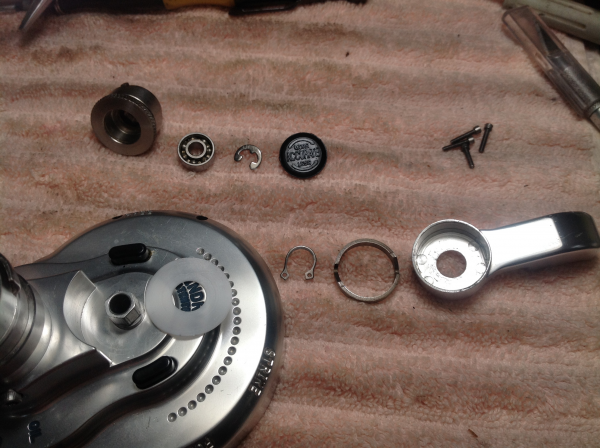

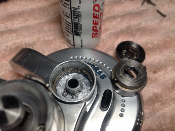

Drag lever and cam disassembly.
1] unscrewed the drag program dial out[reverse threads] of the cam[upside down in picture}. You can see the cam track in the bottom of the drag lever.
2] snap-ring pliers to remove the drag lever.
3] all the parts(drag program dial and can reassembled)
4] the drag lever detent. This can be removed and there's a spring under there if you need to lube it. Also, I need to remind myself that the handle knob has reverse threads, but I used stupid wording, it should say:"to loosen—turn clockwise".  I'm just the kinda guy, though, who, without a reminder, would reef on it without thinking, until it strips/breaks.

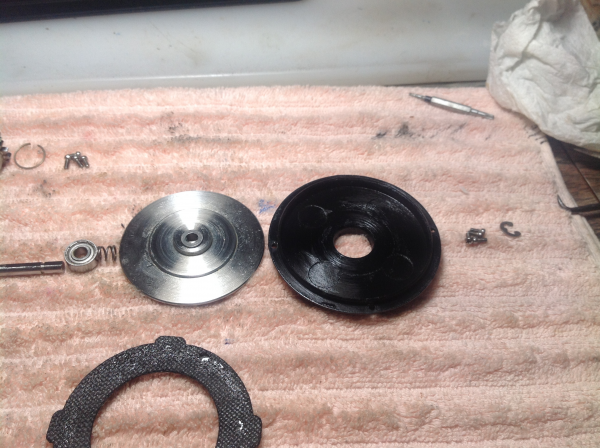

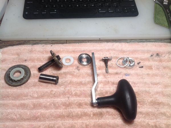

1]Two speed shift mechanism, handle, gear shaft/low speed[2.2:1] gear, high speed gear[5:1]. I believe the white washers are made of delrin.
The 2-speed shifter was difficult to reassemble.

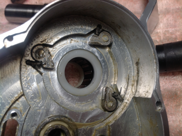

2] inside of the head-plate with the 3 dogs. Getting the AR cog [on the high speed gear] down in place with all the dogs positioned correctly, was also difficult. Note the ARB. It looks to be all steel and there's a thick delrin bushing on the outside end, and a thinner delrin bushing on the inside end. Not gonna remove the ARB as it is press-fitted in. Put some lite oil on it. If I needed to clean it, I would plug one side with a cork, and spray in inox or another suitable cleaner, flushing until no more discolored fluid comes out.
3] the buttons for the free spool and the strike positions. I'm seein too much plastic here for a reel this expensive. The only metal parts on these button assemblies are the springs and the screws.

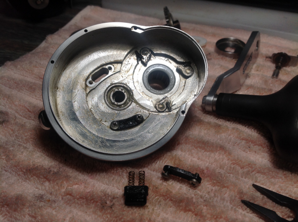

The single piece frame/tail-plate: The moving parts and fasteners are a combination of metal and plastic——WAY TO MUCH PLASTIC! A plastic click spring, pawl and a cir-clip for the cast control knob{so it doesn't screw all the way off}. 2-friction washers for the button and 1-for the pawl. All the rest of the parts are metal.
The clicker POPS! It"s loud and strong. But, I'd prefer metal parts even if they were quieter and weaker. Aside from the plastic cir-clip on the cast control system, it is a nice heavy-duty unit.

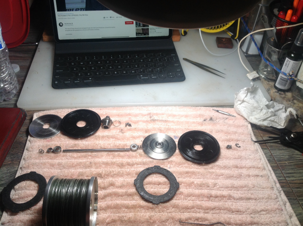

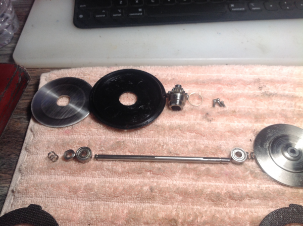

The spool/axel system: 1] spool ball bearings, shaft springs, thrust washers, the 2-speed pinion, pinion bushing, plastic covers, pressure plates, drag washers and various fasteners. And I like to watch/listen to U-tube videos as I work.
I still can't figure out exactly how the twin drag system moves parts on both sides of the spool, so that the drag washers are contacting the pressure plates. Getin it little by little...
2] water got behind the right side drag washer and you might be able to see some on the spool.
3 & 4] close-ups of each side.

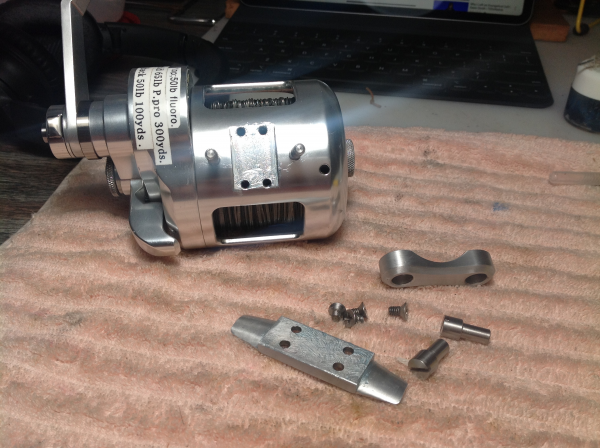

Gotta do the reel clamp as it can be a salt magnet. Also, there's stainless steel touching aluminum. Notice the drain hole on the right. There's another one on the other side in the plastic gear cover.
