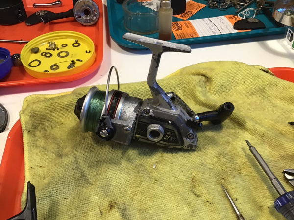

Good friend wanted me to restore his best friends old salt-burned Penn Silver Series 103 spinning reel.
When it arrived from the East Coast — it required a phone call.  If I restore this for you — it will cost more than the reel is worth.  Why not just buy your friend a new reel?
"No, he grew up with this reel, it caught many fish — and I want to do this for him.  Sentimental reel.  Can't you paint it for me?" — No, it is too badly pitted, and the plastic on the sides will still be lousy and salt damaged.
OK, your the boss — I will install a new frame, sideplate, rotor, spool, crank handle, and main bearing.
I pulled the parts out of the bins — and went to work to do a complete cleaning of the smaller parts — along with starting on the exterior change-out.
First issue — bearing cup was too small.  I carefully, and slightly enlarged and made the cup deeper.
Second issue — in doing a test fit after enlarging the bearing cup — I decided to check how the side plate matched up.  Perfect fit — but Penn forgot to drill and thread the holes in the frame for the screws!!??
OK, drilled holes, and tapped screw threads into the holes.
Reassembled the rotor, AR assembly, installed the rotor onto the frame — inserted the spool shaft only to find that the support for the spool shaft at the middle of the frame was not drilled out either.
OK — crossroads time — yes, I can drill out the hole in the frame shaft support — but what else am I going to find out about this obviously missed in Quality Control frame?  And do I want to put my name and reputation on this reel?
No...
So I just pulled out another frame from the parts bin.
Lots of time, Labor, and interesting frustration.
These old Penn Silver Series 101 - 102 - 103 - 104 - 105 are decent reels.  Not as good as the Spinfishers — but similar to the Daiwa spinners of that era.  They are made in Japan — and are made well.  This was a complete blindside surprise.
Just a part missed in the Quality Control inspection.  Very rare for Penn.  I have pulled out screws that were not threaded, or AR dogs not drilled — but never a large major part like this so poorly manufactured.
Onward and upward.
I will post photos when completed.  For now, I have moved on to some other reels so at least I can get something accomplished today.
