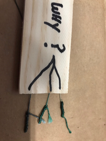

   Below is another actual shop test.  45# held for 2 minutes.   Here's the picture.   Tag of loop starting to walk.    I don't know if this would cost me a fish 🐟?   Constant strain may change the knot?
    Butt it makes a quite ride back home.......   as many of you know......🤞

The Alberto is a good knot and has merit for my desire to find some fresh fish to eat.    Below is some recent testing and all these broke before my knots tied in a chain with other "many twists " knots.
  More on this soon.   Remember I,m just trying to learn and keep your minds busy until you can go fishing as we did hopefully again.......? ???
