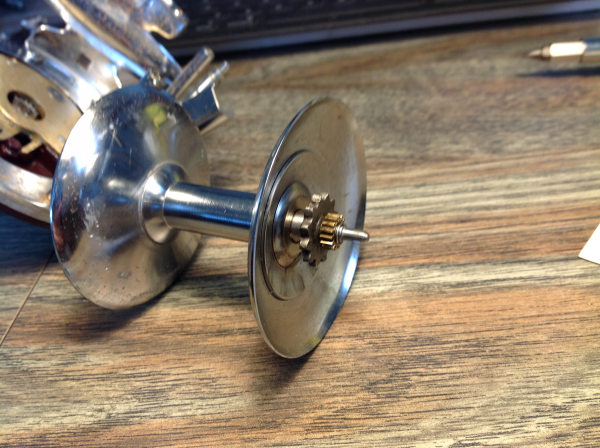

This one came on a well used, but not abused, 309. I think it could be the wrong spool. There are no numbers on it.
Got it to spin well, even when tilted perpendicular, by using a delrin dot and ss washer as shims, and it's as centered in the frame as I can get it. However the way it's slightly too long for the frame might cause it to eat any loose loops of line.
Don't know how to transfer a picture from the Mystic parts site, but the 29M-309 is called a "chrome on bronze" spool, and has a band and pin right in the center of the arbor. What's this one? A 3-peice stainless? And what's it go to?

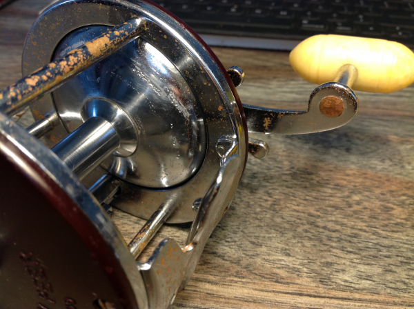

1) & 2) big gaps between the rings and flange edges

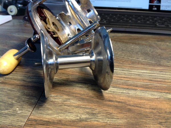

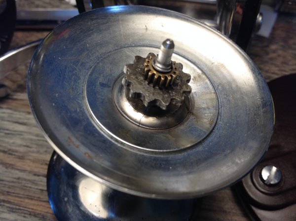

3) & 4) the spool, note it has the levelwind system gear on the tail-plate side(pic. 3), and does engage the idler gear perfectly, when assembled and spinning.
This mystery levelwind spool is as wide as a 29M-66, but not as tall( the 309 uses the 30-66 stand). Also there is crack all along the arbor, even behind the flange attachment and one flange has a slight wobble when spinning. The right 29M-309 spool from Mystic is "no langer available".
Do I gotta spring for a $30 aluminium spool? I won't donate this reel unless it's right, don't gotta be perfect, just "right". For example, it came with some black fiber drag washers that don't function well, but I'll leave those in. Never seen those in a Penn before.

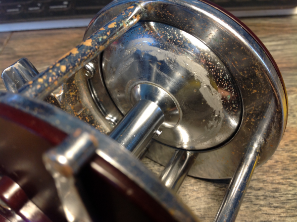

1) compared to Long Beach 66 spool, same width, but different height and diffrent arbor thickness
2,3&4) the crack, look close.
i think that it's the original spool, but it's blown out.   :-\
Ok. Sounds logical. The LW assembly at some point was removed, maybe damaged too?. Prolly wrong about it not being abused. Blown out spool, a first for me!
   I agree with you G about not spending much on this one. Another option is parting it out. That old boy may have a steel main gear...and steel Jiggy gears are getting harder to find. 8)

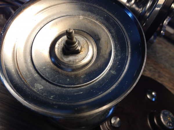

Ok, #2, Slight variation of the same issue. Got a full spool of 30lb. mono off another 309 spool and found a too big gap again between the side-plates and the spool flanges. No stress fractures when I de-lined and removed it. Again, one flange with a slight wobble.
So, the flange on the gear side spins on it's own with a bit of friction. The revolving flange will move as a single piece. Also that 1/2 as big in diameter inner flange on the spool shaft side will also turn by itself, with, or independent of the main flange(check pictures).
You can see that this one has #'s; 29-309, unlike the first one. These 309' s came out in 1966, wonder why they all don't have numbers? Love to find one of the old, heavy, one-piece chromed brass ones.
*What type of Penn spool is this called? I'm guessing; "Stainless steel-3 piece"?
*are they pressure fitted/peened together? If not, can they be unscrewed?
*can they be fixed?
Maybe the 309 isn't conducive to this type of spool. I think with both of mine, they got wound-up too tight with the mono.

In that case you might be able to
Drill a hole in piece of 1/4 thick Sheet metal  where it clears the Gear /gears and slap it in a Press and press it out then the other side
Re-Flare it  .
Don't know why you are having to shim it though blow or no blow would not change the shaft length me thinks.
Thanks WC. The edge of both of the arbors to the inner plates area has too big a gap, i.e., the abor edges are to far inside the frame. The main deal with shimming it, is to get the line to "levelwind" onto the spool---no glaring build-up or depression areas. I shim the levelwinder worm and the spool.
Ok, godda think about those; flaring it or pressing it. Got no experience with either method or much patience, but I'mina try...This is FUN!
