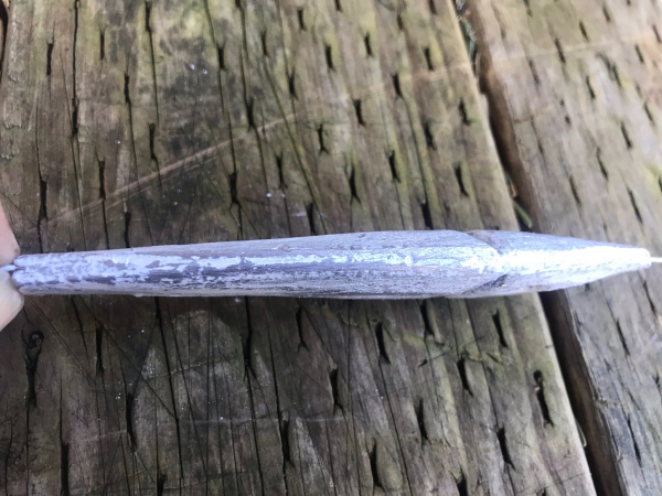

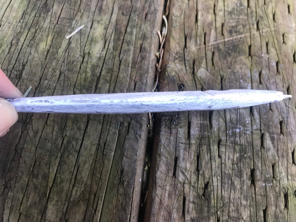

Here's another raw one from the silicone molds that I was able to make during the winter.
   The original pattern is from a wood carving that I made while visiting in Oregon for a while.
Soon it's getting painted and hooky things, weighing about 12 ounces,  It's called deep six.🎣.
There is a lot of potential in that one Gary.....looking forward to the finished product....Bill
Gary, get your airbrush going and show the finished product.  Dominick

Looks good Gary.
A couple thoughts:
You might want to test drive the jigs to see if they fish better upside down.   The center of mass, and significant weight farther from the center of mass ( moment arm, kind of like a keel on a boat, or too much gear stacked on deck) will determine the orientation and  action on drop of the lure with no line attached.  Drag from the line can change the drop, either passively, or intentionally by slowing the decent and keeping the nose up.
Not too many drop jigs have a copy of the natural fish shape in three dimensions.    Folks want to pull the jig forward by the head, but it will usually want to flip around and drop head first, which can cause tangles with the line, and a U-turn action on the drop and lift.  Most successful drop jigs either fall sideways ( crippled herrings, flatfalls) or  bottom first ( Norwegian jigs, knife jigs,  that jig that I sent you).   But you never know for sure unless you try it.
In terms of paint,  you already know what I think about fancy colors and paint jobs vs. the science of fish vision.   But who can argue against having a little fun if the fish don't mind? Last time that I checked, this whole recreational fishing thing was supposed to be about having some fun.
