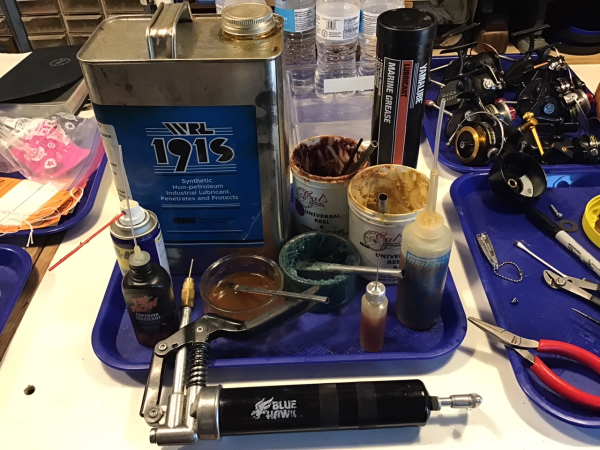

When you want a little more free movement and a little less restriction. It also helps free things up in cold weather environments.
Like a Chef — Lubrication recipes can be varied to suit the intended usage.
If fishing the salt with a conventional or a HD spinning reel — mostly 100% Yamaha Marine grease for nearly everything.
Gears, bearings, eccentric, jacks, yokes, screws, under the rings, etc.  Exceptions where oil is used would be the A/R dog, spring, sleeve, level wind if so equipped, and crank knob.
If fishing HD fresh water with large spinners — grease for gears and bearings.  Oil or a blend of 2/3 grease and 1/3 oil.
If fishing medium to light freshwater — generally a blend of 1/2 Cal's Purple to 1/2 synthetic oil works really well.  It is more expensive than Yamaha Marine — but the results, performance, long-lasting adherence, easy wash-out with lacquer thinner when servicing, and non-stiffness particularly in cold conditions — are worth it to me and my clients.
It mixes well, doesn't separate over time, and offers smooth as glass performance as well as protection.
Everyone does lubes a little differently — this is just what works for me as reels come off the bench and go back to anglers.
So to answer your original question — oil is used to thin out heavy grease for better overall performance — with particular attention paid to temperature and weather conditions.
I have clients who fish primarily Fall & Winter — and others who fish the colder regions of BC, Ontario, the Yukon, etc. They like the mix of Cal's Purple and WRL191S Synthetic oil for their reels.
