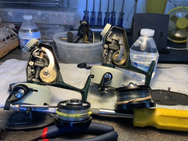

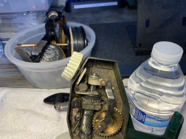

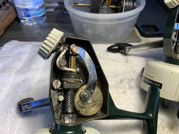

Here's a 6 and 4, I had out after use. Gotta dry-out the rotor cup after FW rinse. Behind those is a Mitchell Garcia 302 mostly apart in the container.(pic.-3). They all got splashed with saltwater, Saturday, then rinsed with FW. The MG is full of emulsified grease and salt crystals😟, whereas the Cardinals never seem to get any water in the gear-box 😃!?!?...
On the 4(pic.-1), the shim is on the top of the ossilation arm and there is pretty even line lay. On the 6(pic.-2), the shim is on the end side of the spool shaft plus I added an SS washer to adjust it for better line-lay. Not great, but it's the best I could do. Note that the 4 has a metal connecting block and the 6's is nylon(?)😠.
Hope you can see it. Tap on the pictures, the shim on the 4 is slightly tweaked. Interested to see what is making that shaft dip so low, or, if it's got something to do with the pinion assembly...
