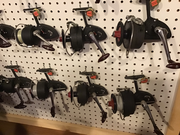

Had eight Dam Quick Super 270 reels to do for various clients this week.
One old Line Counter took all day Monday.
The other (7), including a 275 2-Speed were finished up yesterday and today.
Tomorrow I'll start on,(9) DQ 265 Microlites for various clients.
It is easier for me to try and do a bunch of the same types of reels one after another —- the parts bins are just laid out on the bench —- each reel is disassembled, cleaned with 3 types of cleaners —-  some get repainted, some don't.
Each Super 270 generally takes 15 to 20 parts to bring it back to a very capable fisher.
The trick for me —- helps to steel myself for whatever may be inside the reel.  These are used in salt water —- and generally have considerable salt burn, rust, broken pieces, crud outside and inside.  They are 60 years old, and have seen considerable use.  The only clean ones are the ones that have always been stored and never fished.
These reels weigh 23.1 ounces, retrieve ratio is 1:3, metal spool, excellent materials.
All aircraft grade aluminum, bronze, steel.  Only plastic is the crank knob and the pick-up arm cover cap.
Overbuilt and brutally simple as well as clever.
These reels are cheap to buy and as tough as they come.
Here is the last one done this afternoon.  Before and after.

Looks nice, Fred, as does that 2 speed. All new external parts on that last one? Curious, is there a different manufacturing time line for the rotors with and without the ridge on the side?
Quote from: Midway Tommy on March 31, 2022, 01:33:35 AMLooks nice, Fred, as does that 2 speed. All new external parts on that last one? Curious, is there a different manufacturing time line for the rotors with and without the ridge on the side?
Yes, mostly new parts on the exterior of the last one, Tom —-
Paint was bad —- and I don't have a perfect match for the factory green wrinkle paint as of yet —- plus running out of time trying to get the backlog down —- so I just put on a new frame, foot, sideplate, rotor, and crank handle.  Got plenty of NOS parts —- so some day I will strip the old exterior parts —- and repaint them when I find, or have made a perfect match in the wrinkle green.
As for the ridge around the circumference on some of the rotors —-
It seems to be a mid to later version.  I have around 45 of these reels in the bins —- and some have the ridge, and some don't.  The latest version is the 275 2-Speeds —- and all 10 have a ridge.
So I think it is a mid to later version.
These reels started production around 1954 —- and went on for about 10 years —- 1964.
