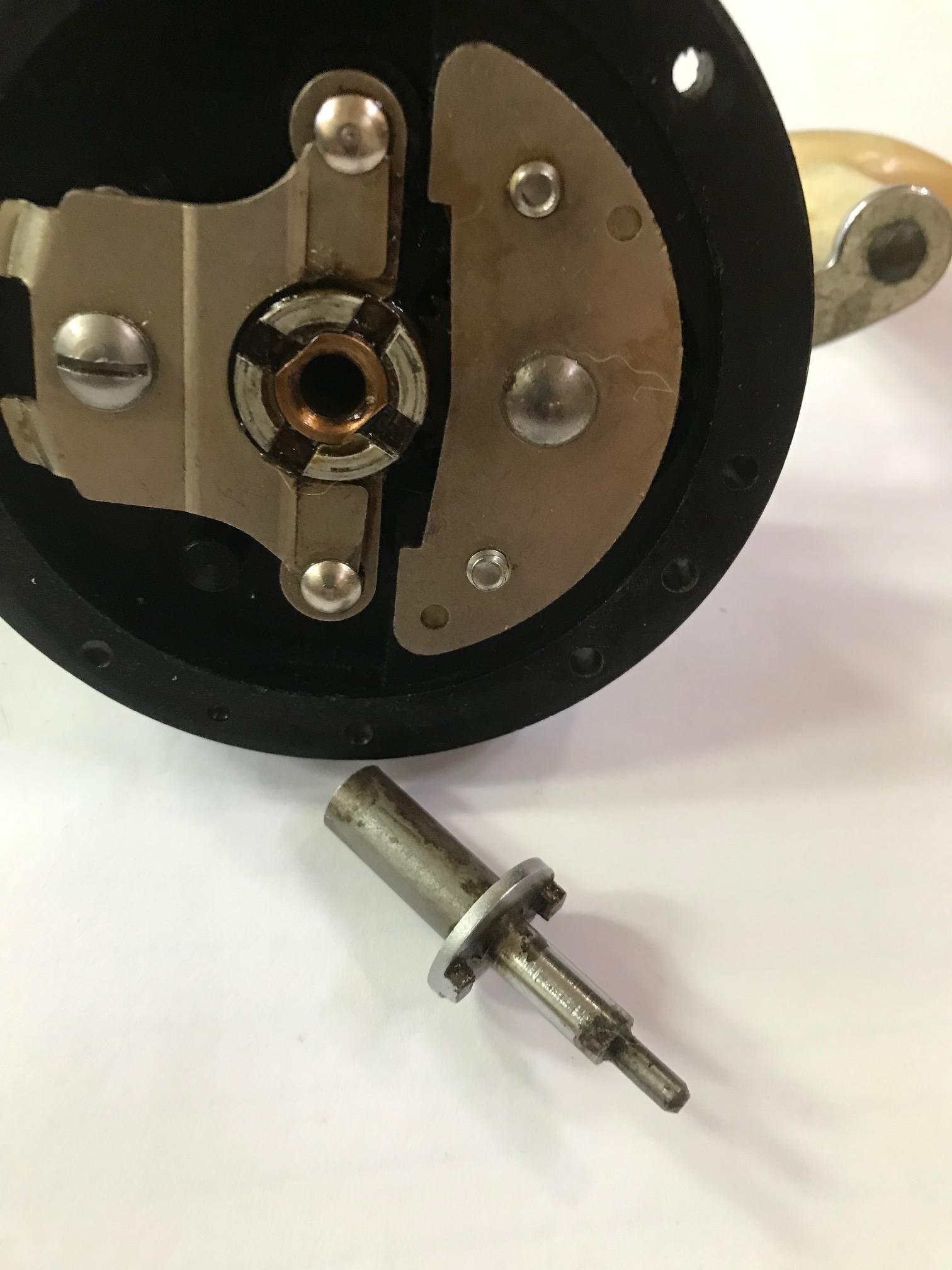

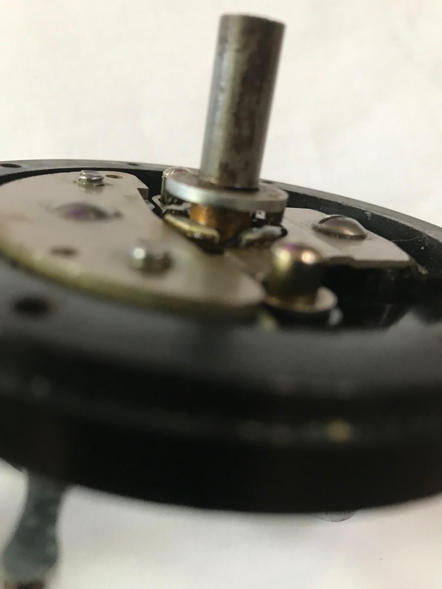

If the jack tabs do not disengage fully from the yoke, those ramps on the tab will put angular load on the the yoke, which will put angular load on the pinion which might wedge it a bit on the spool shaft.  That bit of misalignment would cause some rubbing.
I would compare the stock to  aftermarket jack and yoke and see if there is any differences (part thickness, tab angles, etc.)
I've had some where they worked perfectly right out of the gate, others not so much. The yoke and jack we're normally the culprit
JasonGotaProblem
Quote from: oldmanjoe on October 05, 2023, 10:57:48 PMI see birds nests .  :d
I don't need a minute of freespool to get birdnests. And i think the problem was the jack. I'll get out the caliper and find out which dimension is different but it was getting late I just wanted to put it together. There's some axial play in the handle, and it seems to bind just a bit, so im going back in anyway, it ain't done yet. Dave described the original problem very succinctly.
Steve, perfectly on topic. I think the issue is its a Cortez one piece body with a PC gear set and spool, no idea who made the bridge, or the yoke and jack. We could be talking 3-5 different part makers in here, not including the penn bits. I bet any of them would probably work just fine with penn parts or installed into an otherwise stock penn reel, because that's what they were all quite independently designed to fit with. They aren't necessarily designed to fit with each other.
#20
  The easiest thing to check is the yokes . put one on top of the other ,and look for shadows .  Hole spread ,the hole diameters and pinion cut out .  No shift in the cut out .    The jack is going to need caliper checking !!!
