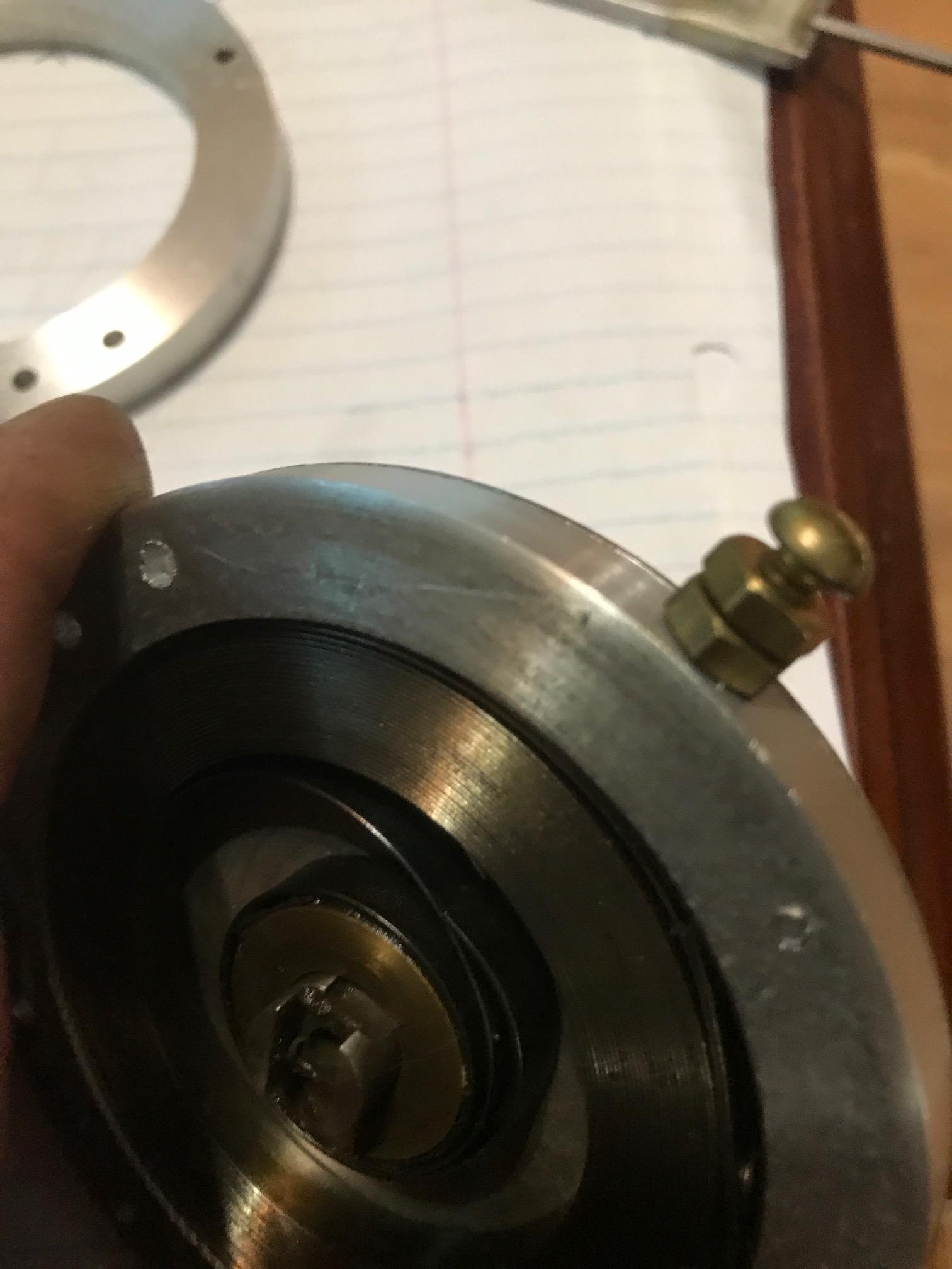

    So now I stripped the line off the spool to start the clean up and take a peek at the workings of the reel , more so the spring deal .  When I saw this , it looks like the spring is broken .

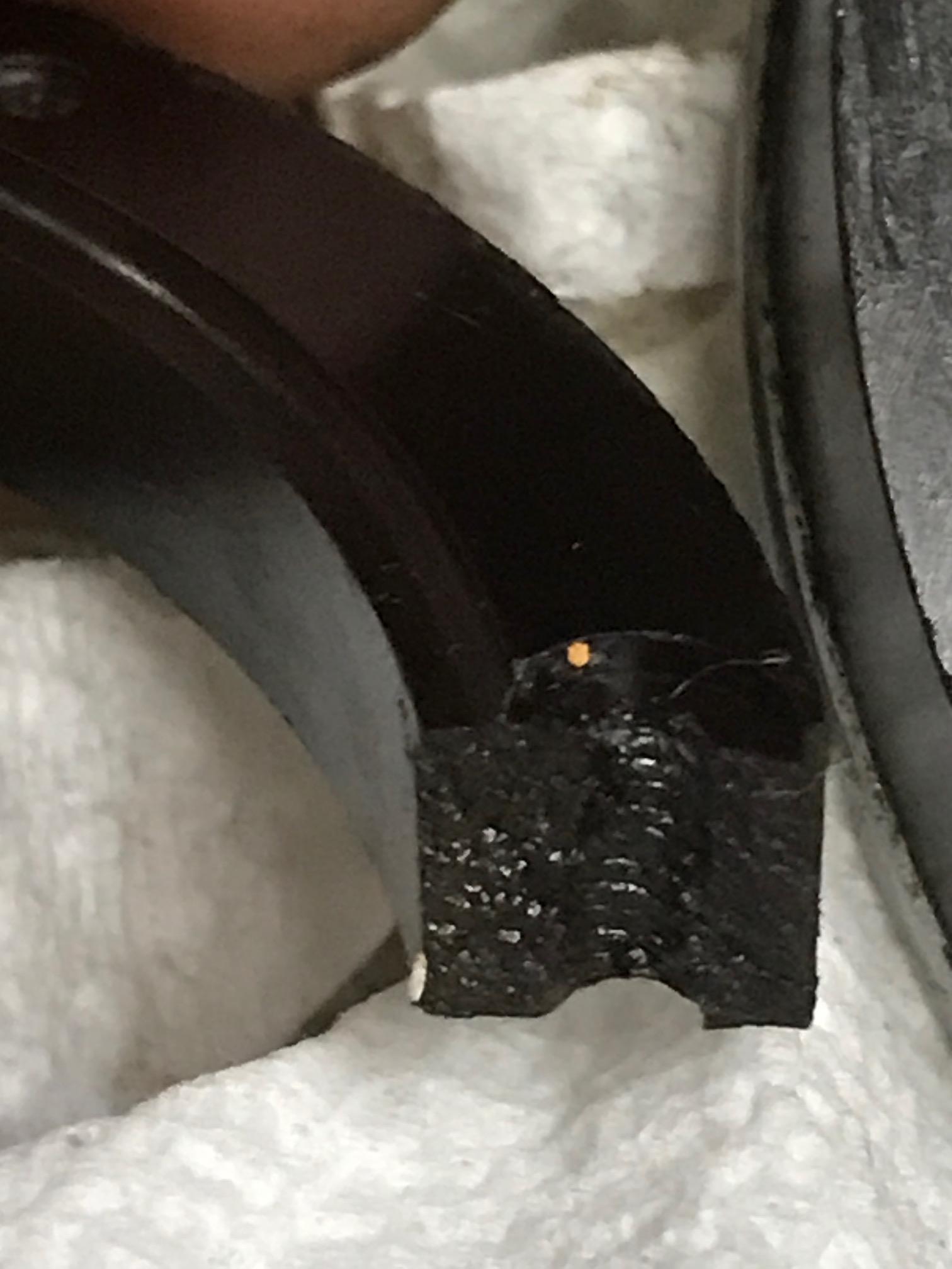

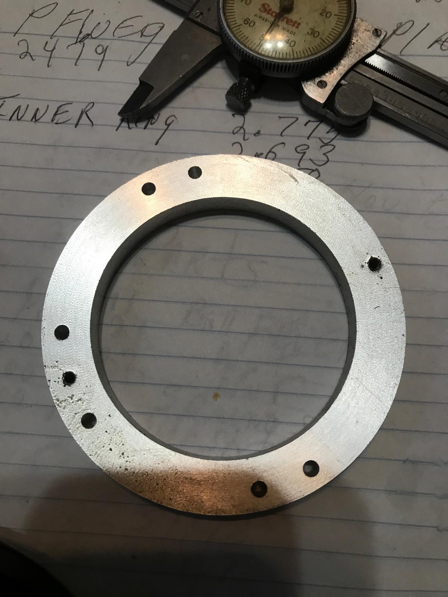

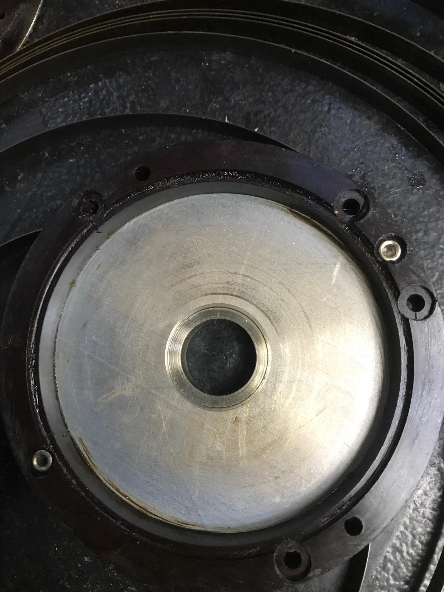

   Both reels have cracked spacer rings
 One had two cracks were as a piece came off .

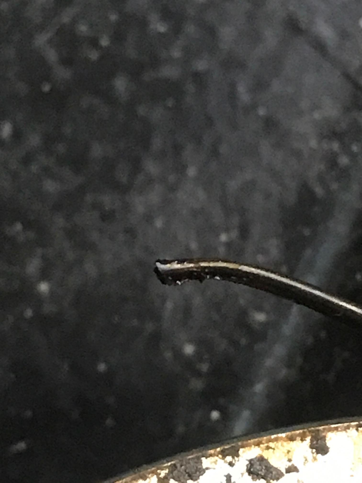

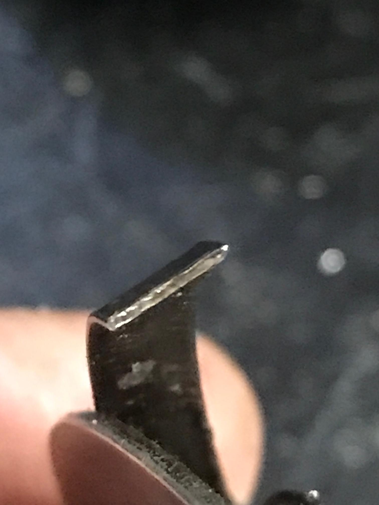

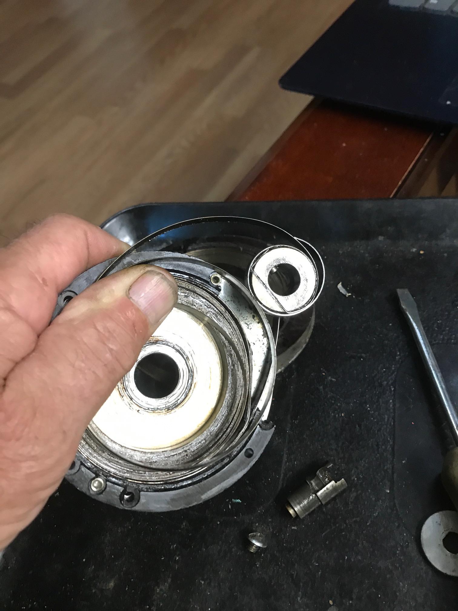

    With this piece removed it made a window to look at the spring .  I turned the thumb wheel until the tail of the spring popped up in the window .
   Now I can see it does not look broken , and it looks like the end is bent down a little

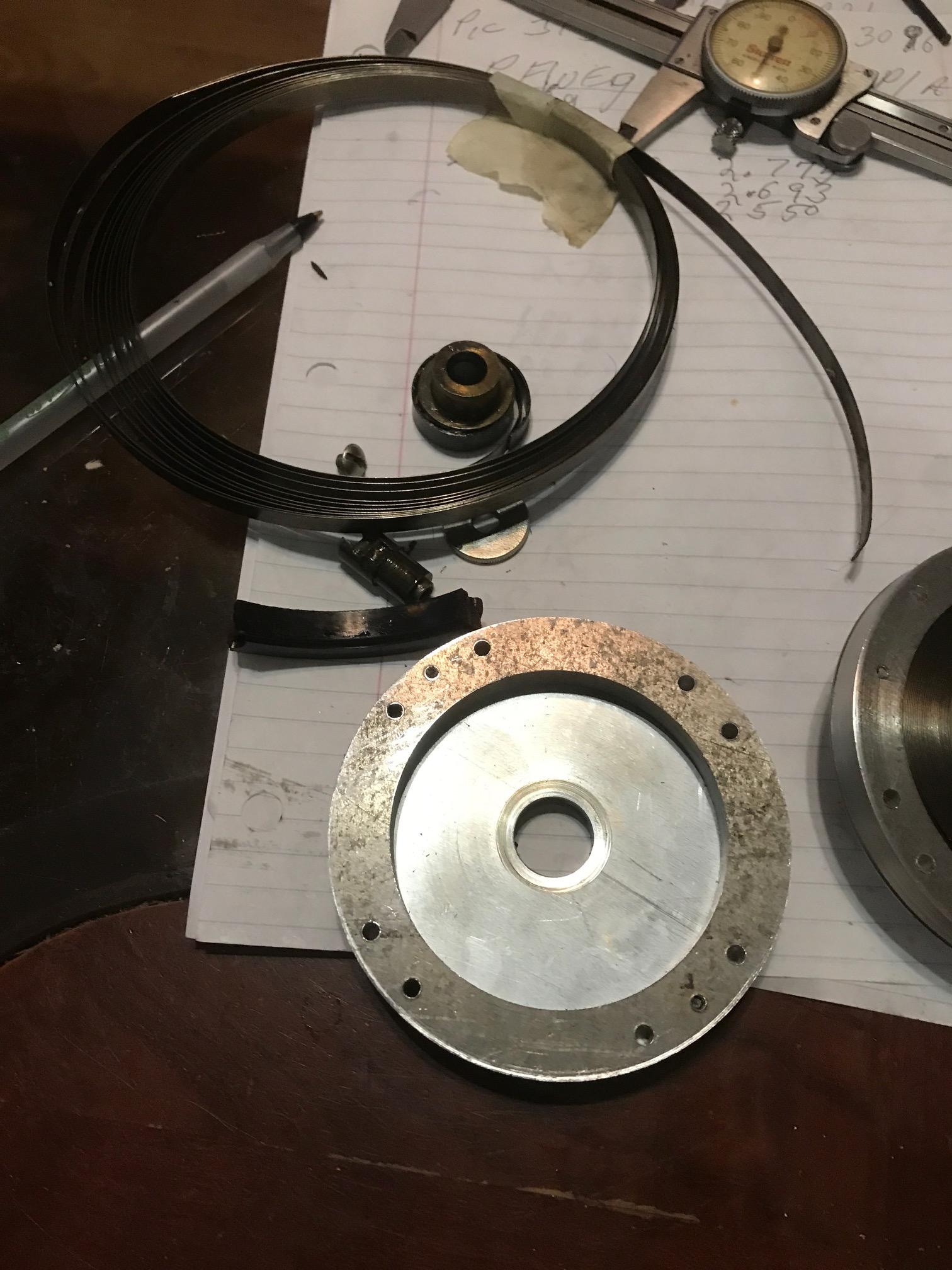

     So now I think that the spring is not locked to the spacer ring in any way and that is why the spring skipps .   At this point I removed the spring .
   I can look at the spacer ring and see no place were the spring can be anchored .
This now tells me that the spring can not be broken no matter how much line is pulled from the reel , it is more like a lite drag with a little take up for a small fight .

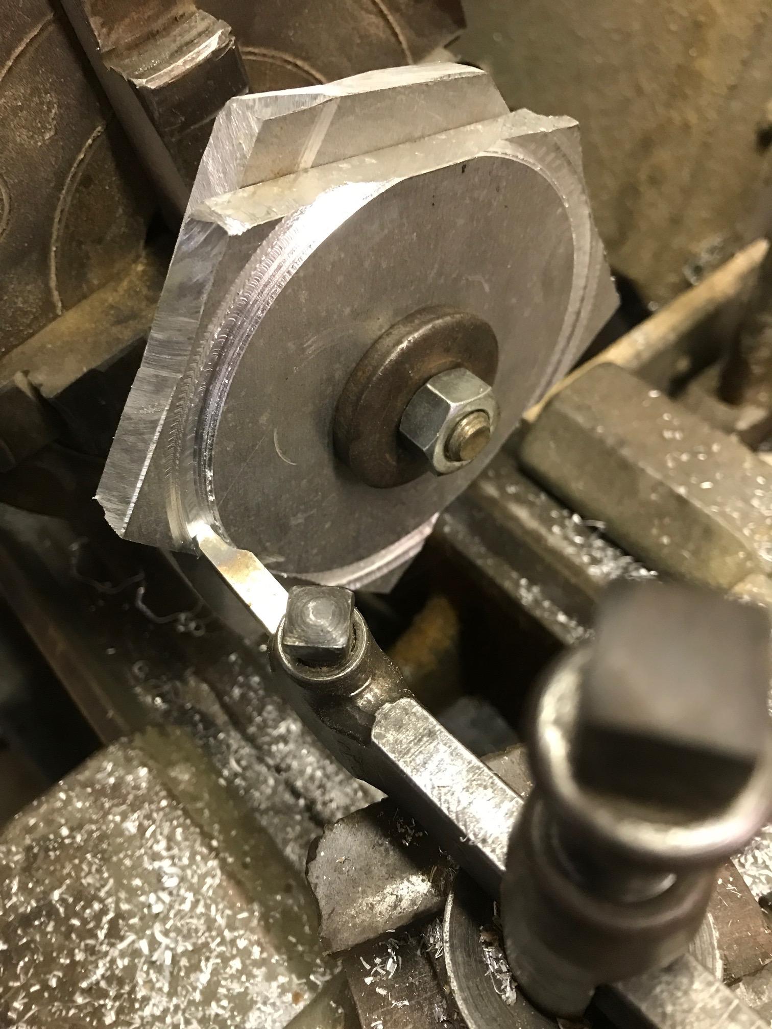

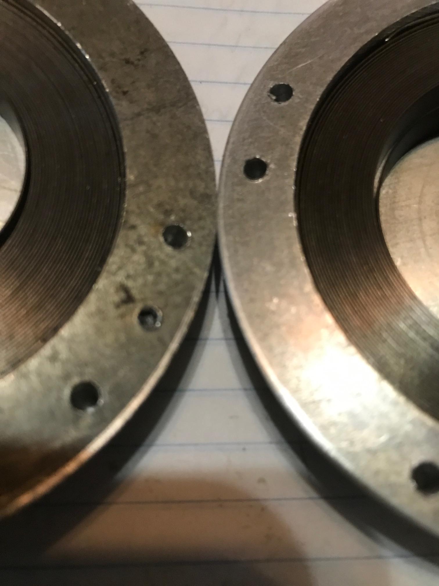

     I made two rings to replace the cracked ones , and I did changed them a little to start with .
I have some testing to do to find if the theories work .
I will load pictures in the drop box so you can blow them up .
